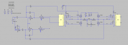

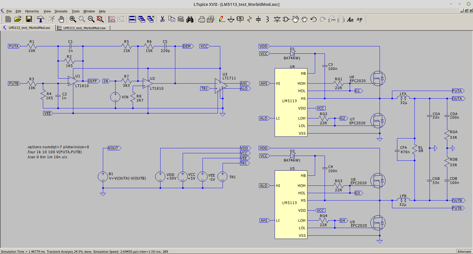

I'm experimenting with a three-level PWM class D design with GAN Fets for a school project. The current simulation uses the LM5113 driver which has no dead time control, however my final design will use PE29102 or the new LMG1210 (These drivers don't have LTspice models so the LM5113 will do for now).
I'm running in to some problems with higher frequencies. The simulation shows sub 0.1% thd at 1kHz, 1.4V but as the frequency increases, the output attenuates.
E.g at 10kHz, Vout = 10V amplitude, at 15kHz, Vout = 3V amplitude etc.
Is it obvious to anyone what the cause of this is? I assume it has to do with the gain of the integrator or possibly the output filter but i'm not sure after a bunch of testing. I'll attach the spice files.

Given you have VCC and VCC-, try using VCC and VEE as the labels. It's more conventional, and your ICs can handle +/-5V forget about trying to use Vref to bias things. Make your triangle wave +/-2.5V. You have not supplied the high side drive supply, HB. It needs a diode. Check the LM5113 data sheet.
Your triangle swings 5V in 1.25uS dV/dT= 4E6V/S. Use 100pF capacitors in your integrators. To get 4E6V/S at the output you need to drive a current of 400uA. With your 30V bridge supply that makes the feedback resistors 75K... you don't want to overcook things so use your 100K ones. BTW, its called Slope Matching. Peak ramp of the error amplifier output should not exceed the triangle ramp. If it does things will try to switch at really high frequencies. Have a think about that one. You will notice that using the above the zero output error amplifier triangle will/should be half the amplitude of your reference triangle. Bandwidth works out to be Fs/PI.

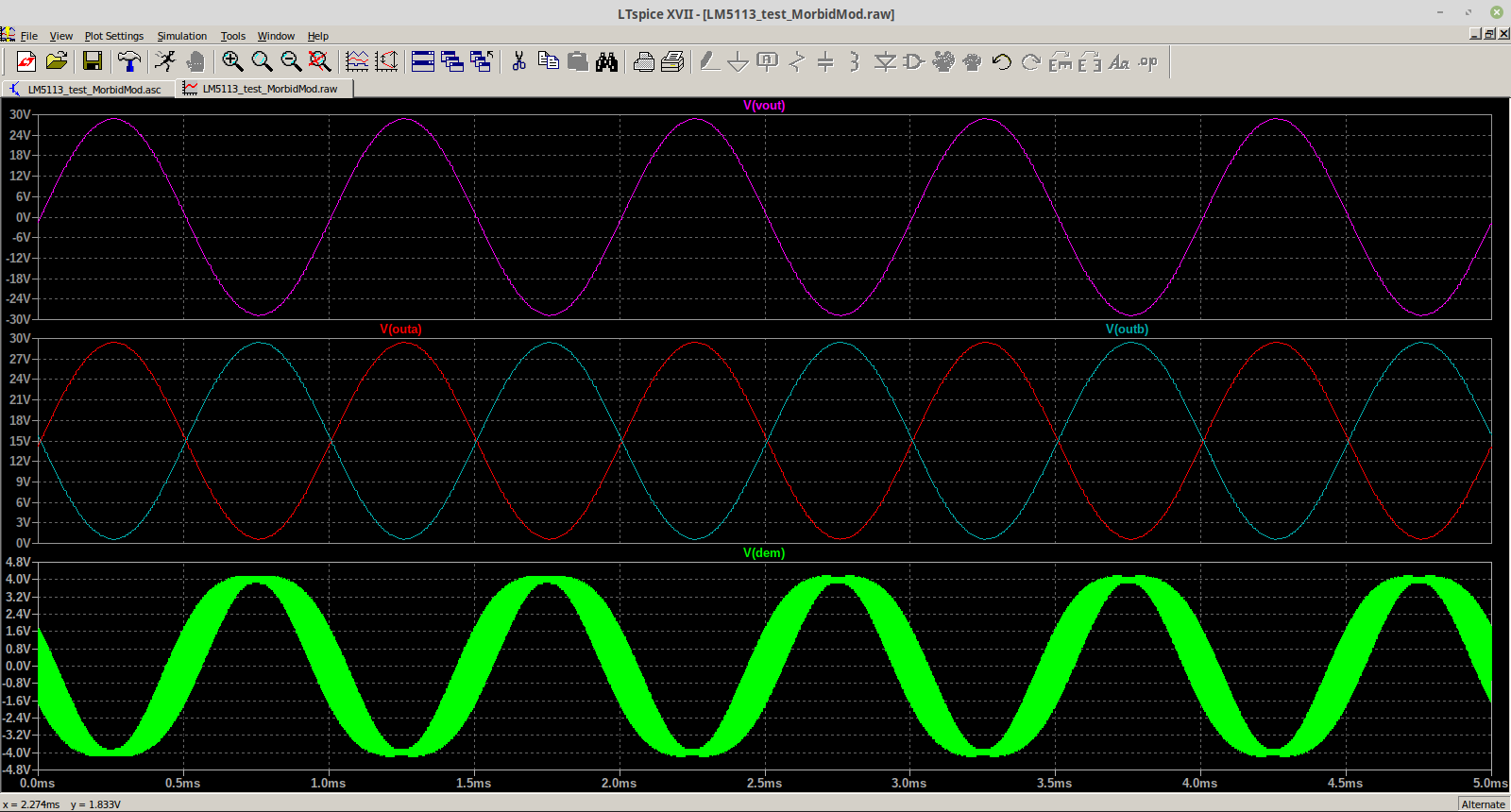

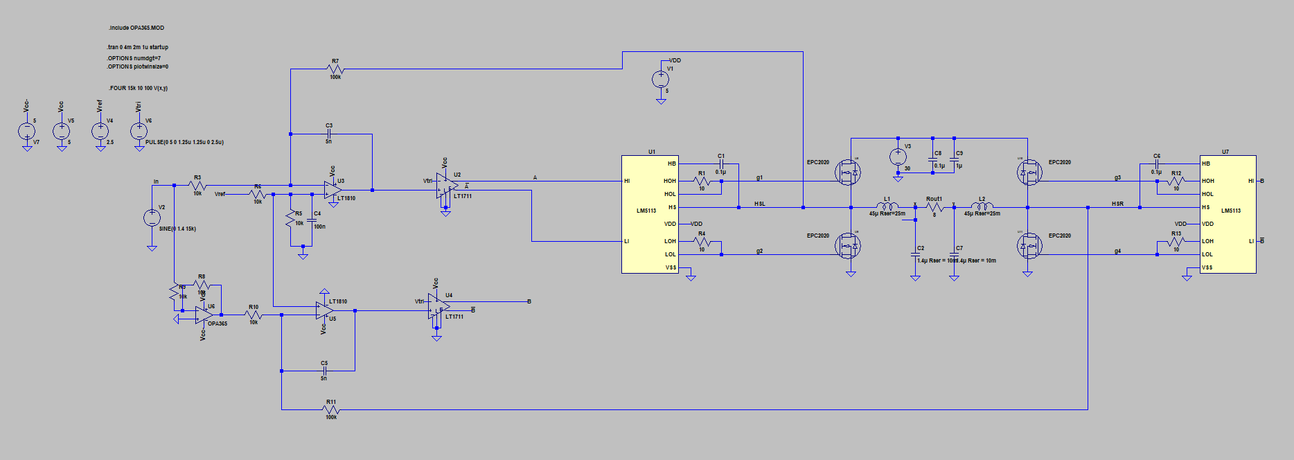

Thanks for the advice, I've updated the schematic with your suggestions but the integrator output seems to saturate at -5V and attempt to follow the input for the top half of the signal. I'll attach the new files again, hopefully you can open them.

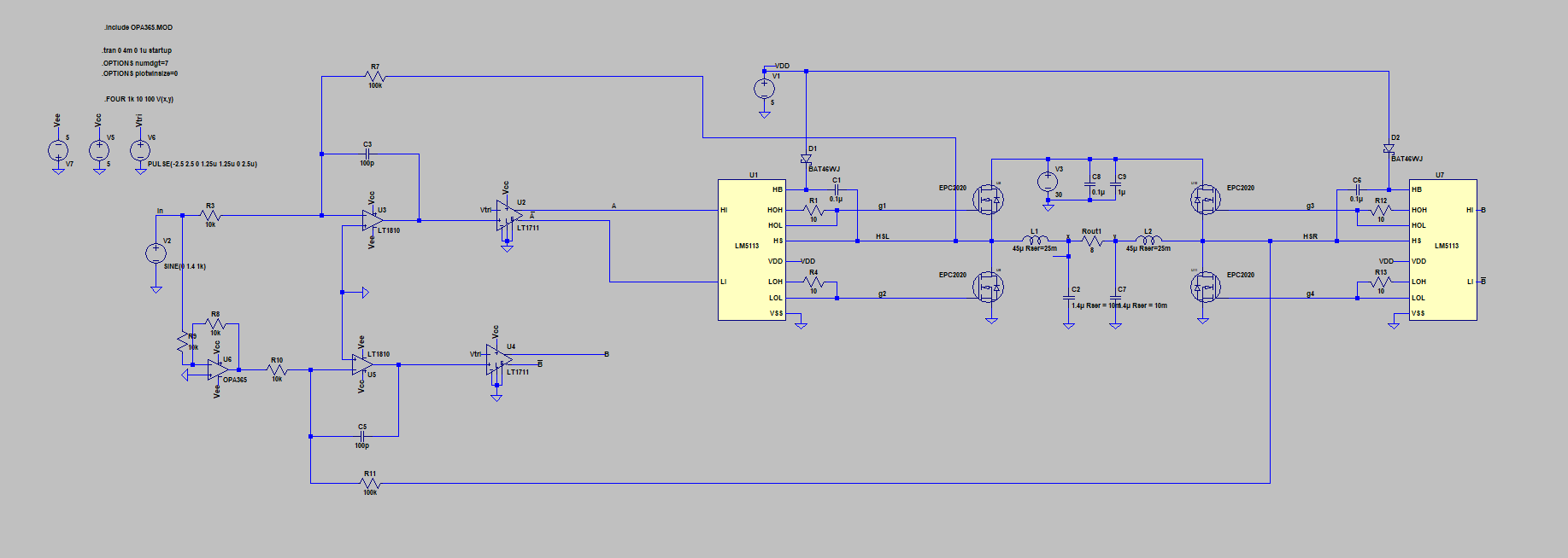

Oooops. Sorry. Too much alcohol. Something like the attached.
I've messed about with stuff. Bigger gate resistors on your driver ICs to tame cross-conduction and other bits. I guess the big one was using lower value resistors, bigger integrating capacitors, for the feedback.
You really need to think about the required bandwidth of the various amplifiers and input offset voltages and bias currents. If you don't then you end up with overall output offset voltages robbing you of available output and paying too much money.
Some other bits have changed. Mainly operating levels and also the output filter. Don't quote me on that one. It's a guess at 40KHz cut off for an 8R load.
Obviously I dicked about with things until they worked. You can have a poke about and do some sums to see if it might make sense. Bricks it at 20KHz... I was surprised.

Ah, thanks for that. I assumed a differential amplifier would be the best option with a single integrator. Is there any reason you have the resistor in series with the cap in the integrator?

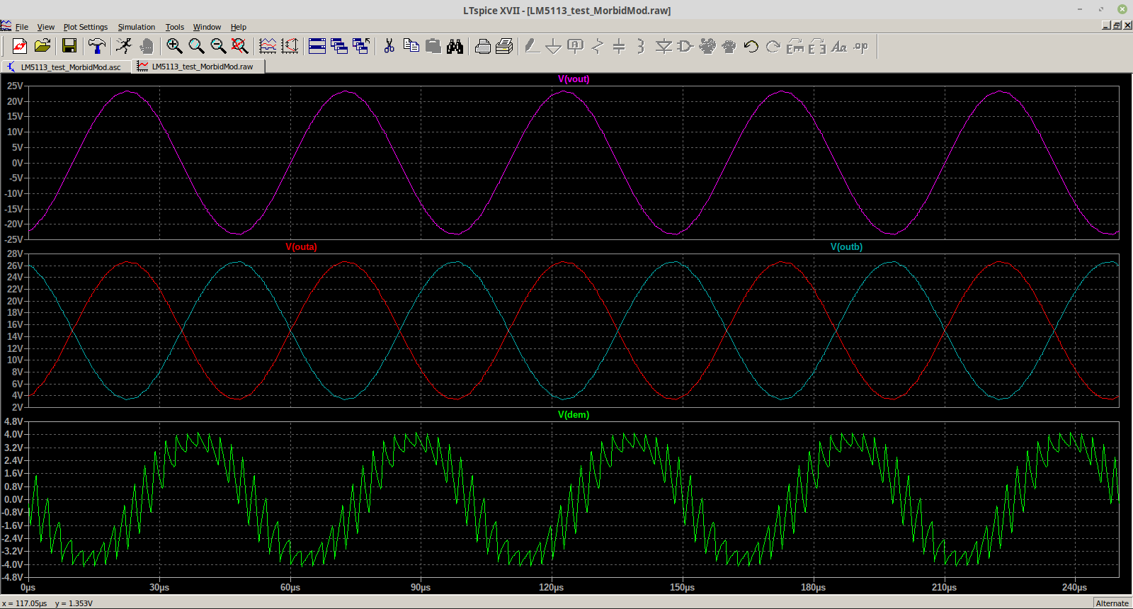

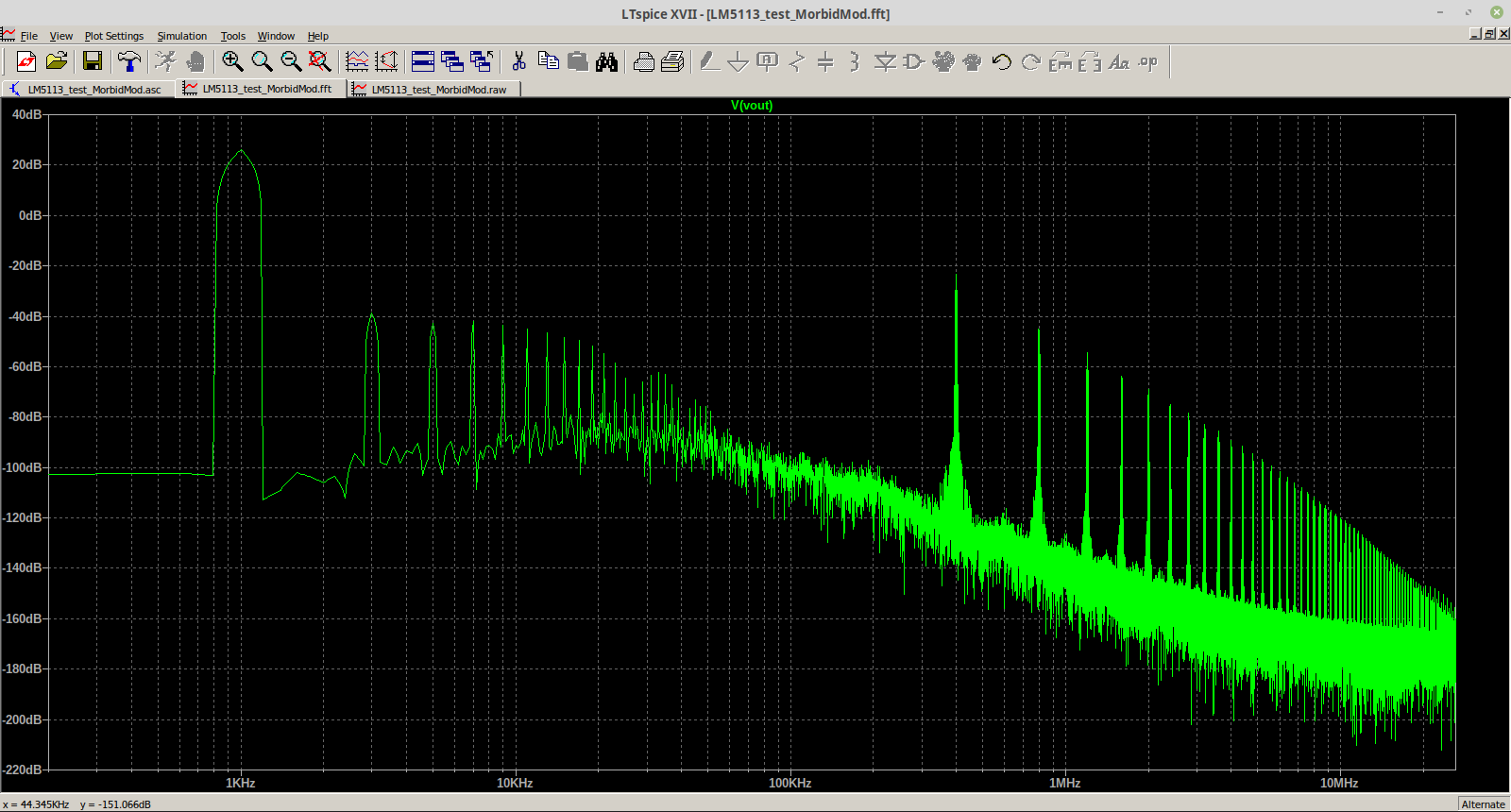

I tweaked some things and added three level modulation and it's running at less than 0.1% thd through the audio band.
Thanks for the advice about the opamps, I'll have a look into it.
U1 is the, main, integrator and differential amplifier combined. The resistors place the nominal 15V per leg output of the bridge down at about 2V within the supply range of U1. The capacitors convert the square waves to a triangle wave.
U2 lets you adjust the resulting triangle amplitude to match your clock triangle and set the input to output gain. You also get to add C5 increasing the low frequency gain. It is not the main integrator you just kind of get it for free but you have to worry about loop stability problems if you use it.
