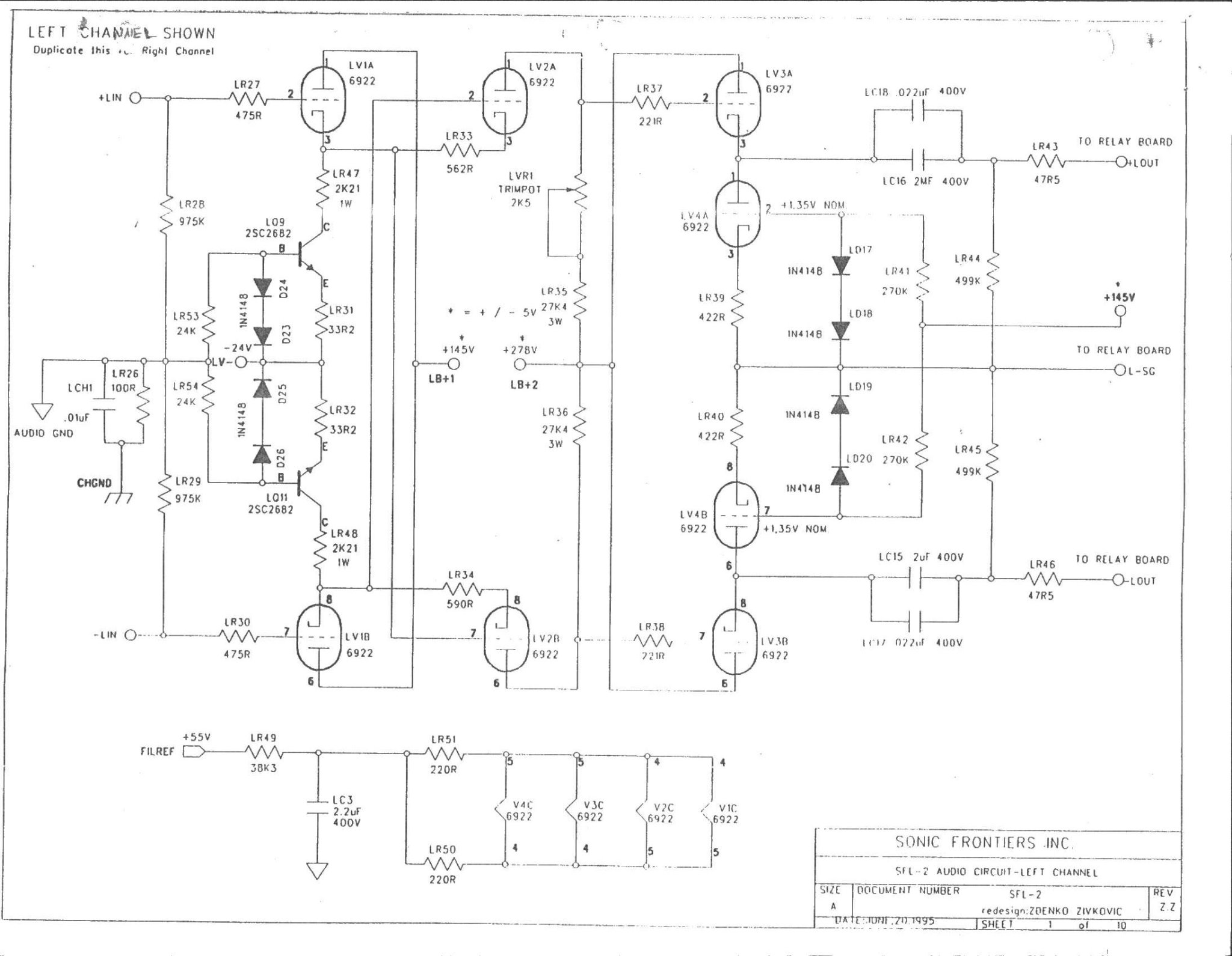

The original circuit diagram shown above seems to state 2.2uf being used but on production models I've only ever seen 3uf used. I would presume sonic frontiers decided to use 3uf on the final production.
You will often see running production changes. Part availability is one factor, and this is not a critical value at all.

Is this the same type as larger one?MR 21 0.22 bypass under the board
No it's a much smaller cap and still a multi cap but possibly a higher specification. personally I haven't seen it but I know it's there sitting under the board. possibly a multicap ppmfx or RTX im not sure.
It's just another small capacitor.
Think of dropping a big rock. Then adding (gluing) a small rock to it and dropping it again. Ask someone what difference there is. The characteristics of the larger capacitor will dominate, even if the two are vastly different (as long as the smaller one isn't completely terrible, or a short).
We use smaller capacitor in parallel in power supplies to address high frequency impedance. We are talking RF frequencies and it is for circuit stability. This concept does not hold for audio frequency coupling capacitors. Also look at the impedance levels of the two circuits.

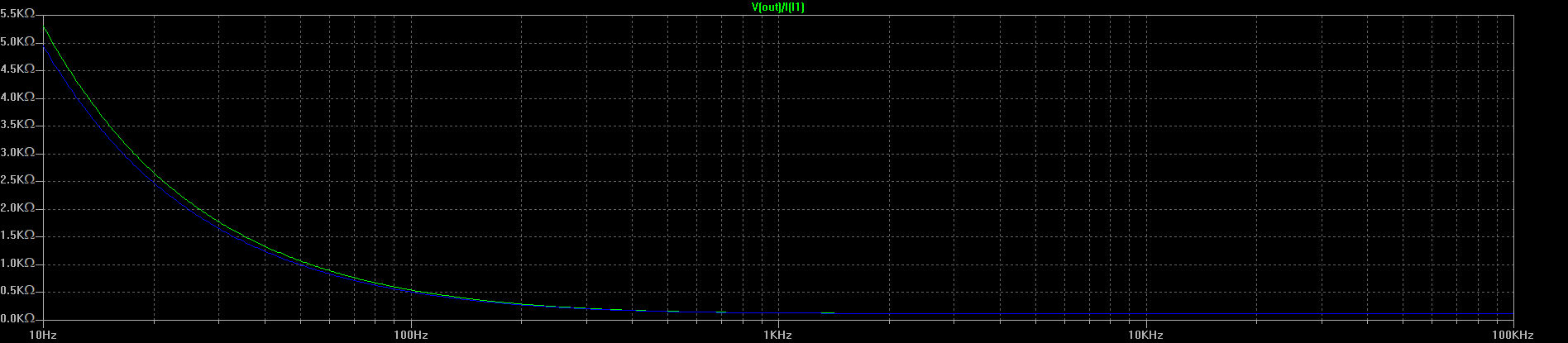

As can you see, the -simulated- output impedance (and FR behaviour too) of SFL-2 with 3uF or 3u22 (fixed ESR values with frequency change) almost identical (with infinitive capacitance it's 120R), so the designer use this 0.22uF for other purposes.
Usually use this technique to decrease (and possibly hold steady) output impedance (with better, and lower ESR smaller value capacitor) when with increasing frequency the "larger" capacitor ESR grooving.
