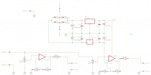

I bought this amplifier on ebay and wanted to build a preamp to play it but I was wondering between a voltage follower and a preamp with a gain and some caps.

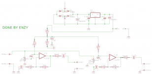

I have uploaded both types of preamps my aim is to get max power out of the amplifier and the least amount of distortion.

I want to have ythe ability to control the volume of an amplifier which circuit would work best just the normal voltage follower or the other preamp.

With 33dB of amplifier gain, just a 10k volume pot would be fine.
It only needs less than a volt for full output.

I do not think you will need any gain. I use Nelson Pass' B1 v2. Easy to build, few parts. Be sure you build the version 2 if you decide on a buffer. Nothing wrong with a op amp buffer but J-fet is much better. IMHO and I have built many op amp buffers.
Of course, you have omitted important data: what will you drive it with?
If your music source provides more than 1V RMS output, just a pot will do, as suggested above; if less you´ll need some gain.
In any case , way less than what your examples show, the first one having 11X gain, the second one some 34X .

At the output of the circuit there is a 1uf capacitor and the 100k pot which makes a high pass filter if I changed the pot to 10k wouldnt that block certain frequencies? Also what would be the advantage of using a 10k pot instead of 100k?

So what if my signal source puts out 1v RMS you said I wouldn't need any Gian so I would only use a pot, but wouldn't I need to turn the pot all the way clock wise to get full power?
If that's correct wouldn't it be better to have gain especially for songs that have low levels so that I can turn up, also isn't it the norm to have the volume pot at about half for full power without clipping?

The pot value is a tradeoff between coupling capacitor size and high frequency roll off.
The 100k pot may work well in your case.

Why does one of your schematics use a dual supply, and the other a single. You're concerned about the 1ufd cap in the second one being a high pass filter. Why not use the dual supply and eliminate the cap altogether. Also as mentioned, your second schematic has way too much gain. You're almost into phono preamp territory. Your first schematic is not a voltage follower, it has gain too.
One more thing. The 24VAC is going to cause your regulators to get very hot. Your almost at the max for input voltage. Use an 18V CT transformer.
Im in practice now, I was getting aid from people of different beliefs so one was with a dual polarity concept and one was against it.
But I'll work with the dual polarity version and u added gain because in my mind I just think at some point I'll need gain but I didn't want to affect the signal in any way that's the reason I prefer that version using no caps.
