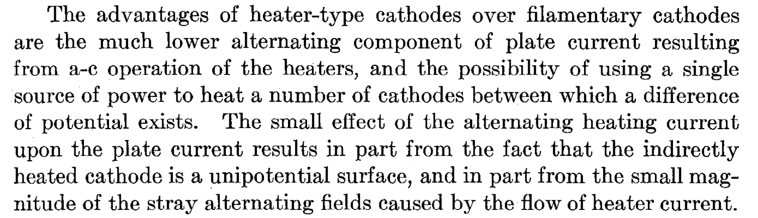

No ions in a rectifier, unless it's a gas rectifier. The magnetic force is minimal compared to the electrostatic force from the anode-cathode voltage (also constantly changing), and would have little effect on the current waveform (though it may effect where electrons hit the anode). The path of the electron makes no difference - it hits the anode, a single piece of metal. The current waveform is mostly controlled by the capacitor or choke in the ripple filter.
This is not an issue in most unipotential cathode tubes. Herbert Reich (1) has this to say on the subject...
In short, the electric potentials filed between the cathode and plate dominate the electron path. Variations due to any stray magnetic field which may extend beyond the cathode surface is handled with electrode geometry (i.e. things like cylindrical plates) and structures like beam forming plates. Improvements in overall noise level due to DC heater power (within the tube) is generally far below the audible level.
(1) Reich, Herbert J, “Theory and Applications of Electron Tubes”, 2nd Ed., McGraw-Hill, 1944

For receiving tubes, the most noticeable 'improvement' related to AC heater filaments was the introduction of a double helix filament for indirectly heated valves in the early 1950's to suppress any noticeable influence of heater's magnetic field on tube operation for sensitive 12AX7 and EF86 type tubes used in low noise/hum amplifier applications.
