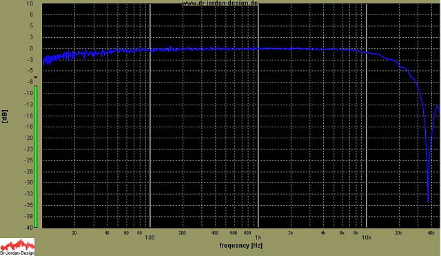

A 1628SE is flat beyond 20k, and it is 5"x5" and weighs 11lbs!
Yours might be flat, but my pair isn't.
