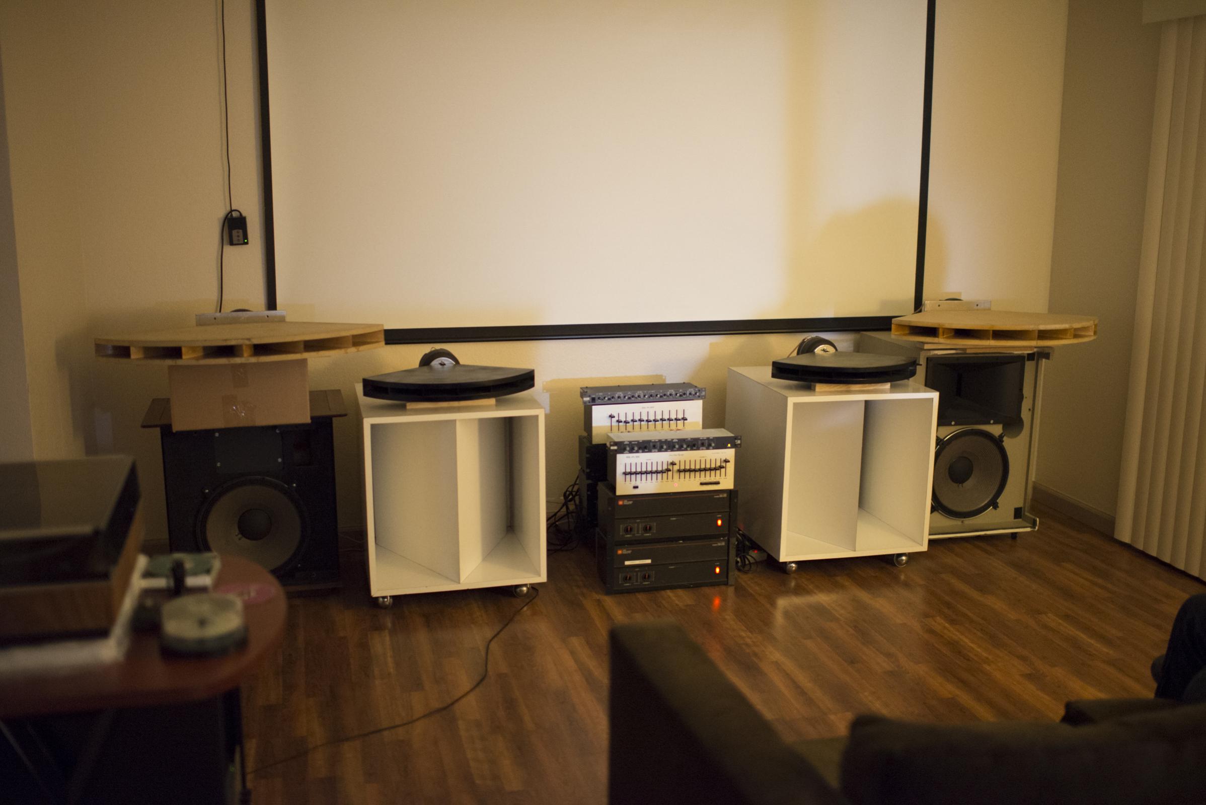

For size reference only, these were unfinished prototypes. You can judge the size vs the regular Smith horns on the inner pair of speakers. And I think at this point, he had Be on one horn and Ti on the other - still in the dialing it in phase.

Looking at the pic to link Les found, those look like 90 degree? Smiths proper are 120 degree right?

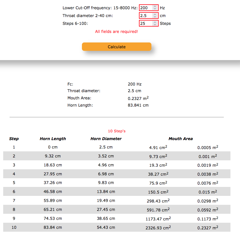

If you simply want dimensions, this calculator will do it for exponential horns:
Calculate Back Loaded Exponential Horn
The throat area will affect the length required, for instance a 5cm (2") diameter throat 200Hz Fc (cutoff frequency) horn would be 65cm long with a 54 cm diameter mouth, while using a 2.5" (1") throat would increase the length to 84cm.

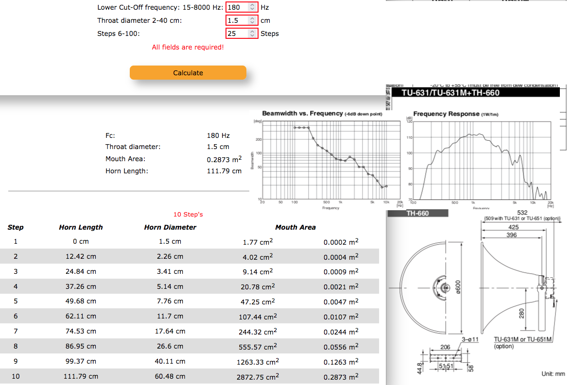

That said, using a compression driver, the response at Fc will likely be 20 (or more) dB down from the mid-band, as can be seen in the 180Hz Fc triple folded (re-entrant) TH-660 horn using the TOA TU-631 thread on driver.

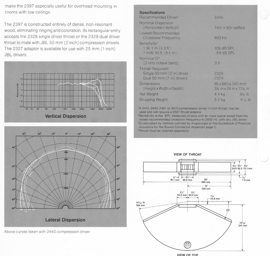

A "375 Hz" DSH (distributed source horn) should be crossed over about an octave higher than Fc.
The JBL 2397 Smith horn using throat adapters for 1" or 2" recommends 800 Hz as the lowest crossover.
