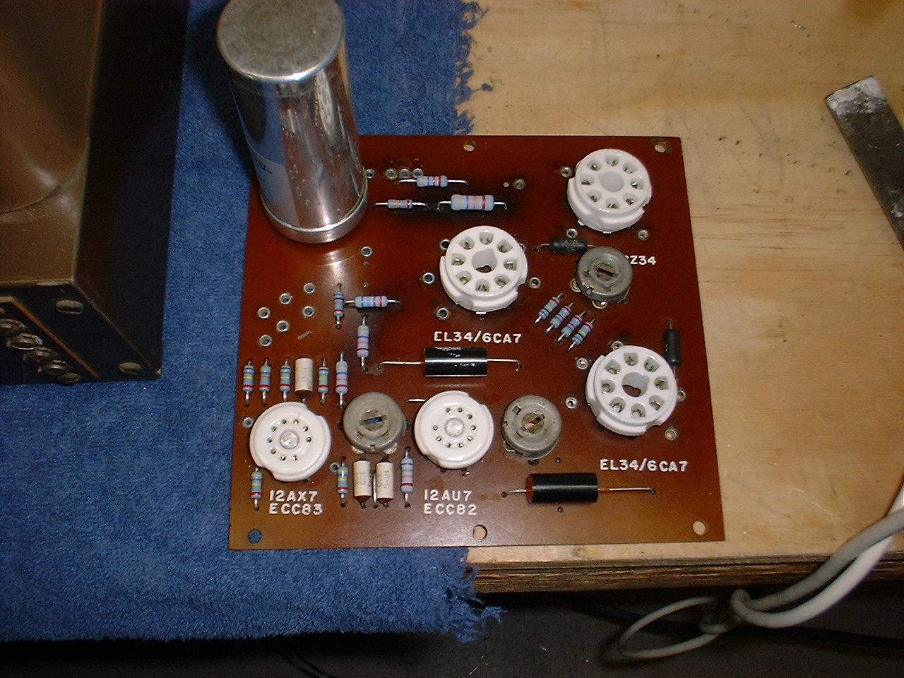

I happen to have a pair of Acrosound ULII that I restored about 10 years ago. They were complete and in good mechanical and cosmetic shape. I pulled the boards, cleaned them up and replaced all the parts with new modern parts. All the power supply caps were replaced. The only original parts left are the 3 board mounted potentiometers.
Along the way I decided that I did not like the printed circuit board mounted output tubes, but worse, those EL-34’s are running at a B+ greater than the tube is spec’d at. At least that’s my understanding. And 60 watts out of a pair of EL-34’s? Yikes, can that be for real?

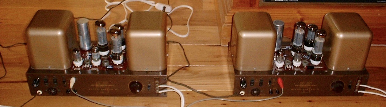

What the heck, a few pics of the amps in question

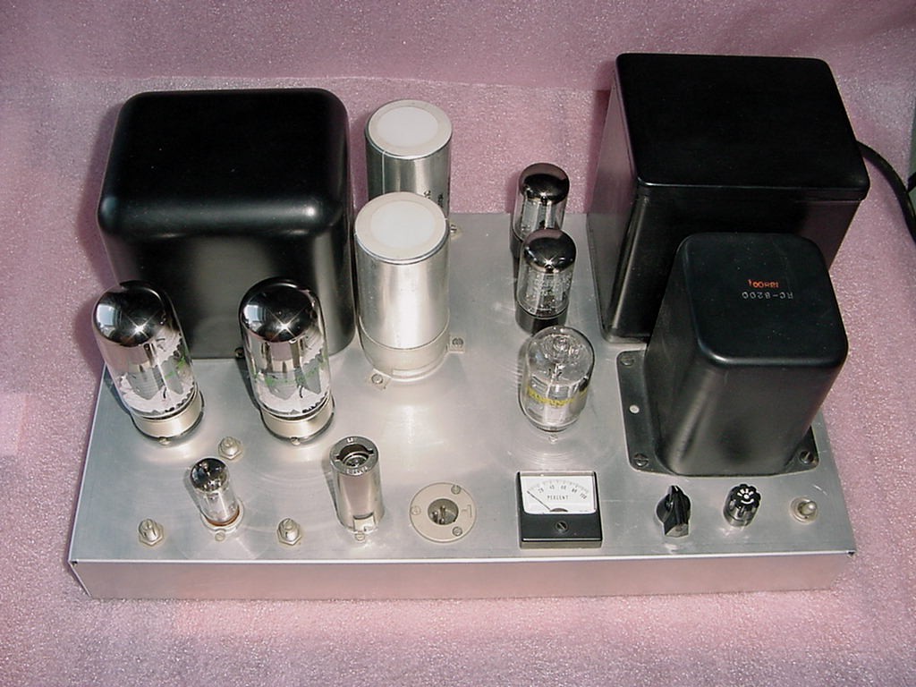

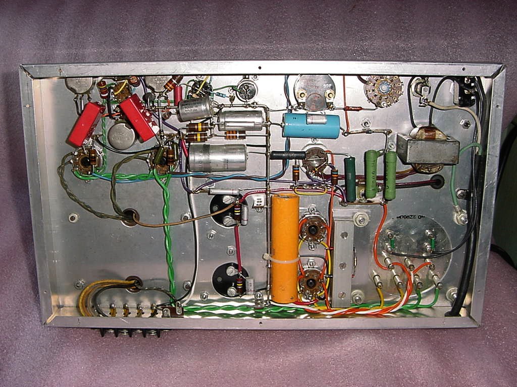

In my opinion the Acrosound UL-II is an excellent amplifier. The design is simple and well balanced along with an innovative output transformer, the TO-600. This transformer uses a separate winding of copper ribbon tape for feedback which claims to eliminate most loading effects as well an improvement in overall performance. It's designer, Herbert Keroes, published an interesting article in the September 1958 issue of Audio Magazine about the design.
Back in the early eighties vintage tube amplifiers were easier to find at flea markets and newspaper ads then today. And they were a lot less money too. That's when I found several and decided to rebuild a pair on my own chassis. Actually all I did use was the OPT. The basic circuit was retained (almost) coupled with a stronger power supply. Then at some point I wanted to try full pentode operation with regulated screens. That's what the 6LR8 is for. But latter on I went back to partial triode (UL) because I felt the grass was greener in the middle. Now the preamp and driver stages still have the regulation even though they really don't need it.

The major concern with these amplifiers in my recollection was heat, ventilation is critical, those boards look like the amplifier was well cared for and adequately ventilated. You've replaced the sockets which often become intermittent and all of the passives in a manner that looks careful, and highly professional.
The pots are often an area of difficulty again usually because of the way the amps are stored or allowed to run excessively warm.
The design is good, performance to a significant extent is influenced by the quality of the passive components used.
I didn't find them the last word in resolution or anything else, but for the time certainly represented the better end of the spectrum and even today you'd have to spend quite a lot to better them.
