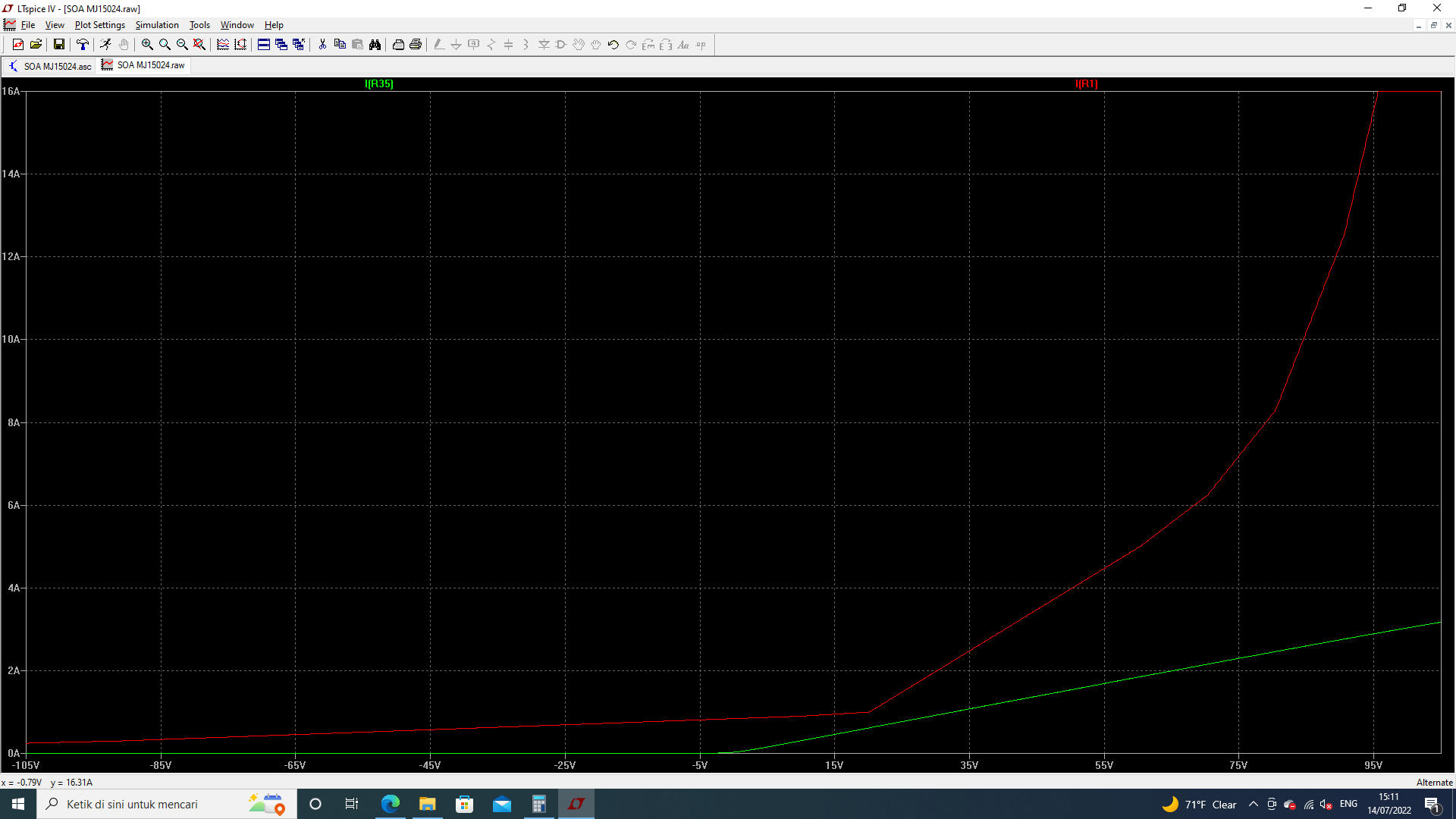

This is load line (GREEN) of 8 pair of MJ15024 with 110VDC and load of 4 ohm resistive.
The RED line is SOA of MJ15024 at DC.
