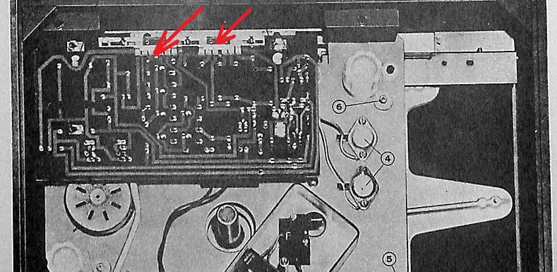

This circuit has germanium power transistors. These are not as reliable as silicon devices.
It looks like most of the components are unique to each speed. C4 250uF is the 16 Hz phase shifter and is a suspect.
Another suspect is the reference lamp. Is the bulb measuring between 100 and 200 ohm cold? If this goes high the voltage level will reduce

I have repaired many of these turntables and if most (but not all) problems are related to the electronic drive board I had a few motor issues too. (about 5%) When you're stuck (and it looks Json has some experience and already ruled out all the common electronic faults) you should consider a defective motor. (bad news,as replacement units are hard to find)
If you have access to a (dual trace) oscilloscope this is very easy to ascertain: monitor the two motor drive signals and check if
1) They have the correct amplitude,as described in the service manual
2) Have a quadrature (90°) phase relationship.
3) Have a perfectly sinusoidal shape (very important)
If all the 3 above criteria are met you can exclude the electronic drive (= defective motor), if not more troubleshooting in the electronic circuit is needed.
I think that if the two windings have similar dc resistance and that the shaft runs smoothly in the bearings, that the motor is OK. This is a synchronous motor, so there are no brushes to wear out. According to the manual, the bearings could need lubrication

But I have a TD125 Mk I which exhibits the same symptoms as Json. Was the problem ever resolved?
Unknown since the OP never posted again after my final comment.
I no longer own any 125s and have forgotten most of what I knew about this table so I would recommend just to read through the whole thread.
Checking to make sure the amplitude and phase relationship of the voltages fed to the motor windings are correct is an important first step.
