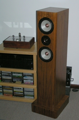

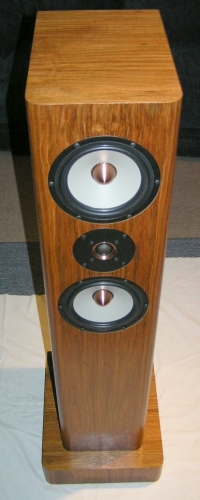

Some feedback on my completed Thor's.
I 1st connected them to my "Claus Byrith Mullard 4-30" valve amps, which are my primary "music listening system", driven by Rotel RCD-02. Well.... some things are just not ment to be 🙁
This marriage did not last long. It was like the speaker was covered with a thick woolen blanket - plain awful.
So I switched them over to my HT system (Denon AVR-1804 + DVD-2200) with not much hope or any high expectations. This junction delivered a much better result, but still not quit what I hoped for when I started the project. Since these drivers are still very fresh, I believe some "burning in" will improve the situation. There are some signs of the familiar TL bass and the Milleniums do show some good characteristics, but I pray that time will reveal a much better picture.
So, here are some nice pictures at least 😉

Sorry to hear that cause they look AMAZING!!

Beautiful work JDev!

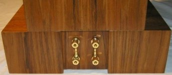

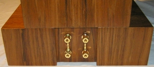

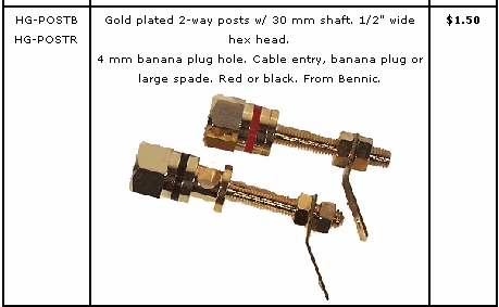

What brand of terminals are they btw?

I used the origenal x-over with Mills, Hovland, Solen and Goertz components, Acustuff measured to exact quantities as specified. Terminals are from Madisound, not sure what brand (see pic)
