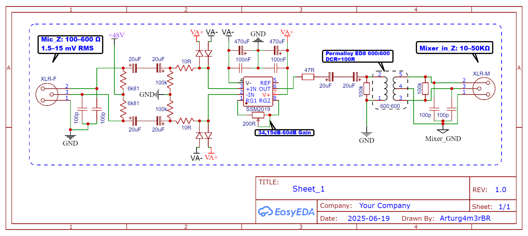

This isolated Preamp could work well?
Hi, i'm new in those things, this circuit would work well for converting balanced or unbalanced audio from condenser mics to a fully differential balanced signal? the balanced output is meant to be plugged to a mixer or interface TRS input. the 20uF caps are solid polymer ones on anode to anode configuration to work as non-polarized, my concerns are about the SSM2019 driving the transformer, idon't know if i did everything right, i will respond to any question
