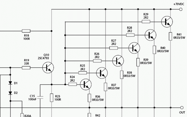

Made for Brazilian powerholic.... it is the "marriage" of the Dx Standard, Dx HRII and Dx Precision 1 amplifiers.
The idea was to use the good points of those amplifier, to use the same supply (two 27 AC transformer coils installed in series) to allow you to have simetrical 70 plus 70 volts DC.
Effort was applied not only in sonics, but in special to obtain power into 2 ohms and 1.5 ohms loads.... and i could reach 650 watts RMS, continuous, sinusoidal, undistorted (unclipped) into 1 Kilohertz and flat from 5 hertz to 100 Kilohertz... sensitivity of 750 milivolts to full power.
Into 8 ohms power is not special....only 260 watts RMS.
Supply needs 20000uf each rail, and to each amplifier if you gonna use it into 4 ohms speakers (8 amperes) ... twice of that will be needed if you decide to use lower impedance speakers.
Off set is lower than 1 milivolt and bias is around 100 miliamps (force output to conduct)... zener is 1 watt for safety reasons.
500 miliwatts of more to the bootstrapp resistances
3 watts or more to the output emitter resistances
I have assembled this one last year, into December... and i found it great....have not show to you (the early basic schematic, the one i have made modifications today)... i was silent about this one because of Precision 1..... it was under development last year(board).
Diodes must go to the heatsink...they must be insulated using thermal tubes and attached into the heatsink using glue and thermal compound into the places the diode touches the heatsink...glue goes to the resistance series extreme points.
Avoid too much long wires to this one.... despite it is not too much sensitive into those points (not a tripple darlington) it can result a problem if you use long wires...make it shortest as possible.
There's nothing absolutelly different, just a retuning and a marriage fo those amplifiers i have told you..... adjusted to produce power into lower impedance loads...just that.... reliable, good in sonics (alike HRII).... powerfull as the Precision 1 (more powerfull into low impedance loads)
To use into 4 ohms... i suggest you to use 6 pairs of transistors... will be more safe than the 4 pairs you see into the schematic...was problem of space into the simulator to draw the sketch.....of course, to use into 8 ohms only...you can use 3 pairs... and even into 4 ohms...but better to increase if you gonna plug it into crazy loads.

Carlos,
Very nice amp - highly refined, congratulations, and thank you!
I suspect the emitter resistors for the output NPNs are in the wrong place; should be under the transistors, not at the rails.
Apart from that this would be an extremely clean, dynamic amp.

I have the same comment about the resistors on the NPN outputs.. surely they should be at the emitters...
Oh, i'm also wondering why the zener-resistor arrangement for the LTP, instead of a transistor-LED or transistor-transistor based current source? Just curious - i've read so often that zeners are noisy and should be avoided at such places 🙂
Also, I'm wondering, is that VAS/47uf bootstrap & 3.3K+3.3K setup strong enough to drive the transistors into 2 ohm loads? On an amp I built similar to yours (75V rails) I used 2.2k+2.2K and 470uf bootstrap for 4 ohm loads (even though 2 ohms tested fine)
And yea, to enable current sharing, you have to use the resistors in the emitters. The gain is based from b-e voltage, not b-c, so you want emitter resistors to even out the b-e voltage and gain of all the transistors. This keeps one transistor from running hotter than the rest.
Will fix the emitter resistance mistake..sorry folks
Yes.... zener produces noises.... the capacitor there hold the job to kill those noises.

Here is the corrected schematic..sorry folks

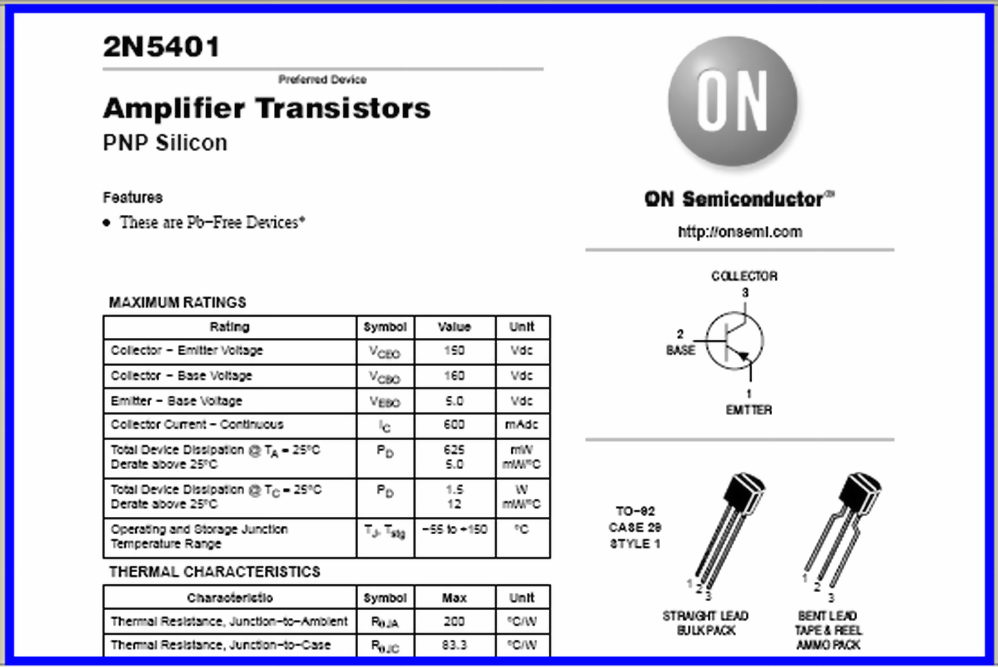

To the input... differential PNP transistors use
2N5401... voltage there will be 70 volts, and you can see this transistor can work into higher voltages.
Under those transistors the CCS, mirror or current sink (do not know exactly the name), those down ones working as coletor loads for the differential amplifier..use 2N5551 (check the number if this is really the complementary.... as in my home i use BC556 and BC546)

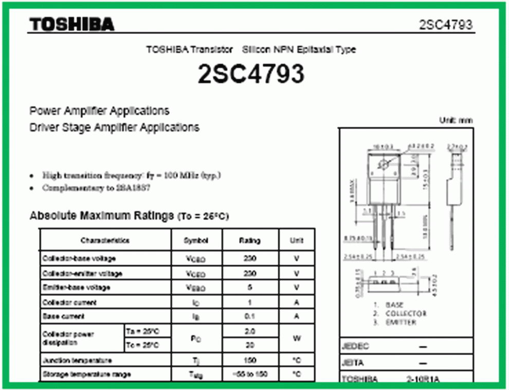

To the voltage amplifier, the small one, the NPN can be this last one written above.... the second one, the master, use a low capacitance unit able to hold 150 volts, more than 5 watts, and gain from 50 to 120.... the 2SC4793 will work there,....but there are others even better to this position, the ones have lower capacitance....you may select your own choice...voltage there will be almost rail to rail swing (maximum possible less saturations and losses)... so take care of that.... limit of voltage...also the power there is not bigger than 3 watts to select heatsink.... please, do not put this transistor into the main heatsink...not a good idea..let it into the board with a 1 1/2 square inch aluminium heatsink or another able to dissipate 3 watts continuously.
To the drivers, use those plastic ones...they are excelent, huge, reliable and do not need insulators...black plastic material (plastic because you are able to make it in many shapes, have plasticity)... they are strong to the work there, can hold the current (lower than 20 miliamps into stand by mode) and the power there... also small...but those can go to the main heatsinks if you want them there....or not!

Transistors I will be using 2sc2922/2sa1216 or 2sc5200/2sa1943, I will check both which sounds good, I will use that.
my parts bank have some stocks. 2n5401,2n5551, 2SC4793,2SA1837,BD140, BD139.
I think few from this you used in this circuit right, its easy for me to build ? This design much more easier to make then prc-1. As my exp, Prc-1 not so easy to make from design.

The unit was made to long time power delivery
and it is beeing constructed using more transistors into the output...of course.
Those output transistors into the schematic are only suggestion, and will depends on the impedance and type of job the amplifier will face...if heavy duty, over 2 ohms.... 12 pairs or more gonna be used.
Schematic made to 8 ohms and normal music reproduction that uses to be into average power levels... but for instruments, public adress or live shows, using, guitar, bass and other sources of sound... using mixer output..then we gonna need more power transistors.
