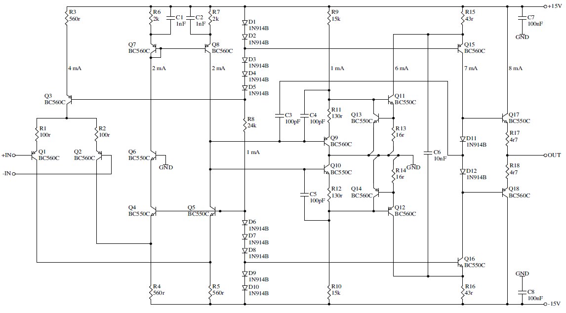

A very nicely drawn schematic! And small 'k' for kilo, too - great!
To adapt this to higher power requires adapting it to high-voltage output first. This just requires cascoding Q11,12 and using devices in the following stages that can handle the rail-to-ril output supplies. The base references forQ15,16 would have to be taken from these higher rails.
Then current gain is needed, so the output EF would have to become an EF driving mosfets, or at least an EF2 but more likely an EF3 or so.
A lot of high-power amps use a similar drive approach inasmuch as the input section drives a ground-referenced BJT pair connected in common-base, with the latter providing the level shifting to the VAS. The actual front-end inmany of these amps is an IC, which these days could just as easily have a folded-cascode input as a diff amp. The folded-cascode needs a clean supply rail to work against which is not a problem for the low-level circuitry as that can have regulated supplies. The emitters of Q15,16 should at least have decoupled supply nodes.

Could be tricky. This opamp topology would need a major redesign to work on high supply rails and with the required current gain.
For example, the folded cascode frontend holds several advantages for general purpose opamp use (like very wide input common-mode range), but little more than one of them remains relevant in a high-powered amplifier - the output is not referenced to one of the supply rails. Apart from that, a conventional cascode input would be a better match - common-mode voltage swing tends to be relatively small, and there's a fair few more choices in input devices when high sustained voltage is not required.
Not to mention that a pure AB amplifier of 200-300 W / 8 ohms tends to become a bit of a power hog.

sgrossklass: you seem to have missed the ground right in the middle of the circuit. This separates the front-end from the VAS and output making it completely unnecesary to modify the front-end (left of that ground).

That is a Samuel Groner's circuit published in Linear Audio, Volume 2, page #106.
The general concept is very detailed in the article :
http://linearaudio.net/article-detail/2106
I think Samuel is currently using this circuit for the active stages of a sine generator having the highest performances.

The circuit is pretty generic considering the new generations of opamps that have come out in the last five years or so. It can easily be made into a power amp as post-2 describes. It can easily be used as a line amp or any small-signal function. I'm sure you will see it with lots of people's name on it.
Having two stages in a folded cascode configuration is a premiere to me.
One of the ideas is to avoid the usual falling of supply rejection due to Cdom (C3 here) in the two-stages standard configuration.

forr, you can move the compensation cap to pretty much the smae place in a typical amp front end. Rather than returning Cdom to the base of the VAS, it can be taken to the feedback node. Cordell does this in his famous (and favourite) front-end, but then has to add further compensation across the diff-amp collectors.
The advantge of tying Cdom to the feedback node rather than to the VAS base is that PSRR can be improved as both ends of the cap are ground-referenced. Compensation and slew-rate are no longer tied together either.
Cdom connected to the feedback node was a scheme, lately called input inclusive, used Linsley-Hood in all his power amp designs.
It seems the conventionnal Cdom scheme allows a lower harmonic distortion.
In his article, Groner explains why his circuit has better linearity than the standard approach. It also has, aesthetically speaking, the appeal of a push-pull VAS without needing a complementary input. But it certainly requires a careful implementation.

"It seems the conventionnal Cdom scheme allows a lower harmonic distortion"
That cannot be said as a blanket statement. However, Miller compensation is probably the easiest to work with to achieve stable operation and good performance very quickly, which is why all of the early opamps followed this architecture. The examples shown by Self are fairly good as "simplest forms" of the basic Miller-comp concept and provide good enough performance for the economically minded. Others have taken that form further with stellar results.
The alternate compensation scheme provide as good performance for those willing to work on it. Cordell's mosfet amp uses input-inclusive compensation achieving c3ppm THD and 300V/us slew rate in 1984, and there are better examples today in the ppb (Self got to 3ppm two decades later). The latest generation opamps use a variety of compensation schemes as more research demonstrates them to be of benefit.
The main source of distortion of a power amp is the output stage.
The main reason that 1984 Cordell's Mosfet amp had a very low distortion relies in its output stage which uses an Error Correction scheme inspired by the Hawksford's technique described in the JAES preprint #1974, February 1980.
Douglas Self published his first (as far as I know) complete blameless circuit of a power amp at the beginning of 1994, one decade later. Its circuit is simple and PCBs were soon available. Mine are working fine since.
