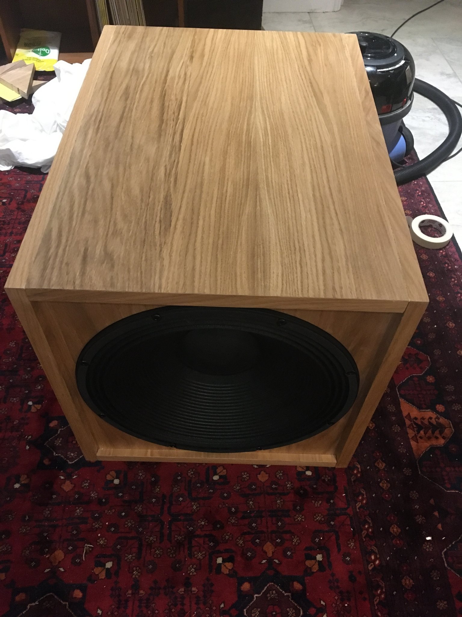

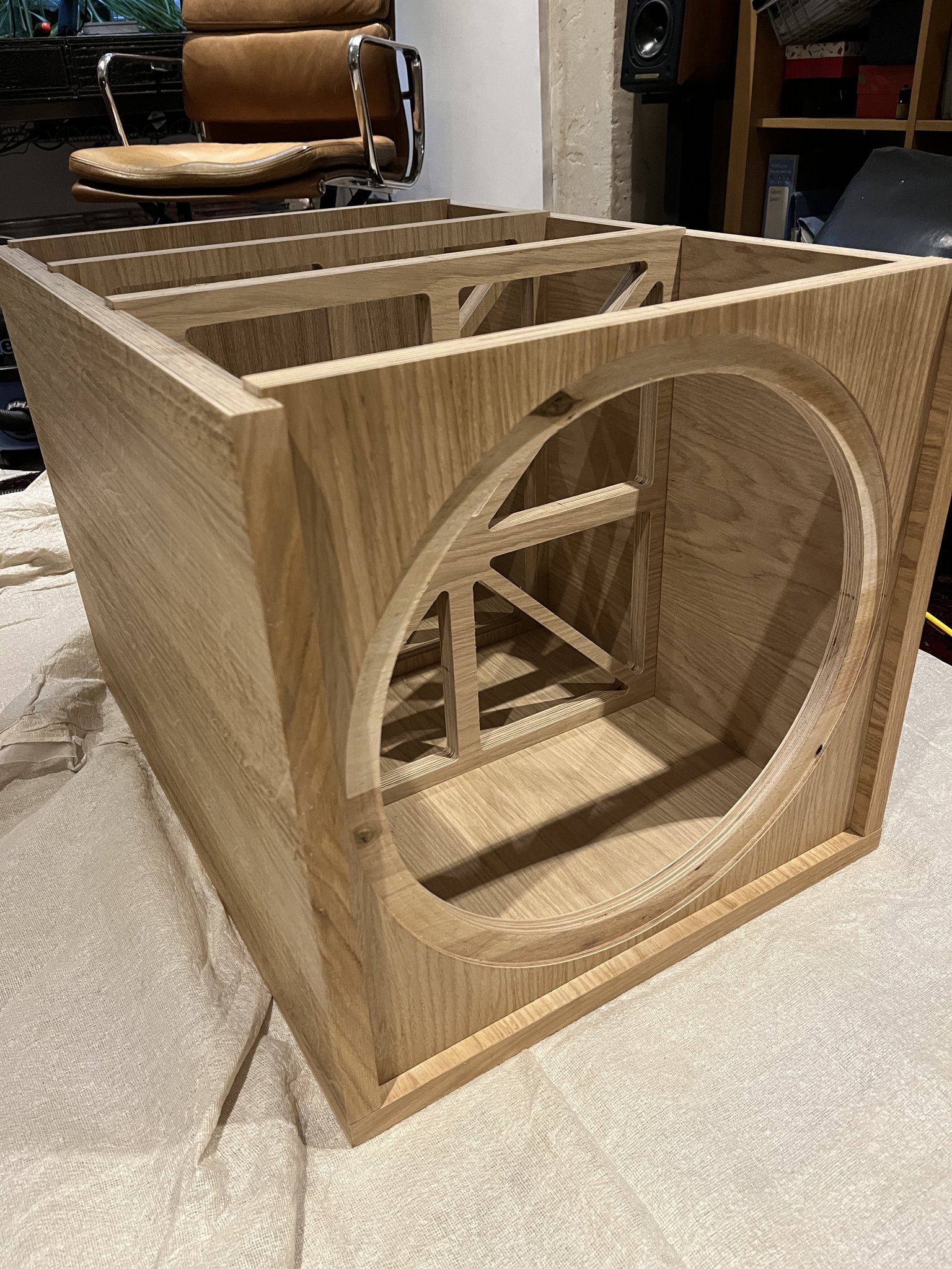

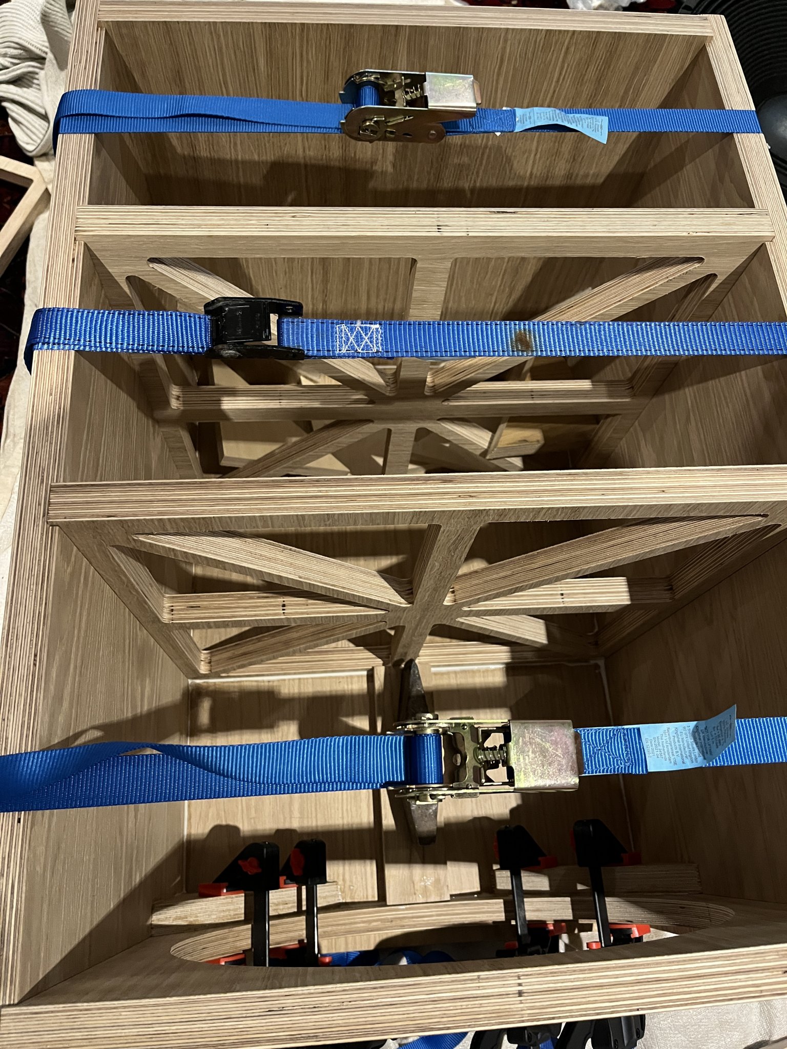

My thinking is I can sell on my Sonus Faber subs for probably over £1k each easily, they were £3k+ new and a very good hifi sub. However building a sealed 15" with a construction similar to the 18" I have built will be more rigid no doubt, plus I can increase the cone area by 60% and focus on speed and slam by using a lightweight 30 something Fs driver and targeting 35-80 Hz with a very efficient lighweight driver. The SF subs are designed to go low in a smaller enclosure and I dont need them to hit the lows as thats for my 18's primarily. I would value views on driver options so far I am thinking of something like the Faital Pro 15PR400, the SB Audience 150B350 or even the Eminence 1525 Legend. Internal volume will be something like 90L and made with 25mm Birch Ply, heavily braced. I have the amps, so its probably under £3k all in to build 3 depending on driver cost and the number of 25mm sheets required. So its more of a swap financially !!!
The cabinet will be 90L or so and a smaller version of this, my 18" unit in assembly.

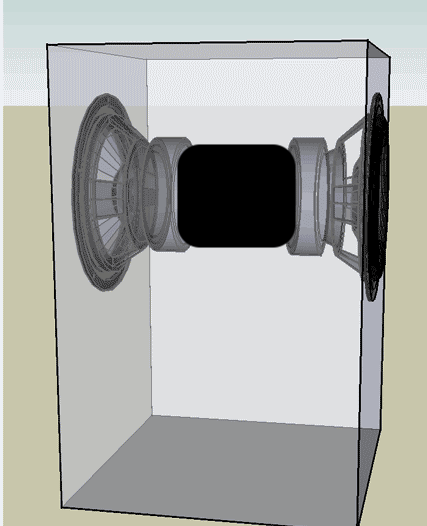

When looking at a single 15” keep in mind that 2 x 12” mounted push-push can move similar air but the active reaction force cancelation dramatically reduces the vibrational load on the bo making more a quiter woofer and one that stays in place.
I won’t build a sub again without push-push. AFAIC a no-brainer.

Any more information on this is it just opposite firing
Any information on how dual opposed perform, the cabinet size I am thinking of to fit in the room is something like 460x460x630, so deep and square a smaller version of this (18" 530x530x740). Do two drivers go as low with frequencies etc
You don’t get something for nothing though. Twice as big a box. On the other hand, 2 separate subwoofers placed about the room may provide smoother in-room response.
