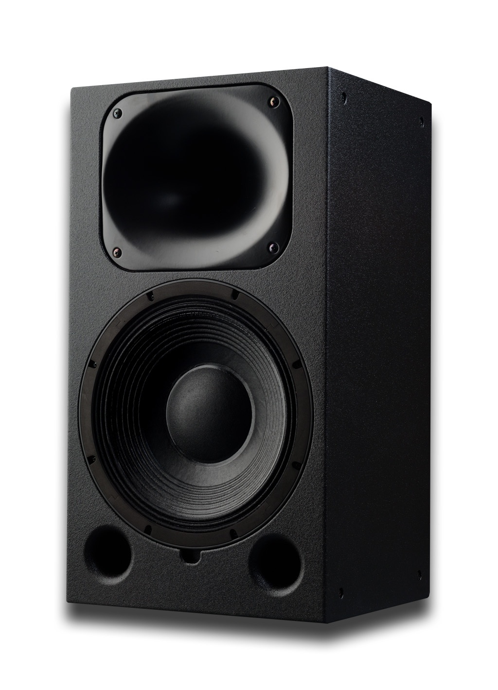

A picture, anyone recognise the woofer?

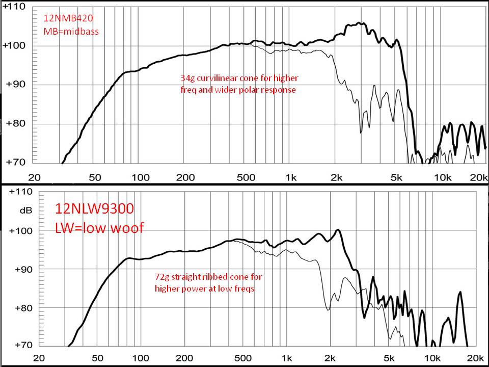

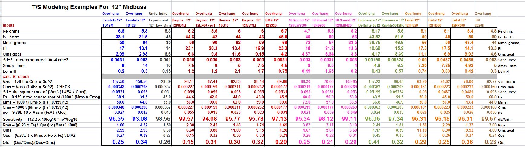

For home audio, a 12" midbass is usually selected to obtain very high efficiency over a wide bandwidth because a good 12" midbass can still be mated to a 1" compression driver that reaches 20Khz. There are several 12" speakers which can provide ~95db/watt, and a few which can provide a very dynamic ~98db/watt that tube lovers pursue.
The American made 96db/watt Lambda TD12M is the lowest distortion, best SPL curve, best polar response, true midbass that I have found. Expensive in EU, but a very good reference to study for comparison shopping. There are many great 12" midbass that have been studied for EconoWave designs with the 90x40 SEOS12 waveguide with ~1100-1200Hz Xover. Eminence Deltalite 2512 and Kapalite 3012HO are popular and have Xover designs available.
18Sound makes several 12" speakers to cover the market, including:
12NMB420 curvilinear smooth cone 34g Mms low'ish power "true midbass"
12ND930 curvilinear smooth cone 56g Mms higher power midbass "jack of all trades"
12LW9300 straight ribbed cone 72g Mms higher power woof-mid
The 12NMB420 or 12ND930 are more of a midbass design than the 12LW9300.

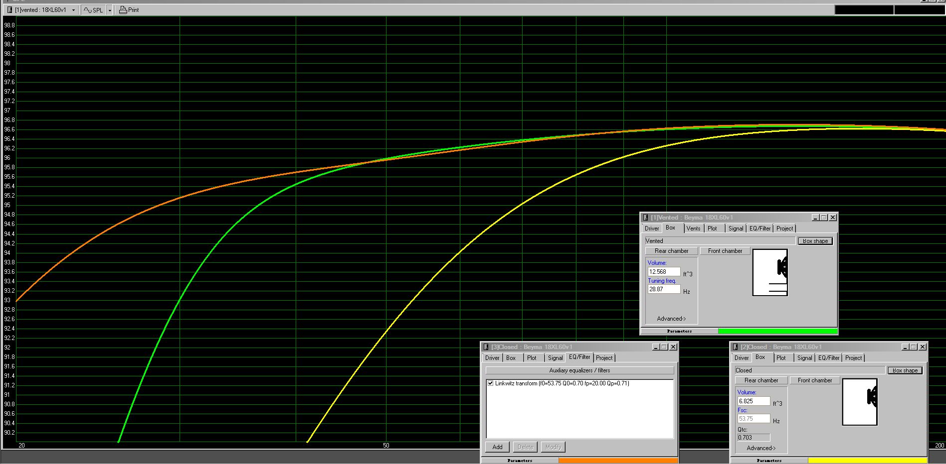

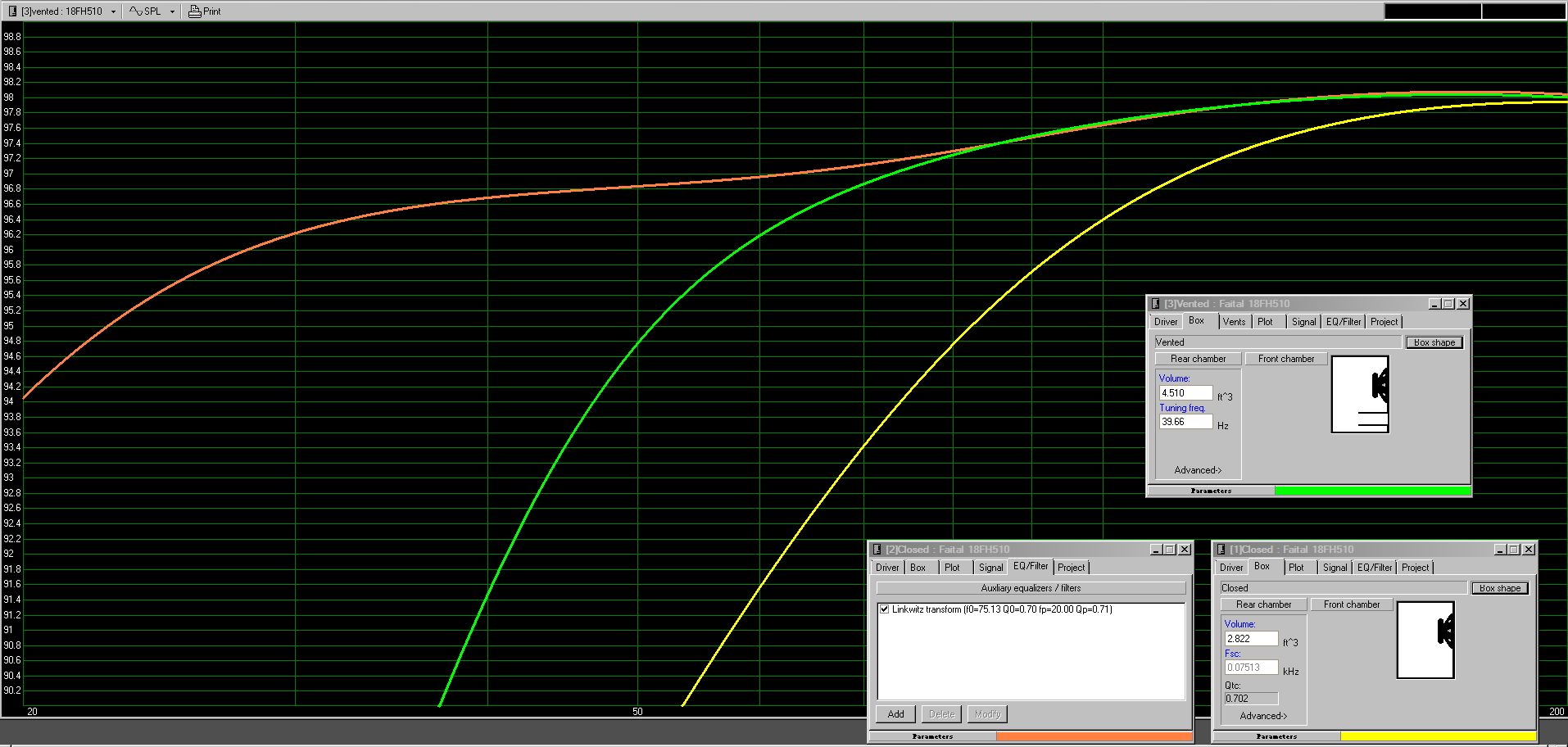

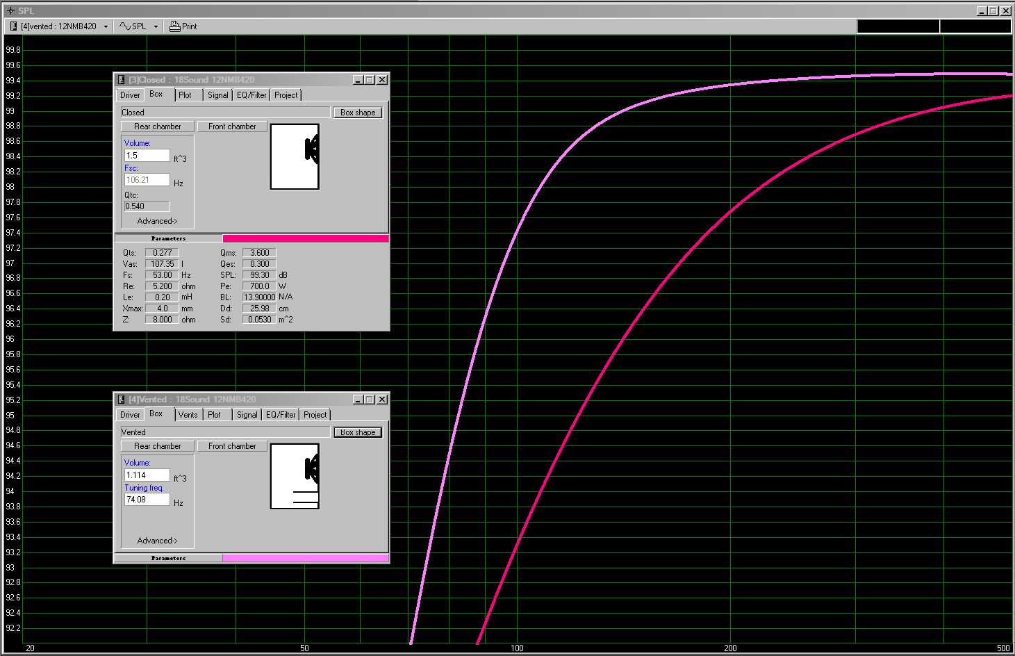

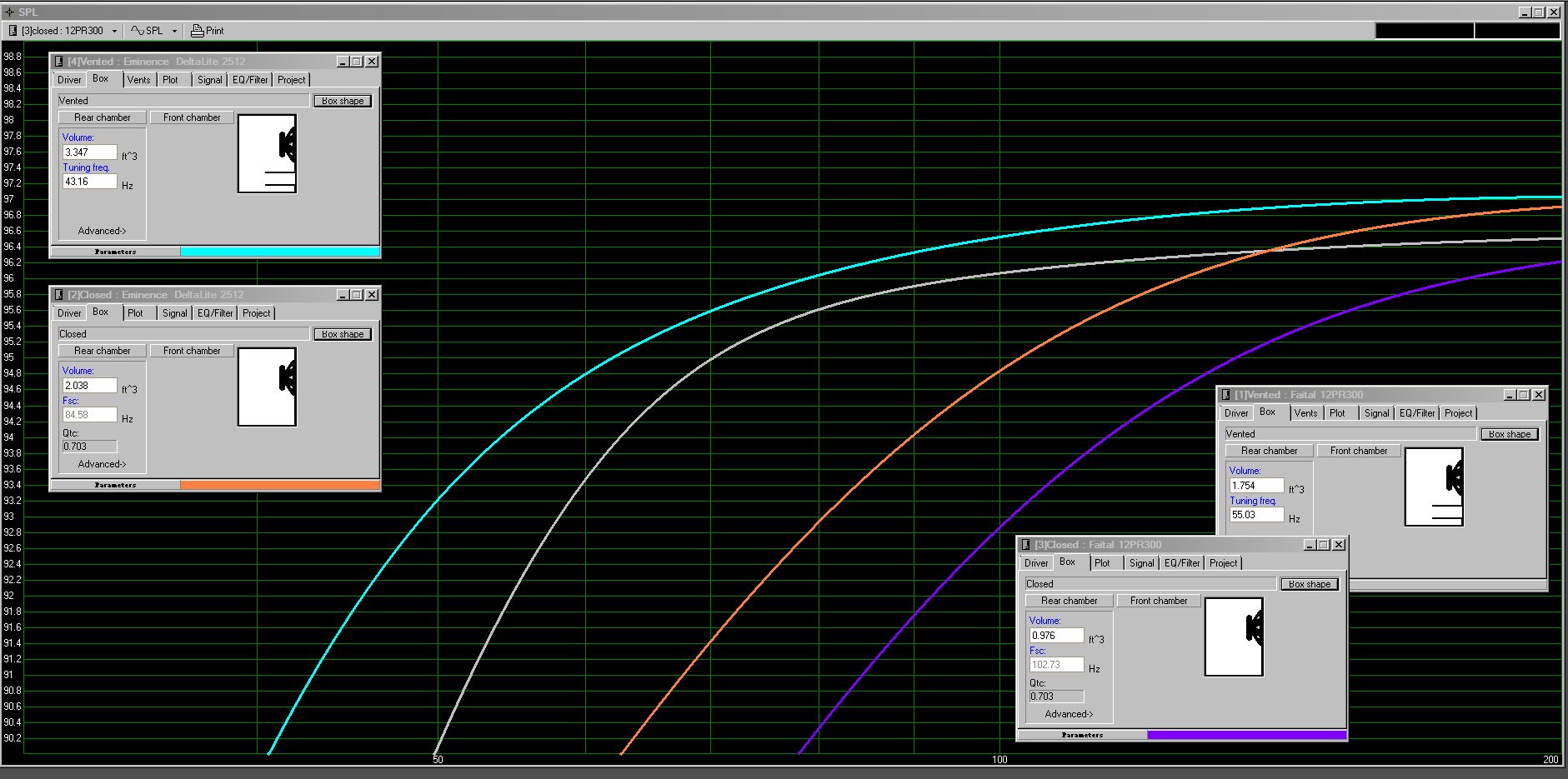

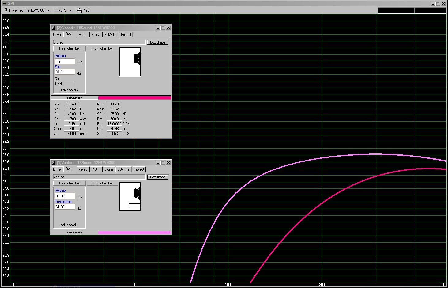

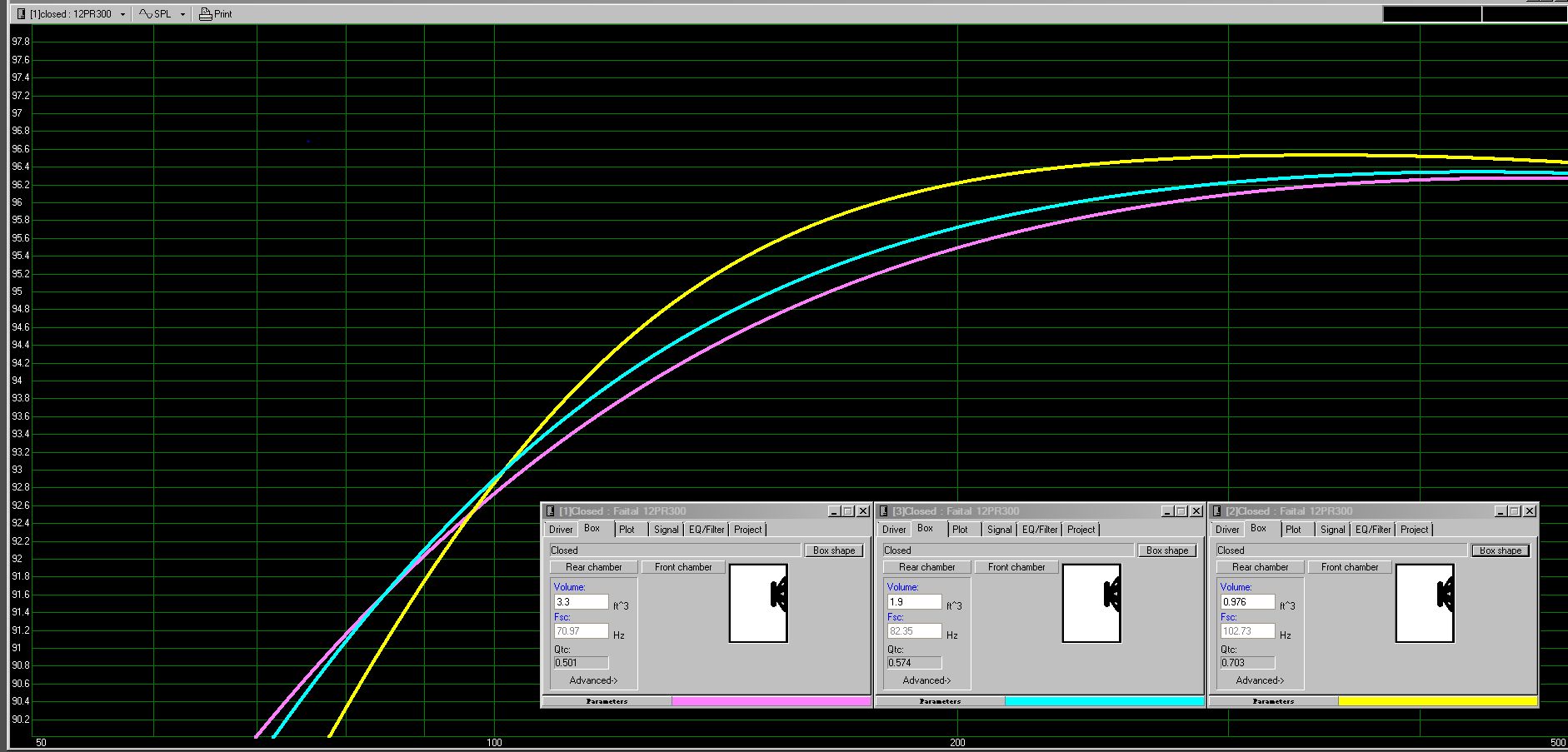

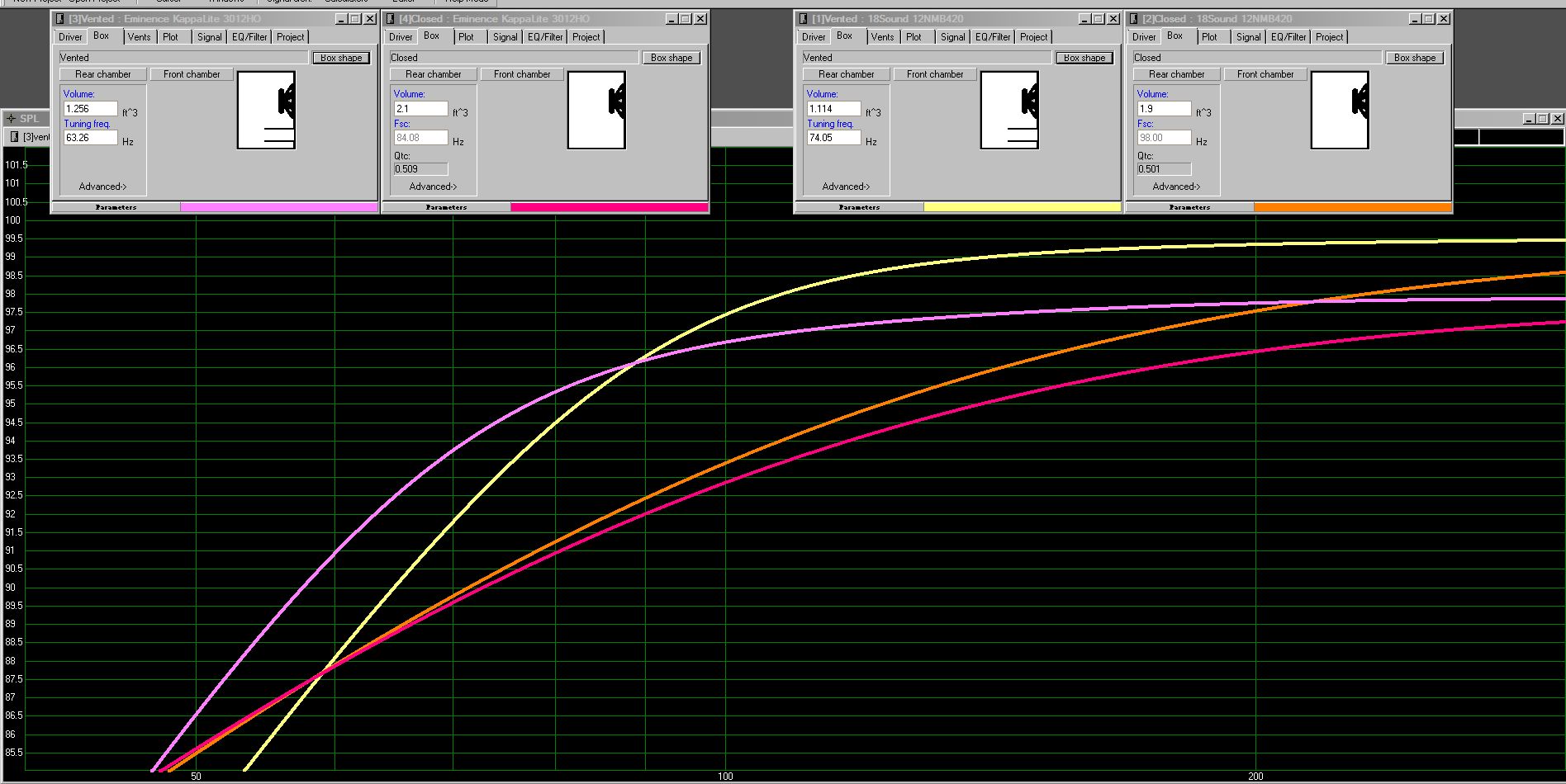

The WinISD plot shows Qtc=0.5 sealed and Qtc=0.7 ported SPL simulations for the Eminence KappaLite 3012HO and 18Sound 12NMB420. Superior transients from a sealed box has less bass extension than a ported box. Higher efficiency 12NMB420 has less bass extension than 3012HO.
Worth some simulation.

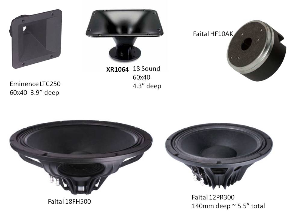

18Sound 12NMB420 or Eminence 30212HO
18Sound XR1064 60x40 constant directivity Aluminum horn
BMS 4550 1" compression driver
18" woofer usable in sealed/equalized or ported like BMS 18N830v1, Beyma 18LX60 rev1, Faital 18FH500. BIG woof needed for your >94db/watt goal.

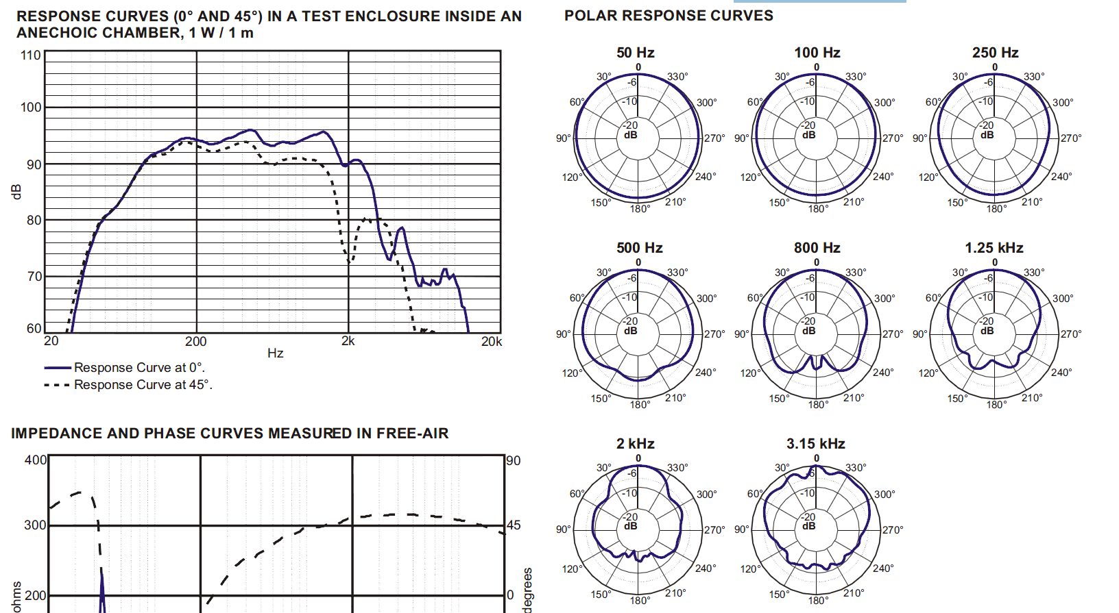

The Beyma 12P80Nd has a low Qts=0.15 as used with a rear horn design, but also has 7.5mm of Xmax with very low harmonic distortion as required in a bass reflex woofer. This speaker can allow a very tight high frequency transient response from the Qts=0.15 in a large sealed box, plus continued low Qts control down into the 80Hz bass range from electronic equalization. For your ears only.

1) If you can get good prices on Italian Faital, the 12PR300 is a good midbass.(in my table)
FAITAL ATTRACTION:
12PR300 12" mid
18FH500 18" woof
HF10AK 1" compression - very good at 1.2-1.6Khz Xover freqs
HORNS.... study physical depth and polar response of several horns to match your midbass at your selected Xover frequency. A 60 x 40 horn polar is usually a good match to a 12" midbass with 1200-1600Hz Xover. A shallow horn is needed for simple physical time alignment between the tweeter and midbass delays. Send a square wave to the midbass and tweeter mounted on a flat baffle(even cardboord box) and watch the mic signal on an O'scope for time alignment.
Common 60 x 40 horns:
a) 18Sound XR1064 1.2-1.6Khz Xover freqs or
b) Eminence LTC250 1.2-1.6Khz Xover freqs or
c) QSC waveguide at 1,100Hz Xover(pictures and Xovers on web) or
d) study and model further
The STH100 Faital Tractix horn is an attractive 3.4" deep, but it has an 80x70 polar response that has home audio crossover challenges. The 80 degree horizontal polar requires a slightly undesirably low Xover frequency from a 12" midbass. The 70 degree vertical polar puts too much room ground bounce effects to be optimal for a home application. A 40 degree vertical polar is often considered better for home listening because it removes significant floor/ceiling bounce.
2) That BMS 4538 design uses a 8" true midrange which allows a Xover over 2.4Khz which the 4538 can easily handle. The BMS 4550 is designed for lower Xover freqs.
3) If you look over the BMS 12N804 SPL vs. freq spec it shows that the heavy, flat, ribbed, cone struggles to even reach 1000Hz(big dip). If you are building a 3-way speaker, it is desirable to use a true midbass for the best possible sound. As discussed earler: curvilinear cone; low Mms, low Le, flat and well extended SPL vs. freq plot up to 2-3Khz, wide polar response above 1Khz, etc..

As for the woofer I think I'm down to a choice of 3,
18 Sound 12NMB420 £145.00
B&C 12HPL76 £184.00
FaitalPRO 12PR300 £125.00
In either a sealed or ported enclosure of around 1.2 cubic feet.
Thoughts? Money isn't really an issue for the right driver.
Remember these are not being built to be musical, I want the boom boom 🙂.

The Faital 12PR300 12" midbass and 18FH500 18" woofer are popular speakers that meet your goals and are worth additional simulation. There are several high quality DIY designs on the web for the 12PR300 that you can study or clone. Faital Pro 12PR300 + SEOS-12/DNA-360
Attached 12PR300 WinISD simulation shows SPL shapes for different volume sealed cabinets that produce popular Qtc of 0.5, 0.577, 0.7 tuning. Some ears like Qtc=0.5 "critically damped" response .some. Qtc=0.577 "maximal flat delay" response .some. Qtc=0.7 "maximum flat amplitude" response.
Attached 18FH500/18FH510 WinISD simulation shows SPL for (1) sealed box. (2) sealed box with Linkwitz Transform equalization down to 20Hz. (3) ported box. Sealed allows smaller box, but needs high power equalization for deep bass.

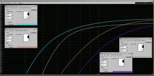

To explore box size vs. bass extension, attached WinISD models Qtc=0.7 sealed and ported boxes for:
Eminence DeltaLite
---Ported 3.5 ft^3, Fs=43Hz
---Sealed 2 ft^3, Fs=86Hz
Faital 12PR300
---Ported 1.75 ft^3, Fs=55Hz
---Sealed 1 ft^3, Fs=103Hz
Sealed midbass cabinets have better transient response than ported. I favor large'ish sealed boxes with on-wall absorption material like Owen 705 fiberglass. Most 3-way designs use a sealed midbass. The Econowave threads debate sealed vs. ported.

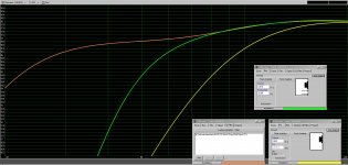

Similar Big vs. small box WinISD models for Beyma 18XL60v1 to compare with earlier post of Faital 18FH510. Faital reaches Qtc=0.7 in smaller box with higher F3 than Beyma. More amp eqalization power drives Faital to 20Hz.
BIG ported box with Beyma allows deep bass, and BIG sealed box allows deep bass with modest equalization power.
Small ported box with Faital provides modest bass, and small sealed box allows deep bass only with large equalization power.

Eminence DeltaLite
Faital 12PR300
