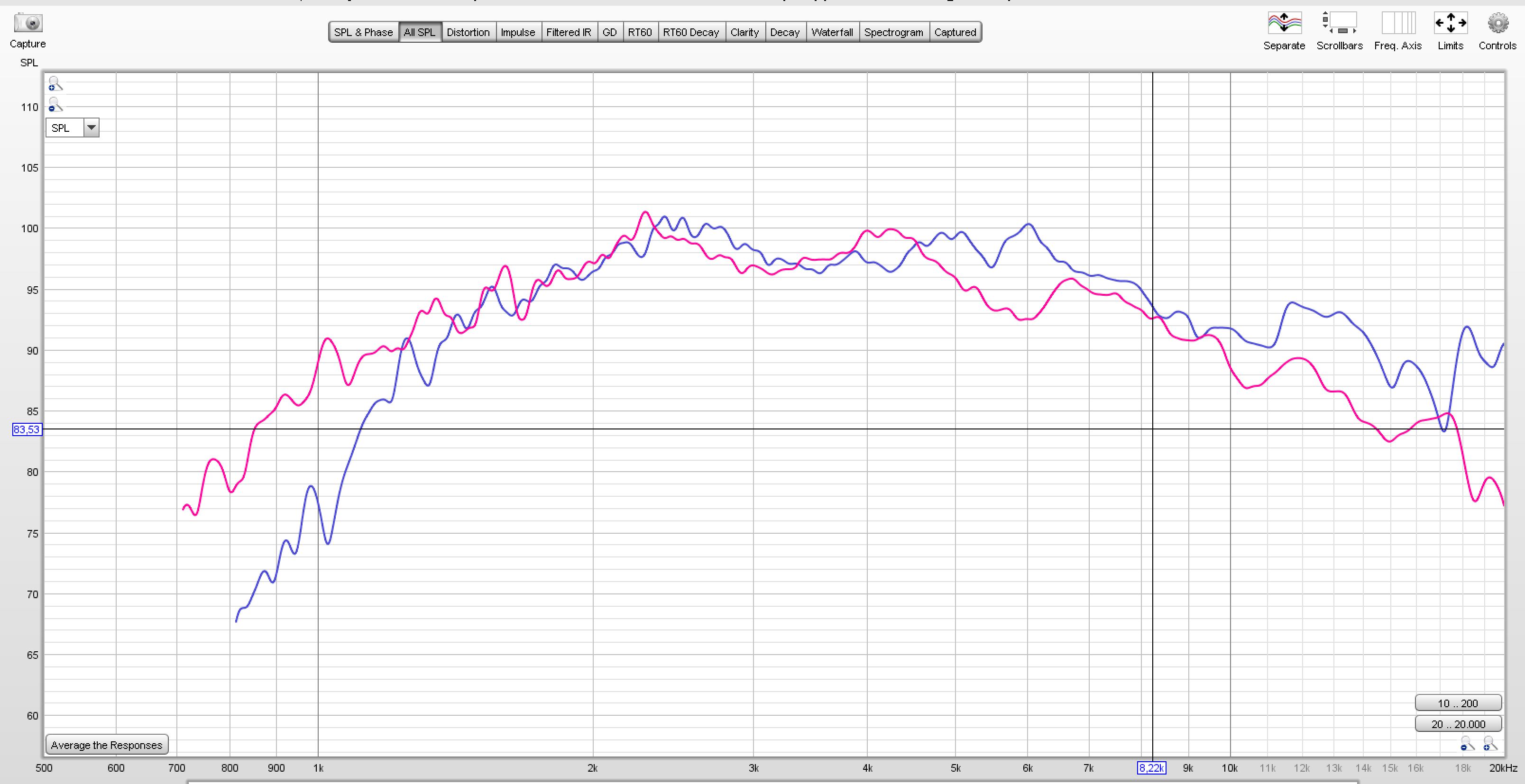

Today I received my QSC clones. Still waiting forthe B&C's to arrive.
I made some quick and dirty (uber dirty) measurements with the QSC horn and Denovo DE150 CD (from www.diysoundgroup.com) and also the Celestion CDX1746 (which is said it's the poor man's DE250).
These are taken with a Cross-Spectrum Labs calibrated MiniDSP UMIK in my lightly treated room.
Measurements are 1/24 smoothing. Red is Celestion Blue is Denovo.

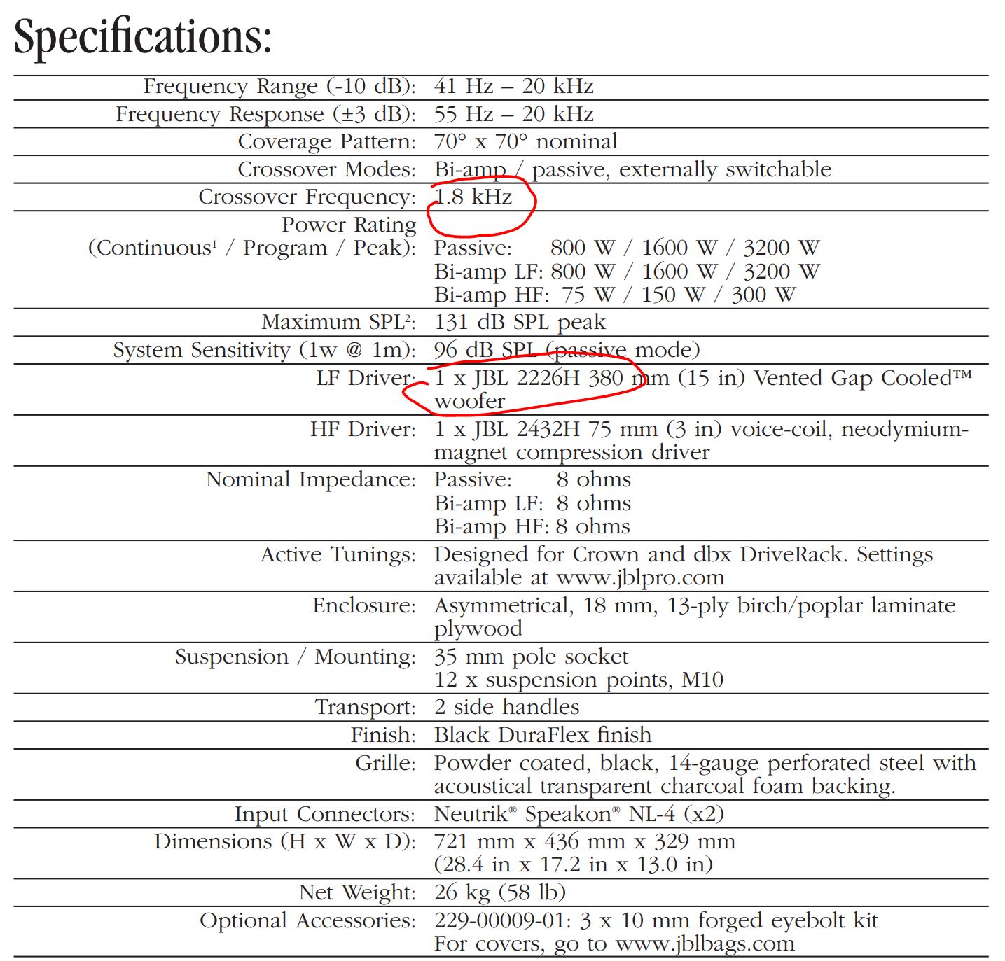

I just wanted to update the thread with a piece of information regarding the JBL 2226H.
This driver is used in the STX series with the 2432H CD and JBL 5006815 Horn.
In the 2-way design (STX815) the JBL 2226H is crossed @ 1.8khz to the CD, althou i've read this is an acoustical crossover, but IDK the difference between electric and acoustic XO, shouldn't be the same?
