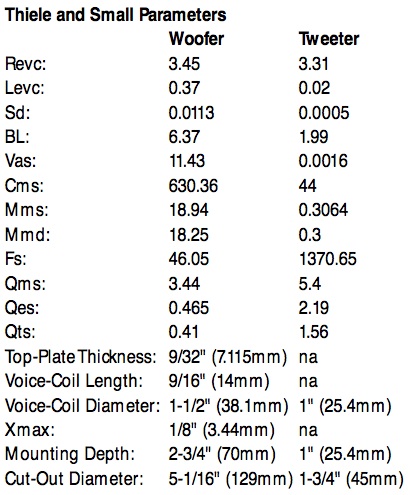

I'm new to designing enclosures and have recently purchased the Infinity Kappa Perfect 6.1 component set. I'd like to build a custom kickpanel enclosure for my Civic, but I'm confused on the T/S parameters since the units of measure (mm^3, in^3, watts, etc.) aren't listed in the users' manual and I don't know if I'm entering them correctly in WinISD.
Can someone please tell me what the units of measure are for the woofer's parameters? I've attached the parameters as an image for convenience. Also, are the units of measure that you're providing "industry standard" if the units are left out?

Right now I'm looking at the specs for a 8" woofer [click here] they have for comparison. Can I assume the units are the same? Basically this is what they show for the 8" (asterisks are added where I have questions):
Revc (ohms)
*Levc (mH)
*Sd (in^2 and cm^2)
Bl (TM)
*Vas (ft^3 and liters)
Cms (um/N)
Mms (g)
Mmd (g)
Fs (Hz)
Everything seems to match up except:
-Can the Levc be 10x smaller on the 6 1/2 than the 8 (0.37 vs 3.7)?
-The Sd for the 6 1/2 is way smaller (0.0113 vs [216cm^2 or 33.33in^2]). Multiplying 0.0113 by 1,000 (to convert liters to cm^2) only gives me 11.3cm^2 which I'm not sure is right (113cm^2 seems right to me) but seems a lot better than converting it to 1.63in^2.
-The Vas for the 6 1/2 says 11.43 and the 8" shows 1.43ft^3 and 33.72liters. It looks safe to assume the 11.43 is liters, right?
-Are Qms, Qes, Qts universal measurements?
Also, 2 more question:
1) Are any of those the woofer's displacement? I'm either a n00b and don't understand the parameters or I'm very surprised they missed that one.
2) Is the SPL entry in WinISD for the sensitivity of the speaker?
Thanks again in advance.

Greets!
Revc = 3.45 ohms
Levc = 0.37 mH
Sd = 0.0113 m = 113 cm^2
BL = 6.37 N/A
Vas = 11.43 L
Cms = 630.36 um/N = 6.3036e-04 mm/N
Mms = 18.94 gr
Mmd = 18.25 gr
Fs = 46.05 Hz
Qms = 3.44
Qes = 0.465
Qts = 0.41

Anyone that can answer the last two questions:
You're welcome!
No.
Yes, but it auto calculates it, at least the pro alpha version does. Regardless, manufacturers historically have been notorious for listing the highest peak which often isn't even in its usable pass-band [shades of the muscle car era's horsepower 'wars' 😱], so meaningless for the most part whereas the calculation using T/S specs is more accurate overall.
