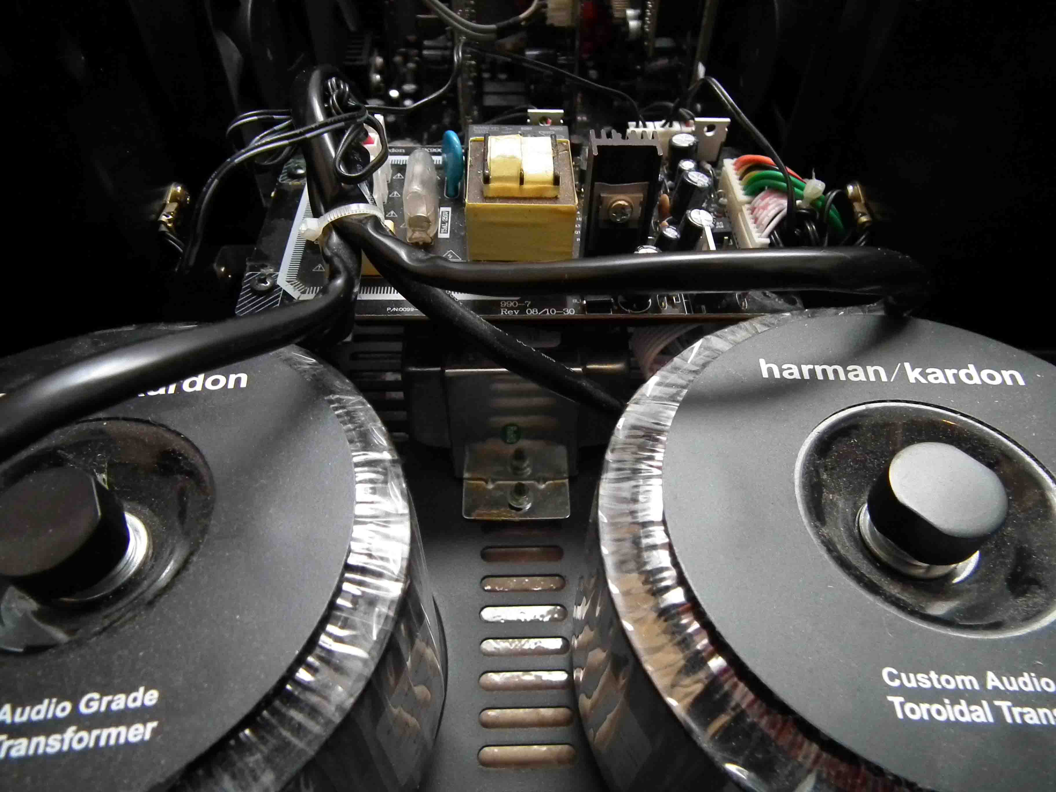

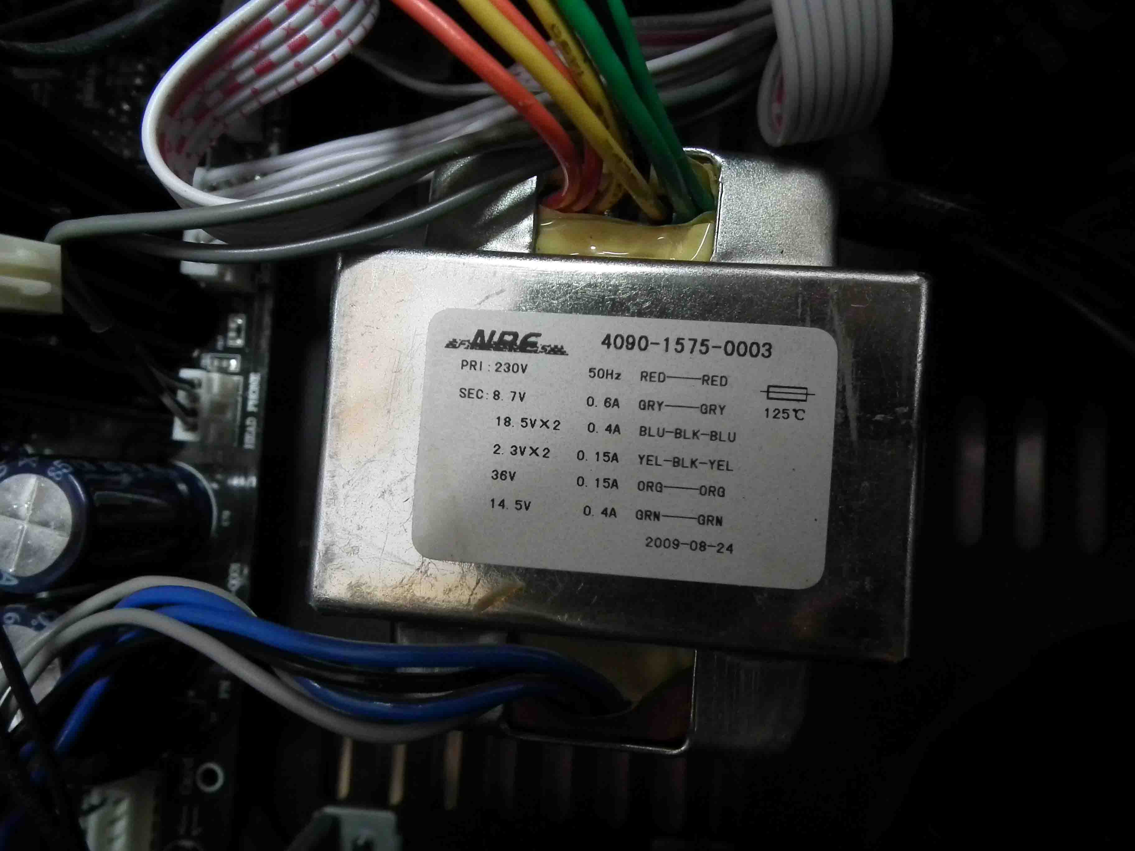

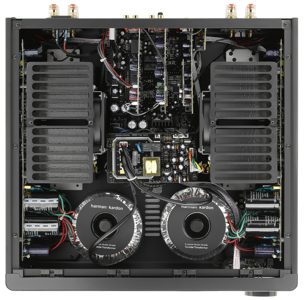

I have uploaded images from the transformer and its situation
HK990 has FOUR transformers: Two big toroids, in top is the smallest standby transformer, and under it and the central board is THE PREVIOUS section transformer, who fuse failed. this thermal fuse is set to 125 ºC as seen in picture.
The transformer is in very bad place, between the large heatsinks of the HK990 (very high biased: 170W idle power), as you can see. I think the transformer has been oerheated by its enviroment time after time... the transformer is relatively small...
After fuse changed, I put the amplifier over aluminium pieces for standing 3 cm over ground, for easier air circulating.
I think this tranformer has a bad situation, and repeated EXTERNAL overheating MAY caused thermal fuse to open... with the images, perhaps question will be clearer... ¿WHAT DO YOU THINK?
¿replace the entire transformer or keep working actual with new FUSE?????????
