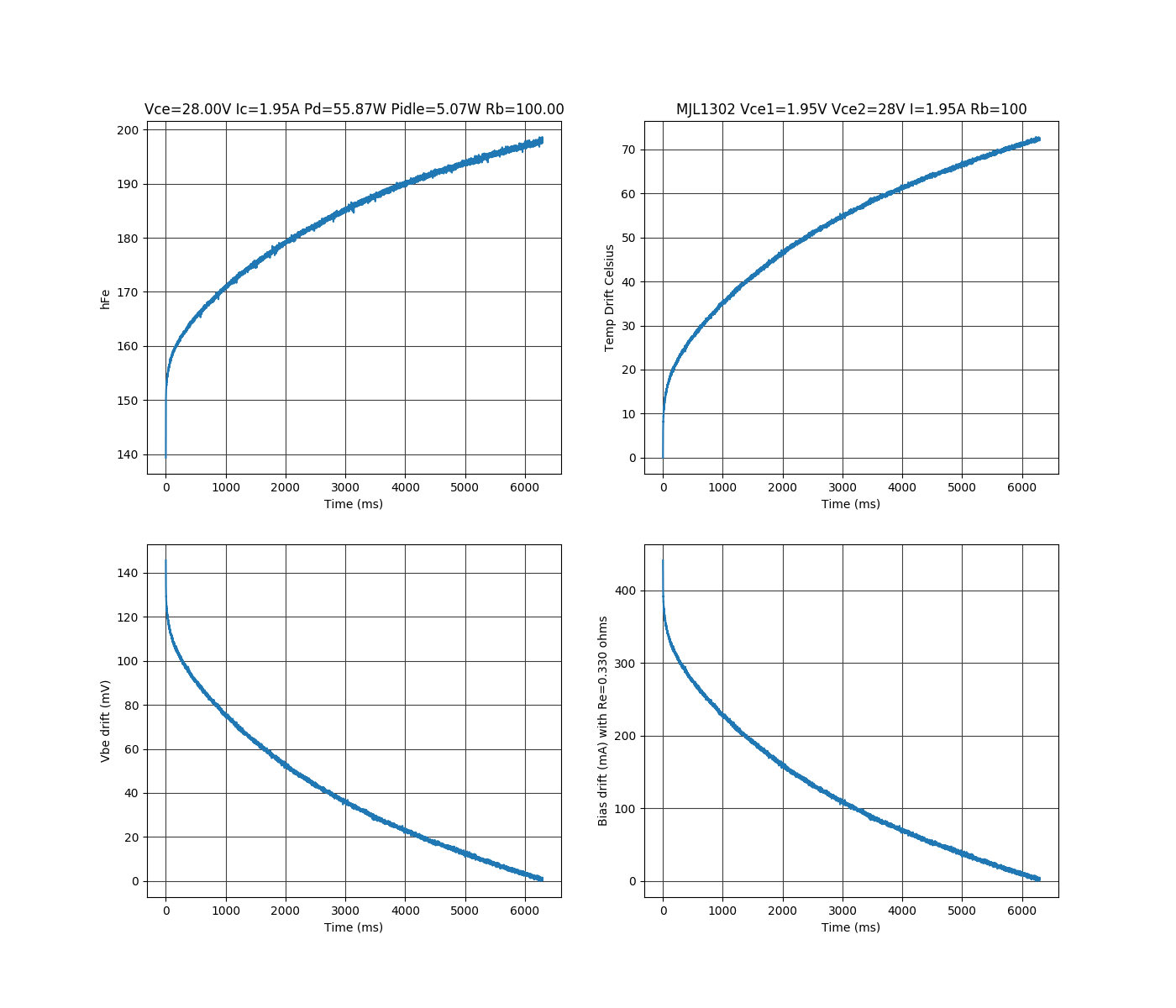

This post started a little experiment.

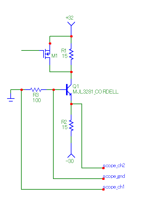

Since most transistors parameters depend on temperature, the instantaneous junction temperature would be an interesting thing to know. It isn't measurable in-circuit while an amplifier is working, but Vbe provides access to it if the transistor passes a constant current. So, here we go:
Here's the procedure:
- The MOSFET is left open for now
- Knobs on the bench power supply are turned until the transistor under test has a suitable current (2 Amps here) and a low Vce (2 Volts). The BJT should not be in saturation. Here, it dissipates about 5 watts at idle.
- Since the supply is floating, the scope GND can be connected to a convenient place. One channel measures Vbe, the other hFe, via the base resistor and the known collector current.
- Wait a bit for the temperature to stabilize.
- Turn on MOSFET, record waveforms, turn off MOSFET.
This setup is quite simple and ghetto, however there are two interesting traps that I tried to avoid:
1) The bench PSU outputs a quasi constant current. Therefore I am not testing its transient response.

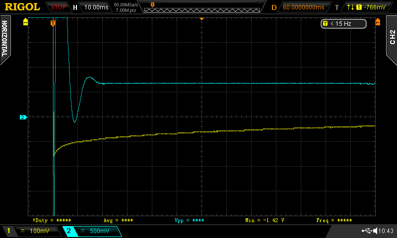

2) The opamps inside the scope inputs must not clip! This setup allows both inputs to swing very little during the experiment. It would be a very bad idea to drive the BJT from its base...
The MOSFET is switched on and off using a manual switch. It debounces it and makes switching soft and slow. This is essential to avoid a small spike, which is enough to make the opamp at the input of the scope clip. This would be the result:
The blue trace measures a signal which doesn't exist. It is simply the input opamp coming out of clipping and having trouble sorting out the fact that its input stage has a warm side and a cold side. It is called a thermal tail. This opamp, which has at least 300MHz bandwidth, takes more than 20ms to settle. Never trust your scope if the trace clips!...

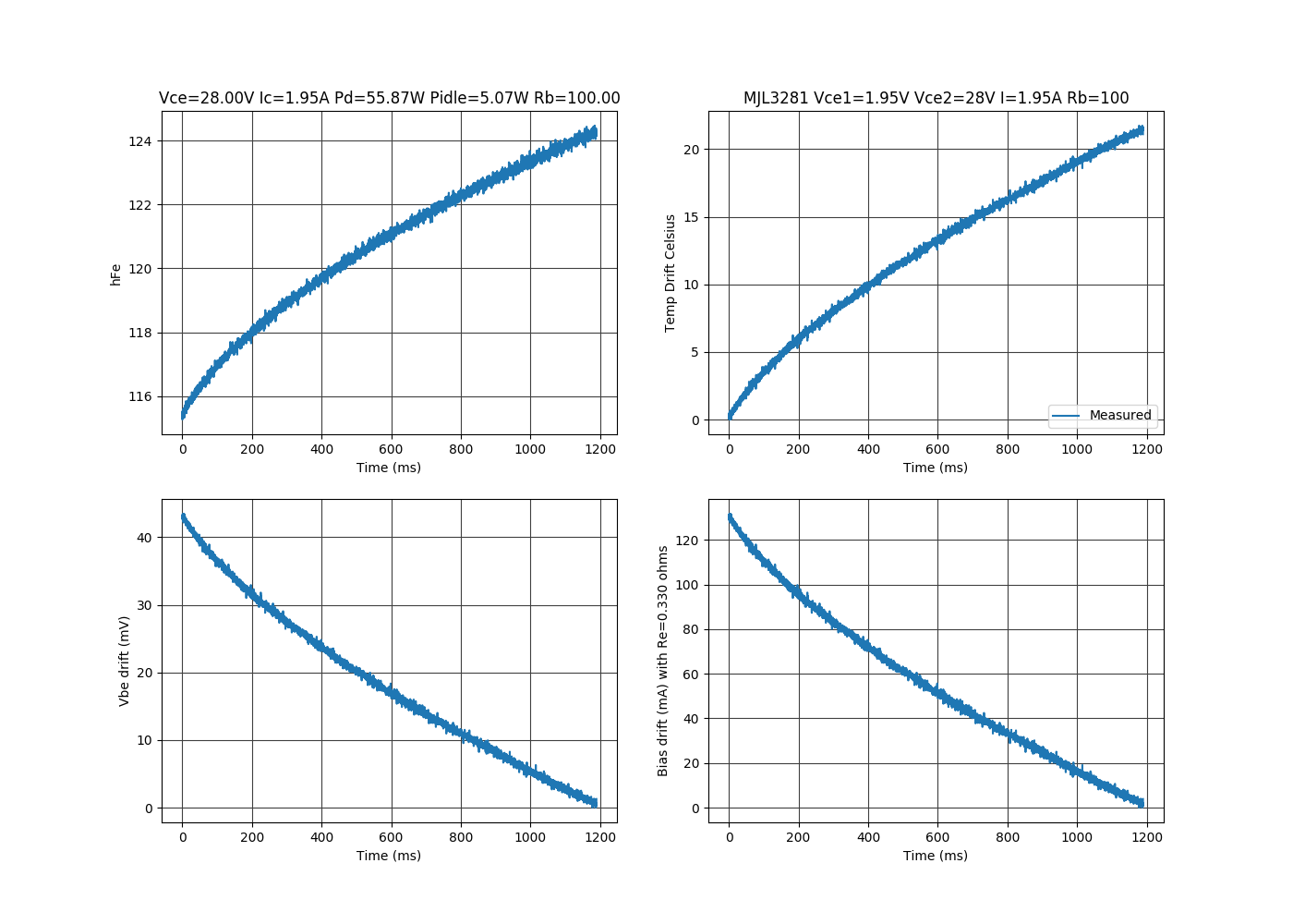

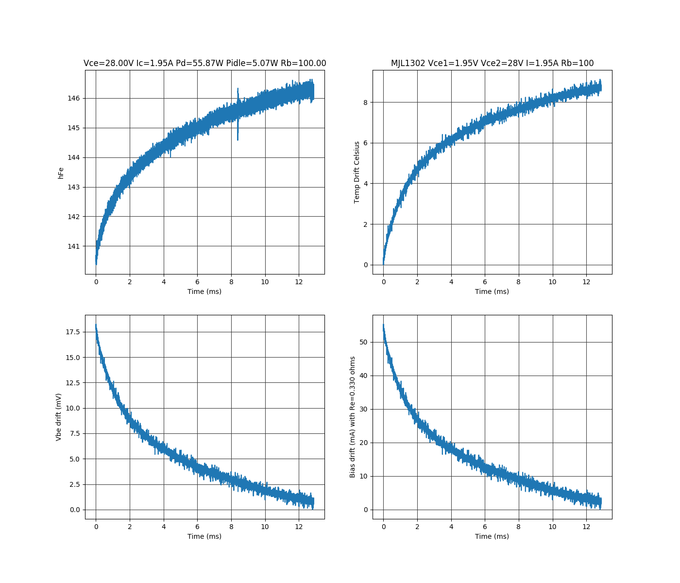

And now, with a bit of "export trace to USB key" and some python code, we get the last three graphs. This time I used Vbe under constant current as a thermometer, so the temperature readings should be accurate.
We see how Tj evolves through time as this transistor is exposed to a constant 55W dissipation. To be continued...

Now, let's plot hFe versus temperature. The relationship isn't linear, rather exponential from a temperature in °K, but as long as it isn't hot enough to blow it up, a linear approximation will do just fine.
Quick parameter fit:
Note: "Temp" is the temperature variation between the time the MOSFET was switched on and the current time. I have no idea of the absolute temperature, probably 40-50°C... but it doesn't matter a lot. The point to remember here is that this transistor gains 0.5% hFe per celsius.
Now, on to thermal modeling...

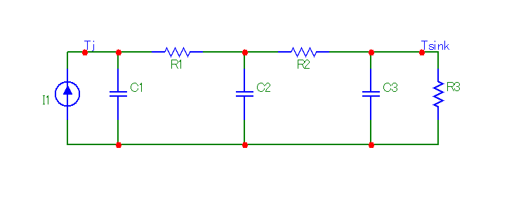

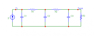

Now, wouldn't it be nice if we could have a model like this:
- Current source on the left represents dissipated power in transistor
- Tj is expressed in Volts
- Tsink (at the other end) would be the temperature of the transistor back, which touches the heatsink.
I have no interest in accurately modelling the heat sink, as it reacts very slowly. This model only tells what happens inside the transistor during about one second, which is a time scale compatible with analyzing safe operating area, fast thermal runaway and bias shifts.
Now, about 20 lines of code later... The idea is to compute the impedance, then the step response with FFT, and use a canned optimization function from scipy. Half a page of code... this software package is amazing.
This gives the graph on the right.
To use this model, R3 should be adjusted so that R1+R2+R3 correspond to the total thermal resistance between junction and free air. It will not simulate the heat sink thermal mass, but it will allow to see if a few pulses of high power signal push the transistor out of its SOA, which is always nice to know.
Code:
MJL1302
C1 = 0.0102021555832
R1 = 0.0997718886805
C2 = 0.12149333978
R2 = 0.104840396696
C3 = 1.00087678259
R3 = 0.191614159075

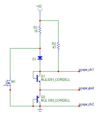

I did another experiment to double check. This time, both NPN and PNP are wired as diodes, and they are wired in series to ensure the same current goes through both.
They are biased at a current of 0.6 A via a resistor to V+.
When the MOSFET opens, the current going through the 15R resistor goes through the diode, then the BJTs instead of going to GND.
Again this is to ensure I don't measure the power supply.

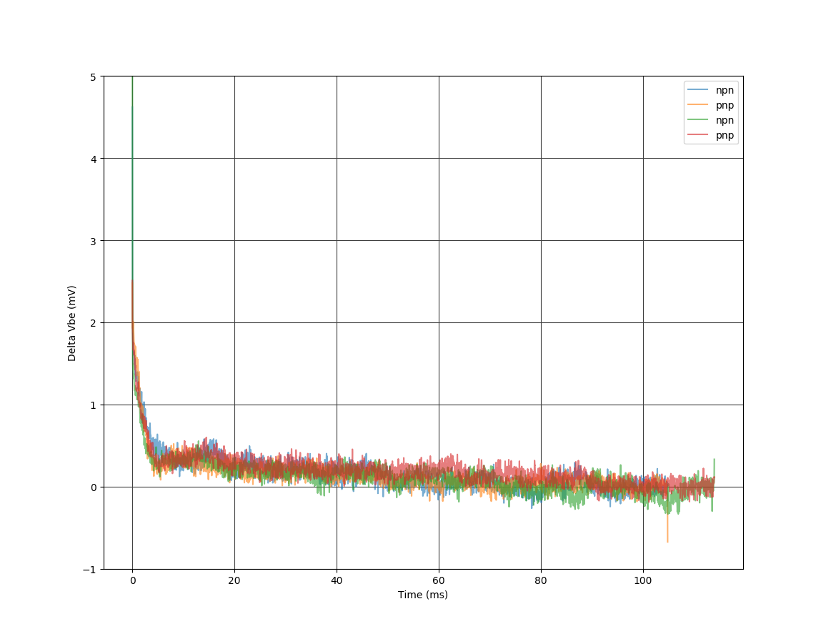

I realized I had missed a detail in the last setup: the scope did in fact clip, and I got bitten. I had set it in high-resolution mode, which time-averages samples to get more bits, so the smoothing effect hid a tiny inductive spike produced as the MOSFET switched.
I took care of it... and as a result, both PNP and NPN now have identical thermal behavior in the first milliseconds. This is their Vbe (two tests shown) as the high current is switched on:
I see no reason to doubt the hFe temperature coefficient between NPN and PNP, though. Only the thermal impedance measurement was affected.
