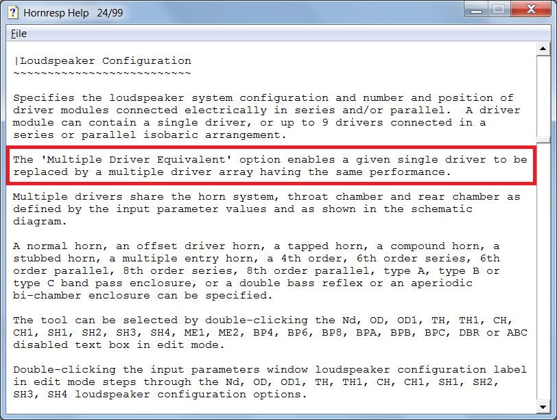

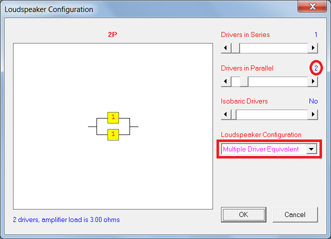

The question was more about choosing the drivers before modelling (I have the horn modelled in hornresp already.)
If you already have the system modelled with the EVM15L driver, the 'Multiple Driver Equivalent' option in the Loudspeaker Configuration tool can be used to find the required parameter values for multiple drivers.
Thanks GM !![]()
You're welcome, though forgot to mention to halve or double the Le also. 🙁

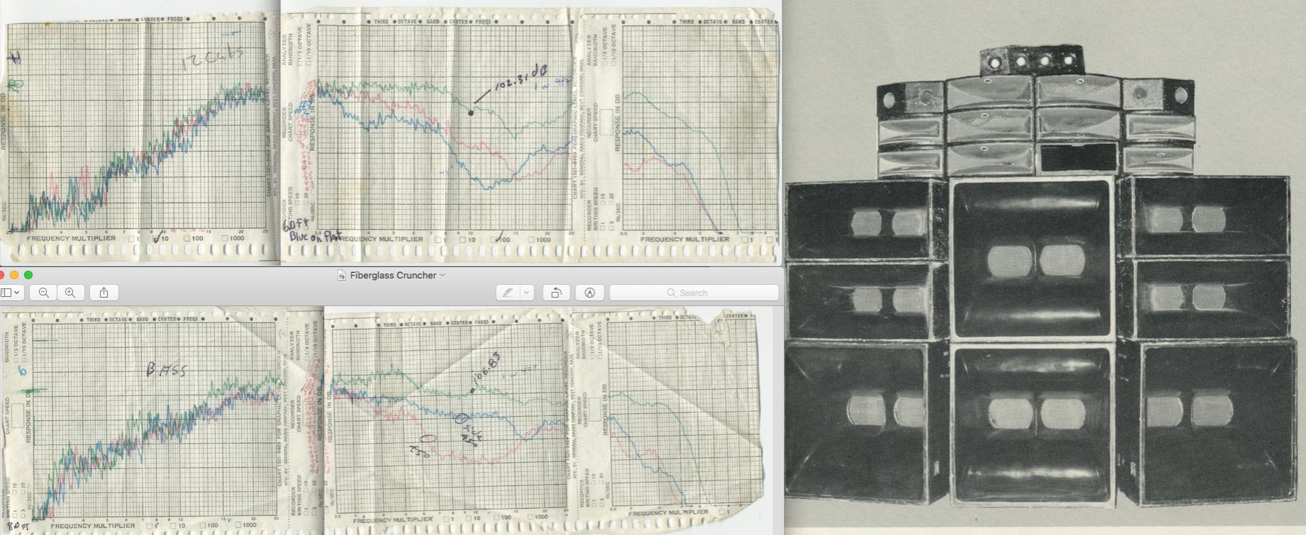

Rob,If the 2 tens were to match the EV's TS parameters, which TS parameters would be different ?
I used EV15L for bass, EV12L, for low mid in a four way system built in 1979, the response in the attached screen print below.
A curvilinear cone like the EV 15L ("Lead Guitar") designed for extended high frequency response does not behave like the flat rigid piston that Hornresp models. At higher pressures (power), the cone tends to "fold", reducing low frequency output compared to the upper response.
Depending on the frequency range you plan to use the drivers, the difference in cone design independent of TS parameters can make quite a difference.
Art

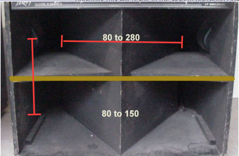

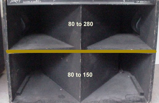

Hi Art,
This is for home use, so maximum output is not an issue.
What I'm trying to do is build a peavey FH1 type enclosure to sit under my MEH horn. (my EVM15L models good in it, and works very well in my current midbass horn)
I've had an idea to try and move the acoustic centre of the w bin closer to my MEH so that it will be within 1/4WL at the crossover. I'm going to try and split the wbin along it's longest length so that I can use 2 drivers in a 1.5 way setup. The top driver will run 80Hz to 280Hz, and the bottom driver will probably start rolling off 1st order around 150Hz.
Hopefully this will result in the system operating closer to point source.
The attatched image might explain better.
Thanks,
Rob.

Rob,This is for home use, so maximum output is not an issue.
I don't think you'll gain anything in terms of being a single point source by splitting the W bin vertically, the center to center distance L/R is greater than the vertical.
The MEH will probably need around 2ms to the W bin will probably require somewhere around 2ms delay to time align.

Rob.I'm not sure what you mean by this ? (I'd be splitting it horizontally btw)
The two sides of the "W" are two individual point sources with a longer distance between the L/R sides than the vertical distance between the vertical split.

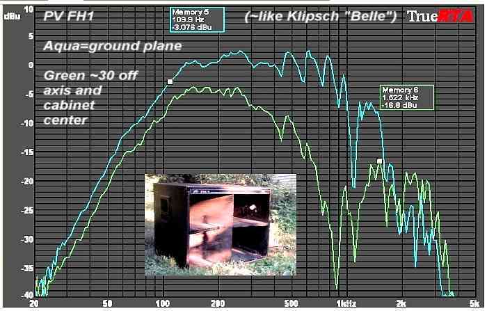

Fwiw Freddi posted a measurement of his FH1 cabs and the off axis response seems ok for my bandwidth.
Rob.

Hi Art,
The left to right distance is 366mm, which is roughly 1/4WL @ 235Hz.
Maybe easier for me to run a pair of straight horns instead.
Rob.
