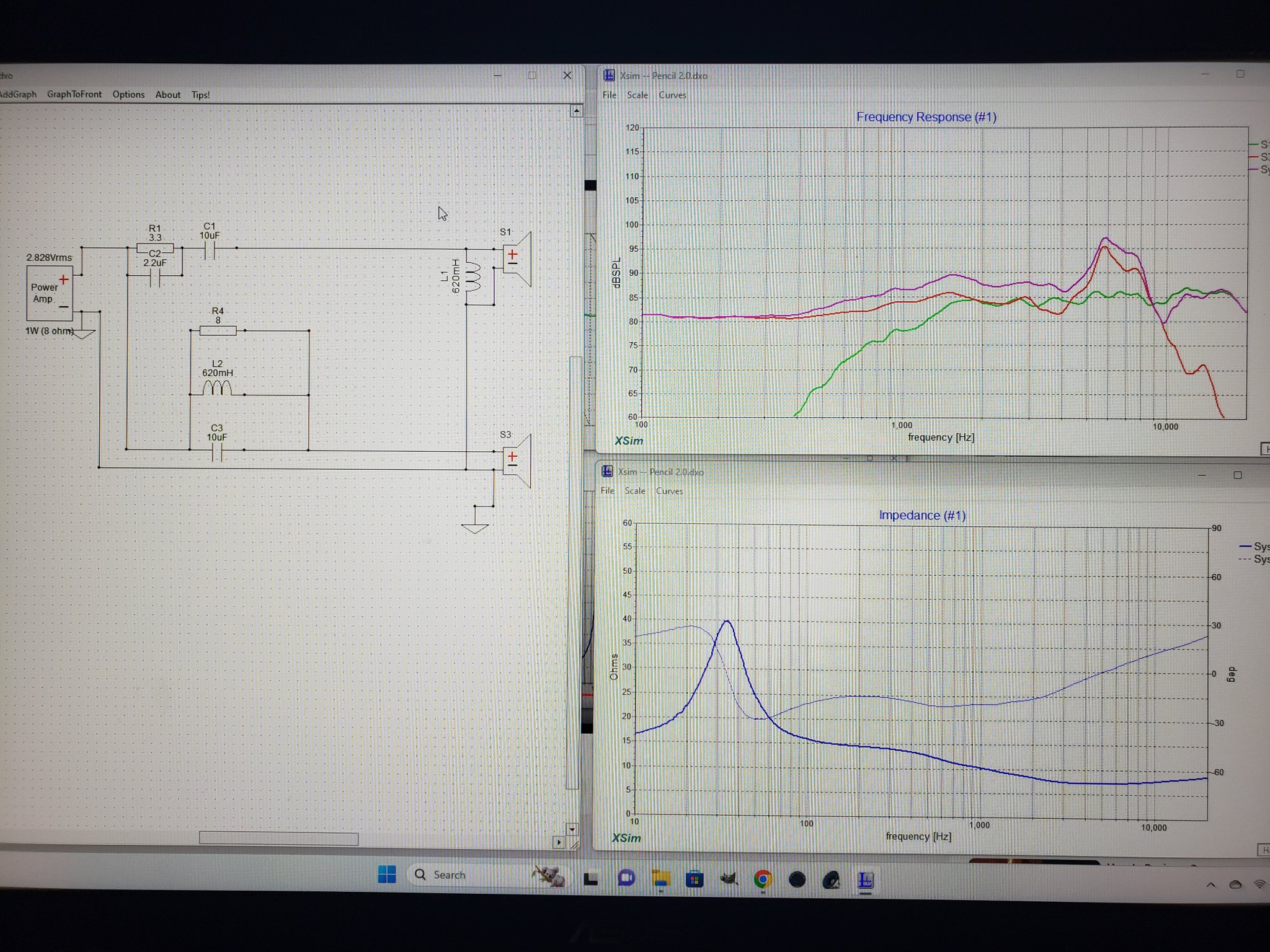

Posting your models can help people figure out what you have going on also. Even just a screen grab of the circuit and response is better than nothing. If you post the full model files, someone that uses the same software is usually willing to work with them and give you more specific pointers.
D'oh, I completely forgot to post the pic. Forgive me, its a phone pic of a computer screen, don't have the log-ins and forums across the mobile and desk top platforms.

Primary issue: you don't actually have a crossover on the woofer. You have the basics of a 12 dB/octave electrical crossover on the tweeter (see below though), but only a frequency response contouring circuit on the woofer. Since the natural roll-off of the woofer is far beyond where you want to cross over, this is not a logical approach. As discussed earlier, the breakup region of the driver is also up there and is causing the peak.I keep seeing a big spike in the woofer response above the x-over point. Without going to a $200 woofer, what should I be looking into to figure out why this is there? Is there a name for this phenomenon?
Current choice is the Dayton DC215-8 and in Xsim, its showing a 10db spike at 6Khrz when crossed over at 2Khrz. Why is this spike there? Again, this is only modeled, not measured.
And is that coil 620 mH? That ain't right. 🙂
Sticking with the CircuitBlocks in Xsim initially might help you with basic values/configurations.

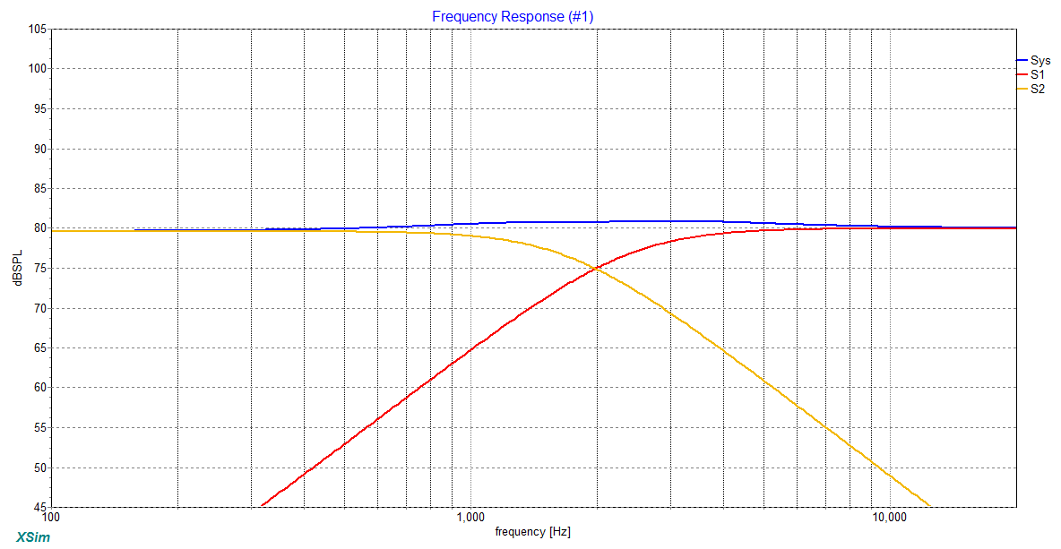

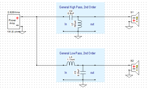

A quick 2 kHz 2nd order example based on flat impedance (8 ohm), flat frequency response (ideal) drivers. Your likely crossover component values would normally be in the neighborhood of these, as long as you aren't near the natural roll-off of the drivers or some other inherent response anomaly - which is a whole other discussion about acoustic vs. electrical response.
