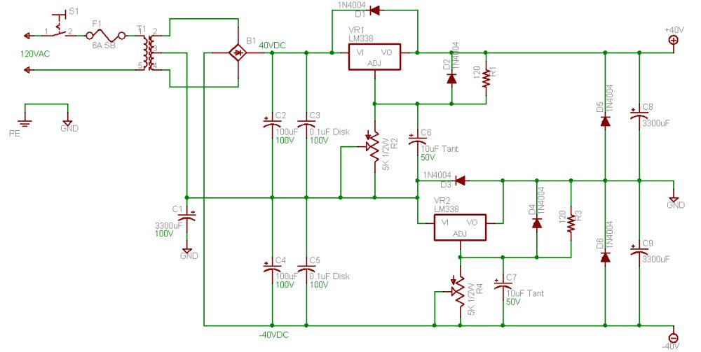

I keep lookin at 'em, thinkin how to get two 40V rails for my power amp. One's easy; gettin the negative one is also easy if you have a dual-40V transformer, but what about a full-wave center-tapped design? What will happen if you tie the input of the negative one to the ground of the other, and the center tap? I don't want to let the smoke out... particularly not with what I'm paying for those 338s.
Suggestions? Cautions? I've seen Pedja Rogic's dual rail supply, nice job BTW, I saw a mention of CarlosFM's improvements but haven't managed to come across them so far, any pointers greatly appreciated.

OK, so here's a hack at it. I'm still thinking about the bypass diode on VR2. I suspect that makes ground always more negative than the center tap. I'm also not entirely happy about the cap from the center tap to ground; it might store charge and push the center tap up.
Comments? Suggestions?

OK, got it.
The key is to add two diodes to the center tap; one pointing from ground of the positive regulator to the center tap, and one pointing from the center tap to the positive side of the negative regulator.
A second key is to ensure that the regulators don't fall out of regulation due to light load (which will allow ripple into the load, AKA "power hum" from the quiescent amp). To do this, I've added a 1K resistor between each rail and ground. Thus, quiescent, the supply draws 40mA on each side. It can supply 5A (minus that 40mA; fine, 4.96A 😛 ) from either rail to ground, and 5A from rail to rail. D1 protects against the center tap going positive and dragging ground up, and D2 protects against Vin to the regulator from being dragged negative by the center tap should it go negative. CR1 supplies full-wave to each rail, and the negative regulator conditions the negative rail thru ADJ and the 10uF tantalum cap (which bypasses ADJ to AC ground and gives ripple rejection of 75dB).
A major factor in the design in order to get the best possible noise performance and load regulation is to ensure that the bottom of R2 is connected to ground where it enters the load, rather than on the power supply board; however, both ends of R1 must be very close to the regulator. C1 and C2 provide for sudden demands from the regulators, and C3 and C4 decouple them from the power line. C7 and C8 provide "clean" power for sudden demands from the load, and C9 and C10 again decouple the regulator (they are actually on the load board, it was using unregulated power which is why I'm doing this in the first place 😛 ). I'll probably add another pair of .1uF disks to the outputs of the regulators, just for grins, since C9 and C10 are so far away.
Finally, D3 and D4 provide a discharge path for C7 and C8, so they don't destroy the regulator at startup or if there is a line short, and D5 and D6 send the discharge from C5 and C6 to the same place, since these caps are dangerous to the regulator in the event of either load or line shorts. C1-C4 cannot damage the regulators because they are on the input sides.
Someone have a look and tell me I'm not insane, please.

That arrangement is inefficient in terms of diode losses and transformer usage. Furthermore, it will cause transformer saturation in case of any load imbalance between rails. A transformer with two independent secondaries is required in order to get reasonable performance.
Also, don't waste capacitors connecting them at the output of the regulator, they are required at the input for rectification instead. 100uF at the output is enough.

I believe that D1 and D2 are necessary to prevent the negative regulator from browning out. Actually, it is D2 that is the main element in this regard; D1 merely preserves the symmetry of the loading from the center-tap's POV, mitigating the potential for unbalanced loading at least from the regulator components. Do you agree?
The system runs from standard US 120VAC, hot, neutral, and ground. Other than chassis heating, I am relatively uninterested in efficiency; thus, the minor inefficiencies of two 1.4V diode drops are of little concern to me in a 40V supply. Were the output voltage less, making the inefficiency greater, or were I working under extreme conditions where heating or waste of power were of great concern, I would avoid a linear regulator in the first place and ask you folks for advice on designing a SMPS; I have been working on a Cuk converter for another application for quite a while, titivating it to try to get the efficiency up in the 90th percentile (I'm an amateur astronomer, and I want extremely high efficiency DC-DC conversion to condition battery output (10A 12V) and currently it's at 87%- I may ask for advice later). In intermediate applications, I suspect your comments on efficiency should help others guide application of this supply, and I agree with them.
In regard to the output caps, they are already present on the amp board; and they present a surge current source that might keep the regulators from shutting down should the load beyond them make a sudden demand. While I could dismount them, it would be a big hassle and I have much newer technology 3300uF cans to use in the input filter. Under other circumstances, you would be absolutely correct, there is no justification for using such large output caps.

And just for clarity, I have amended the schematic slightly; first, the exact measured voltage at the output of the rectifier has been added. With a turns ratio of 2:1, one expects 60VRMS out of the secondary, and when I measure the output of the rectifier with my Fluke 23 (which measures true RMS, at the time the meter was made it was a major selling point), I get 58.8V (indicating that my local line voltage is running a couple volts over spec just now- the diode drops, you know). Taking this RMS voltage and multiplying by pi/2 I get 94.25VP for the peak voltage of the secondary; dividing by two to get the voltage from the center tap, I get 47.12VP, and this should very closely approximate the voltage after filtering with large caps. Note that there is sufficient headroom to provide for the ~3V minimum regulator brownout, even if the mains power fluctuates down by 5% (to 44.77V). As it is, the voltage at the inputs to the regulators will be 45.72VDC, including the diode drops, and at a setpoint of 40V (which is what the amp is designed for), the drop will be 5.72V across the regulators which is well within their design specs and will cause minimal derating. It is about an additional 2-3V beyond the brownout level.
Second, I have placed a dot-dash lined box around the components I propose to add; the components outside the box are existing, with the sole exception that the center tap is directly connected to ground in the existing design.
Hopefully this will clarify things for you.

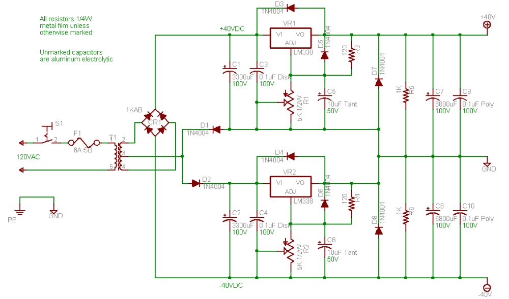

So far, so good: the regulators fit, and they seem to considerably improve the signal-to-noise ratio (now THERE'S a big surprise, NOT). I'll be testing at full power tomorrow. More after that.
It didn't work, the negative rail is unregulated. Oh, the amp worked- but the bottom rail isn't adjustable, and it has ripple. Nothing smoked or anything, it just isn't regulated. Thinking about it now.
Thought about it all the way thru practice and realized that there's no way to use two positive regulators with a center-tapped transformer. Just plain flat can't be done. Like I say, it won't blow up, it just won't regulate the bottom rail. The best I could come up with was to cascade the regulators (rather than trying to mirror them, like you would for a two-transformer or two-secondary setup), but all that would do is add the same ripple to ground as is present on the negative rail. Sigh.
I'm buying a toroid from Digi-key, which has two secondary coils; normally these are placed in series or parallel, to get twice the nominal voltage or twice the current, but as long as the load is fairly balanced it should work fine as two separate secondaries, provided I buy one that gives the voltage I need in parallel and the current I need in series.
Only in this way can the DC level float properly to remove the ripple completely. The additional advantages to this in my situation are that it will leave a hole in the bottom of the amp casing where the standard transformer is now, where I can put a fan in, and it will lighten the amp. With the new higher-powered transistors, running into a 4-ohm load on each channel, and a fan, and a regulated supply, it should be relatively bullet-proof (clearly, nothing really is, but this'll come close), and very, very quiet (and the third advantage of the toroid is it makes less EMI).
Just to be clear: don't waste your time and money on my circuit diagram in this thread. It doesn't work. If you need more than 3 amps per leg and you need two rails plus ground, it appears that you should build discrete regulators, because there is no 3-terminal solution.

The two secondaries in the power supply at the top is precisely what I was talking about.
While you can use an LM317 and an LM337 with that setup, you could also use two LM317s- or, more to the point, two LM338s, which would give you 5 amps on each rail, rather than the 1.5A you can get from the LM317 and LM337. Pedja Rogic's design, which I linked above, does this.
With the design you posted, you don't need two secondaries- although it does have the advantage that you don't need as balanced a load as you do with a center-tapped secondary.

You could use the centre tapped transformer with a Lm337 regulator for the negative side with a boost transistor, to give the current you want.
NPN power transistor say 2N3055.
Emitter to smoothing cap -40V
4.7 ohm resistor base to emitter.
Base connected to input of regulator.
Collector to output of regulator.
The power transistor will share the dissipation with the regulator

So it will; and current limiting is also possible. I have, however, a limited amount of space; the caps and a single TO-3 take most of it. I'd hate to try to shoehorn a TO-220 in there, and the current sense resistor that either of the two current limiting methods I know of require is completely out of the question.
And I'm a little nervous about the transformer in the first place; I don't have specs on it, and it's a nasty, heavy, noisy thing; and dangerous if it gets overloaded, IMHO. A toroid will give multiple advantages and my wife is not averse to spending the money on it. 😀
If I recall correctly, the biasing resistor's value depends upon the DC β (AKA h(FE)) of the power transistor; 4 ohm will work fine with a 2N3055. But the current sense resistor must be able to handle all the current through the entire supply; in this case, about 5A. To forward bias the BE junction of a small-signal transistor and pull the base of the power transistor to hot to unbias ITS BE junction requires some 1-2V; at 6A (the limits of the LM338), that makes the resistor about 0.33 ohm, and 15W. Not a small resistor. You can run it unlimited if you like, but that's risky for equipment I might have on stage behind me. Nothing like a nice fire in a crowded bar. I'd be lucky to escape alive. Safety first.
I'll post a circuit with some notes shortly. Your idea is worth exploring, and it should be available if someone wants to try it.
Yes, to get current limit you put a sense resistor in the emitter lead and use it to turn on another transistor which will pull down the power transistor base.
But you only need 0.65V to turn on the transistor so 0.22ohm will give you a 3A limit thru the transistor + whatever the regulator will give.
Personally I would not bother with that arrangement I would use a fuse.
