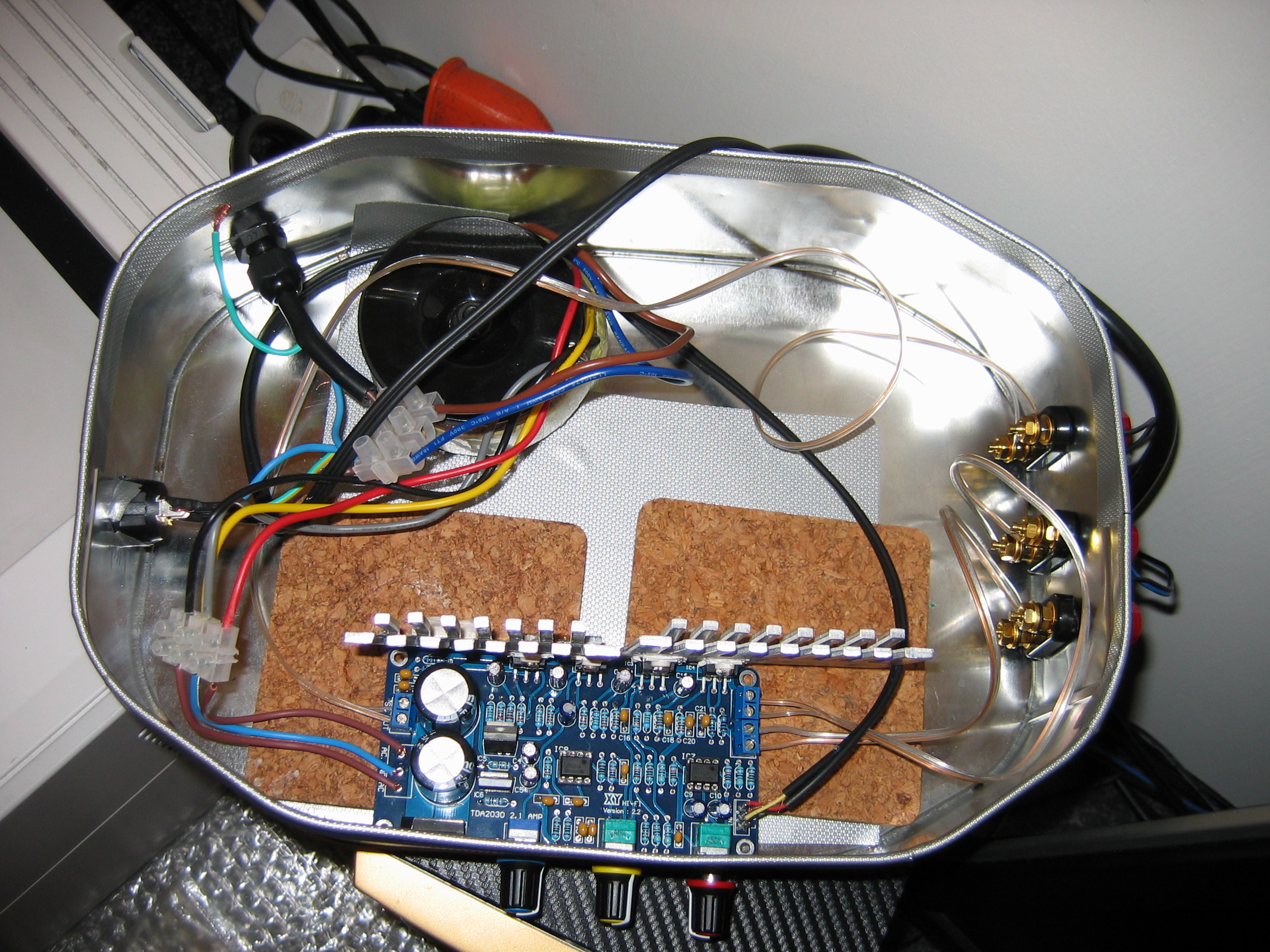

This then led me to consider 2.1 amps and finally the XY board. I paid $7 including postage for the kit. The kit showed up with no parts list and no schematic and I wound up getting e-bay to get the seller to send me some instructions so I could figure out which resistors went where. I should have been cross but this was a $7 hobby project.
The circuit is pretty darn good but the board suffers from tiny pads. This isn’t a problem for most of the components but the rectifier, cable connectors and pots all need bigger solder areas.
I powered the board with a reused 50VA 12 volt toroidal transformer. On board there is bridge rectifier that looks pretty manly and a couple of no special name 6800uF 25V caps. After rectification I measure about 18.3 volts DC.
The board has positive and negative 12 volt regulators – from memory I think these 78/79-12 regulators are good for about an amp and a half.
Two NE5532 op amps sort out the volumes.
There are 4 TDA2030A amps. Two for the left and right plus two bridged for the subwoofer. I have no idea what the filter for the sub is set to – 300 Hz?
The heat sinks are scavenged and are not satisfactory in several ways but they work well enough in this proof of concept biscuit tin.
This leads me to the only real problems that I have had with this build. The enclosure and the heat sink. If you build one of these you need to consider these two issues up front. I’ll be changing the heat sinks on mine but I think I’ll also be using mechanical ventilation – something I really wanted to avoid.

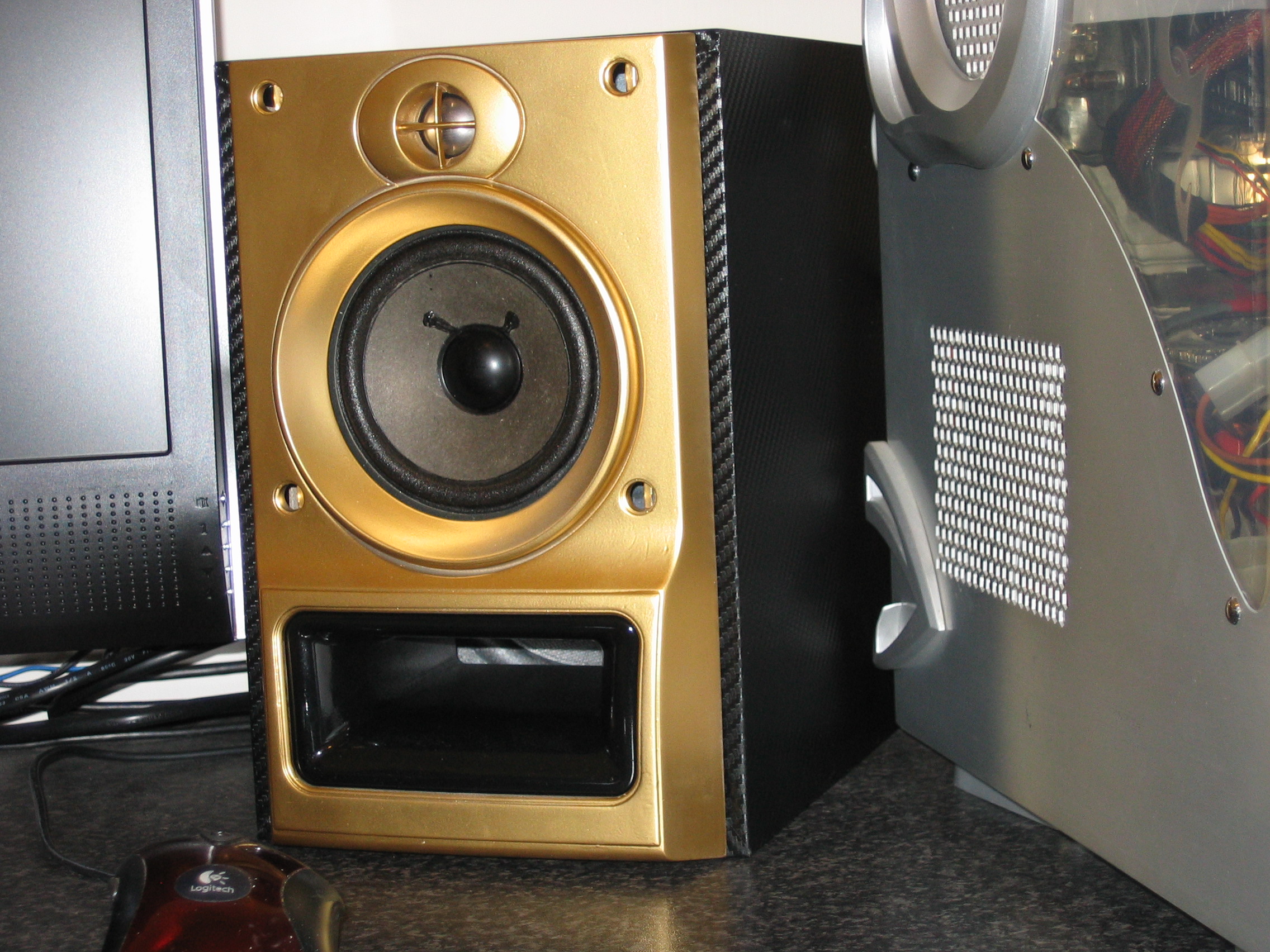

Back to the speakers. I threw away the cloth covers and recovered the speaker body with carbon fibre effect vinyl. I spray under coated all the visible plastic with Poundland white undercoat and the bass ports gloss black. Little bit of work with wet & dry paper. So £2 on paint. Then I totally broke the bank on a can of Rustoleum gold. £8. Just like that. I was throwing money about like the European Commission that day.
I found out later that gold looks better on a matt black undercoat. C’est la vie.

Really good is the answer. The internal subwoofers are wired in series to the amp sub out.
The sound is really rich, defined and precise - the whole thing sounds a thousand times better than it ought to. I’m not just saying that by the way. Getting the base up from the floor was a practical concern but I think it’s way better sound wise.
