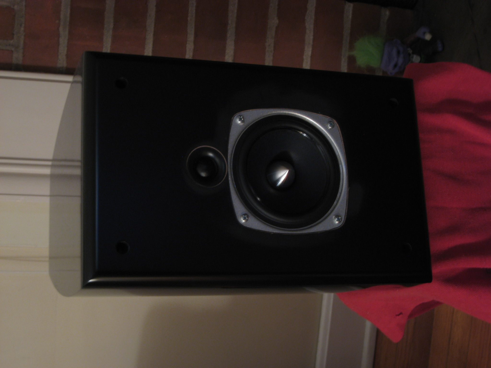

Very nice chuck,
what's the next step?
There's a lot of work in front of you. (and I'm not talking about the money) The driver looks very good.
