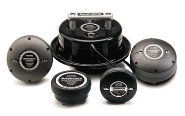

One thing is very peculiar: They couple the convex side of the diaphragm to the horn throat.
The throat is usually coupled to the other side of the diaphragm for good reasons !

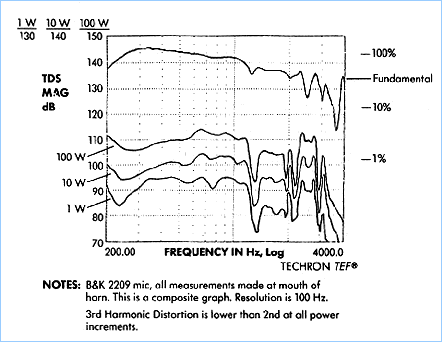

I dunno, from glancing at the specs, no comparison I think. The M4 goes down an extra octave and the distortion figures are extremely low. They are given for 10% output and 100%. If I am reading this correctly this means at 20W and 200W program power, not 1W/1M as the BMS product. I draw from this that we got 114dB at 1W, therefore 131 dB at 1M for 20W with less than 1.5% second harmonic (at 1KHz!) and, well MUCH less third harmonic distortion, which would be the evil one here. It looks like less than 2% 3rd harm. distortion at 200W= 137 dB SPL! ..and it goes down to 300 Hz 😱
I gather you would probably need a minimum of 8 high regular pro low midrange direct radiators to come even close to this performance in SPL and their combined distortion figure could not come even close.
******* awesome specs, but the thing could sound like a trashcan. Correct me please if I am wrong. 😉
I gather you would probably need a minimum of 8 high regular pro low midrange direct radiators to come even close to this performance in SPL and there combined distortion figure could not come even close.

The BMS does indeed appear to be rated at level (i.e. 118 db) where the 2nd harm. distortion figures are less than .5% from 250 to 1kHz and less than 1% above 1kHz (with 3rd order at less than .1% at all freq.s). (Note: the distortion graphing is raised in level substantially.) As far as what happens when power input is increased - I don't know. So I could be wrong about the distortion statement.
Additionally I couldn't find any info on the smoothing going on for the BMS driver - so again its hard to say if one driver has a smother response than the other.
What I will say is that the community driver is NOT a midrange driver - the evident break-up above 2kHz suggests that the driver needs a VERY steep crossover around this freq. (or lower). (i.e. its a lower midrange driver.) On the otherhand it does go an octave lower. Unfortunetly this means that another mid-driver is still needed if your going to use the community driver.
On the otherhand the BMS driver goes quite high in freq. - extending past the midrange with very little break-up. Practically speaking this means that the BMS driver will be FAR easier to integrate into a viable design.
I'm also not terribly fond of impeadance increasing as far as it does in the community driver, it makes me wonder what the phase-angle is doing.

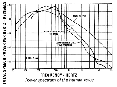

......essentially covering the entire vocal fundamental range!
Hmm, human vocals go down to 60Hz, though a bit rolled off. A man's pitch starts around 96Hz, so I assume that's why the earliest PA/theater horns had a 100Hz Fc.
GM
Yep, 250 is ~ middle C on the piano. I dunno about y'all, but I can sing a lot lower than that. 250 is straining.
I don't know why it's so popular these days to cross over at 150-200 to "cover the entire vocal range".
Shocking new development: a 'woofer'. Covers the entire fundamental vocal range: 60-800hz.

Power Spectrum of VOX
Both of you are correct to some degree. 😀
To clarify but not necessarily to abdicate my own imprecision, I would like to say that I was referring to popular music mixing in which the voice is usually somewhat constricted to a certain frequency area . While our vocal chords are able to oscillate within a range of about 50 to 5000Hz (and a bass singer can produce notes in the 80Hz range) our vocal tract acts as a resonator and the first modal resonant peak (formant) of the human voice usually lies around 270Hz . I think from this fact most manufacturers place crossover points somewhat below that range. As far as the M4 driver in question is concerned, it claims to cover the "articulation range" of the human voice, fair enough I think.
The attached measurement elucidates the power spectrum of the human voice.

Greg B said:Yep, 250 is ~ middle C on the piano. I dunno about y'all, but I can sing a lot lower than that. 250 is straining.
GB
