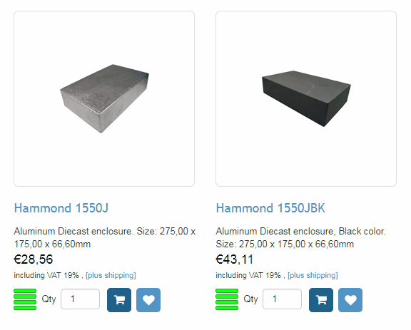

Like the other ULTIMATEs, it will be built in the same Hammond aluminium box :
The protoype looks like this below :

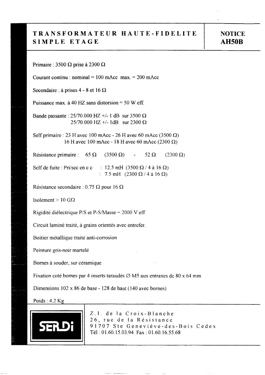

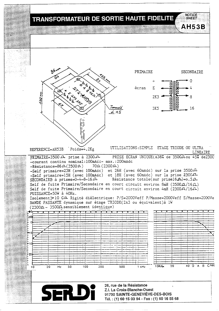

For the moment, except a 10dB NFB, I did not tried any other correction. I wonder if my STS AH50B output transformers (used) have not suffered... 😕
Here are their specs (AH50B and AH53B are nearly identical) - it's in French, but the numbers are understandable, fortunately :
As you can see, they are not "average" models, but... 😕😕😕

OK - these transformers are not premium : their assembly and impregnation have to be desired... Too bad, otherwise their performances would be good. 🙁
Since I had them for free, I won't complain too much... 😉

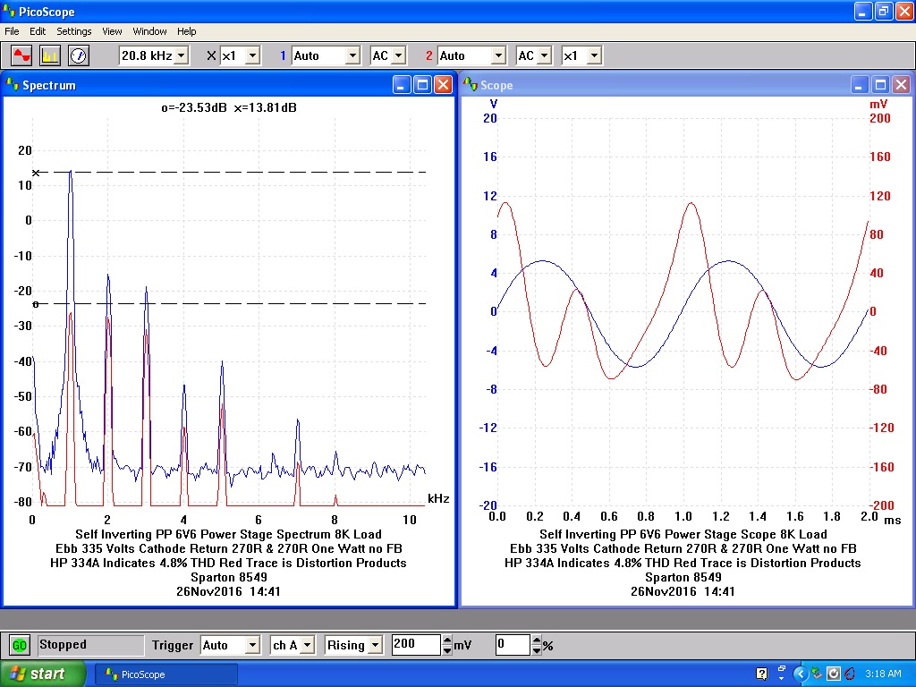

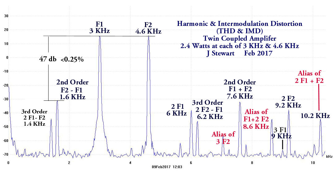

I'd be interested to see similar oscillograms of such kind of single-ended amp from you Guys, so thanks to post pictures !
Oscillograms don't tell us much but measurements of THD & IMD would help a lot. All easy to do now, reliable test equipment is widely available. The test conditions should always reported at the same time. Two examples attached. The Ultimate should include the best tests.🙂
Damping Factor is also important data.
I measured the damping factor value : circa 3.
Yes, I must reinstall my measuring software on a PC - a friend could recently successfully reinstall it on a W7 machine. Or acquire one... I'm late on this point.
The interpretation of oscillograms requires a bit of habit, but here they tell about the behavior of the output transformer, the corrections due to FB, etc...
A+!
