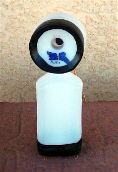

Here is a picture of the overall unit stood up outside:

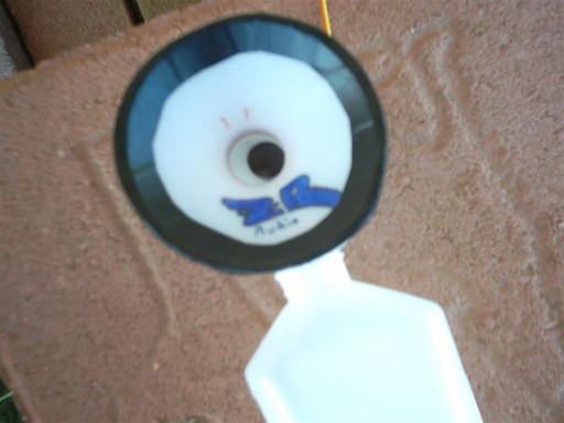

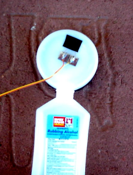

I am attaching photos to document the ultimate in DIY speakers: Homemade drivers using bottles and refrigerator magnets, as well as another bottle to create a sealed passive resonator enclosure.
I will reveal the type of magnet (manufacturer, shape and color) once my patent comes through, but it is available at Wal-Mart if you want to take a guess and experiment.
I also added a bit of decoration to to cones, adding my ZR (see my username 😉 )
