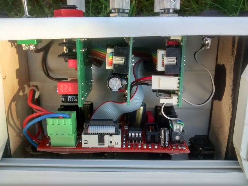

The result are 4 PCB-Modules that can be seen on the fotograph – an overview:
1. 2-channel Pre-Amplifier
Channel 1 with variable distortion potentiometer, ranging from total clean to medium distortion. A compensating circuitry keeps loudness constant over the full range so there is no need for an additional vol potentiomer to adjust loudness at different distortion levels.
With a switch or footswitch the 2nd channel can be selected. This one provides a fixed high gain distiortion. I call this the „hot“ channel or the „Gary Moore“ (R.I.P.) channel.
2. Fx Board
This acts either as a Reverb or Chorus utilizing Spin-Semi chip FV-1. With the chorus potentiometer set at minimum the reverb is active. The reverb potentiometer slides between totally dry and totally wet signal thus allowing extreme reverb effect as well.
Turning the chorus potentiometer clockwise switches to chorus and varies rotational speed of chorus. There are 2 LEDs indicating the current active potentiometer.
3. Master Board
Here you find master volume and sound potentiometer. This sound control combines a treble cut-boost control with a bass boost-cut control giving a wide sound variation with a single knob.
A 3.5mm jack can be connected as a line in for some external music from mobile phones etc. Otherwise this can be used as line out to connect to a PA-system.
To avoid harsh clipping of the power stage there is a soft clipping circuitry on board. This automagically adapts to actual supply voltage giving the maximum of soft clipped output power under all conditions.
4. Power Board
For a battery driven system the TPA3116/3118 from TI is hard to beat. It is happy with a single supply upto 24V=, does not require a heat sink, has a low standby-power consumption and is imho foolproof (over the years I did not encounter a single fail). The TPA3118 used here is set as mono amp in PBTL configuration giving the lowest possible losses. Gain is set to minimum for lowest hiss. Both inputs are driven symmetrically for best noise and sound performance.
Besides the class-d-amp a microcontroller (Attiny25) is implemented to control powermanagement. This includes a low-battery warning (LED blinking) at low battery voltage followed at the end by a forced low-battery shutdown to protect the Li-Ion accus from deep discharge. Additionally there is a deadman-function, i.e. after 15Min without any audio input the system shuts down. This prooved very useful for the elderly (like me).

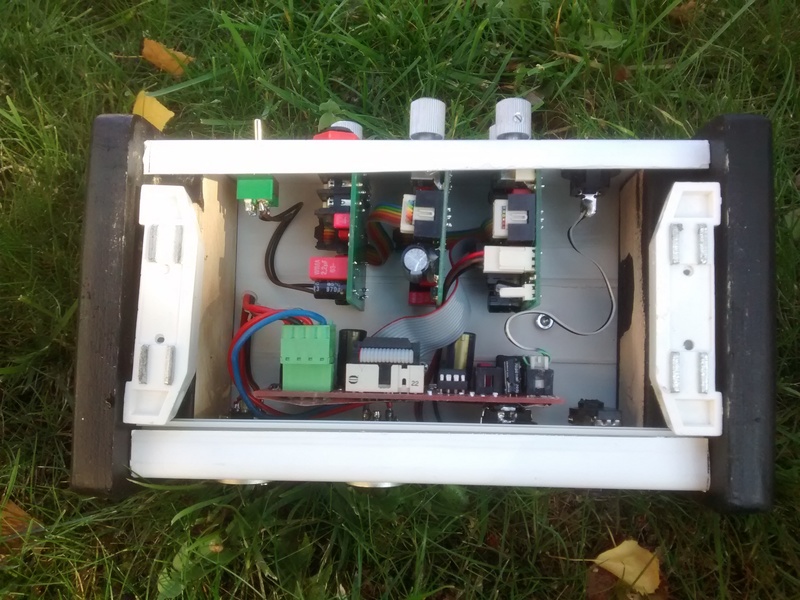

More pictures...

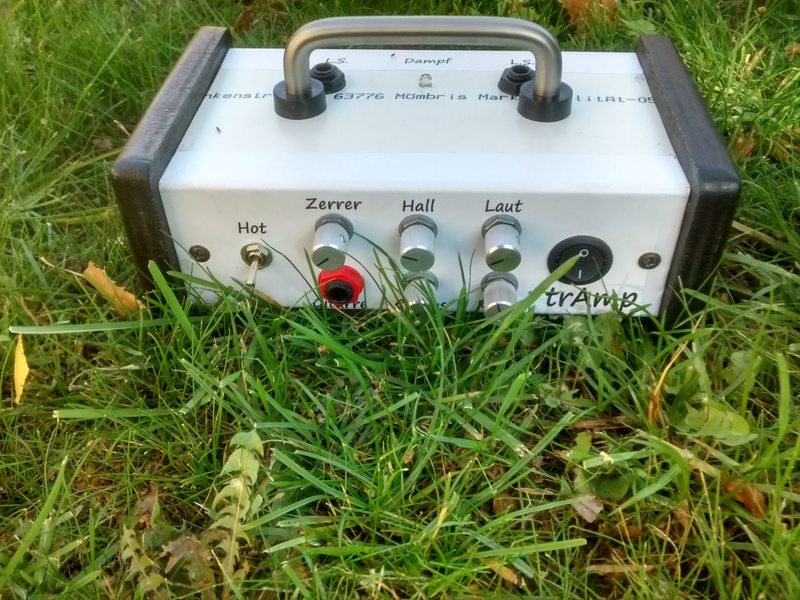

Enclosure
This top is based on a piece of rectangle cable pipe with wooden plates at both sides. Two strong magnets connect it with the lunchbox.
Labelling of Control Elements
The templates have been created with inkscape and printed with a black laser printer onto self-adhesive white label sheets.

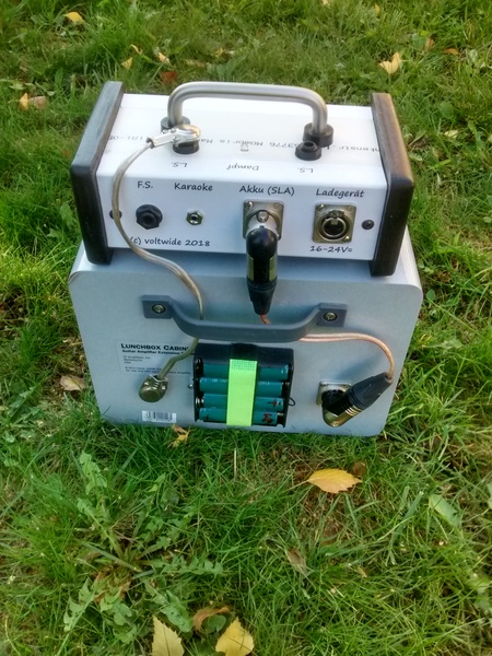

Rechargeable Batteries
Over the years I used S(ealed) L(ead) A(cid) batteries as these were unexpensive. But they are bulky and so I switched to 18650-Li-Ion-Cells. These are industrial standard found in any notebook-akkus, cordless-tools etc. With 4 cells wired in series an operating voltage between 14~16V is available. To avoid any headaches with charge balancing problems and achieve max lifetime I bought a 4-slot charger with 4 separate controlled charging slots and displays monitoring the status of each slot. So I recharged the cells that were to weak for my cordless drill and recycled them for this guitar amp, giving lots of acoustical power!
The Loudspeaker
Although I used the ZT-Lunchbox (i.e. the passive version w/o amp) I replaced the speaker with a Jensen MOD-15 (4 Ohms version). It fits exactly into the holes and pleases me more than the original.

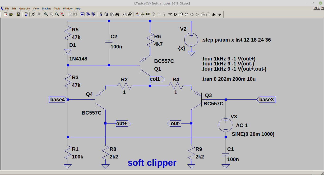

Soft Clipping
It was in the seventies of last century that I discovered the CA3080 in a RCA databook. There was a plot of the transfer curve and I knew instantly: This perfect s-curve is the one I was looking for to build the a fuzz box with a smooth transition from clean to distorted sounds. From that day on this was my standard part for many distortion modules.
When, after a long pause, I re-entered the analogue audio world, these chips were long gone. Although I have a small stock of NOS CA3080 I dislike the idea of designing in NOS parts so I had to look for another solution. Looking at its internal circuitry I decided to emulate it using some discrete parts. What remains is a bjt differential amplifier fed by a current source - no rocket science so far.
This circuitry is a perfect interface between the volume potentiometer and the analogue inputs of the class-d amp for several reasons:
-With emitter degeneration resistors close to zero the transition is the smoothest and at the same time voltage gain reaches its maximum.
-This comes in handy because a high gain behind the master volume potentiometer is a desirable feature in such a guitar amplifier.
-Output level increases linearly with supply voltage. Once set correctly the class-d output stage shows max possible soft limiting behavoiur over a range of supply voltage.
-On the other hand considering noise (hiss) a high master gain normally is a no-go. But as this discrete bjt amp stage exhibits very low noise voltage the overall noise is surprisingly low even at very low sound levels.
-the symmetric output is noise immune even with unshielded cable and fits perfectly to the symmetric input of class-d amp
The behaviour of the soft clipper can be studied using this simplified LTSpice simulation.
