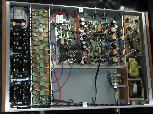

I went a bit overboard but I used separate windings for: input receiver, oscillator, filter, ea. DAC has 4 separate supplies (LT1085 and LT1036 , separate digital and analog) for a total of 8 supplies just for DACs with separate windings. Plus four windings for output stage. Total: 16 windings-8 trafos. Now ea. windings has 4 soft rec. rectifiers for a total of 64 diodes. I also used something like 24 caps for prereg. (off the PCB).
I didn't go balanced but I paralelled PCM 1704 (so I'm also using 4 of them). I also included output switched pot, so no preamp required. This was my first DAC and when I started building it I didn't have a clue about digital. Now I know a bit more and I'm ready for another, absurdly expensive DAC.😉
I will be participating in a project.

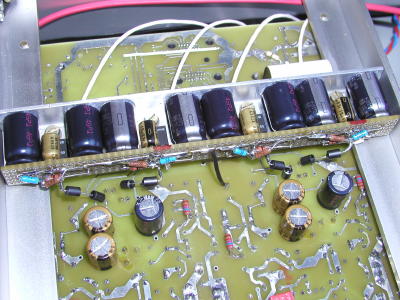

Here is a pic. The trafos on left are stacked one on top the other, so there are 6 of them. I also use split bobbin type, because they are better.😉 Right beside trafos there are 20 Sprague Extralytic caps under the PCB (so no see). Rectifier diodes are directly attached to the small trafos so no see either. On the right side under another PCB there are 8 more big filter caps.
This is the finest DAC I had and heard, period. The TT doesn't even come close (and I had Maple Noll air bearing, Sumico Blue Point Special and Ono as preamp). I replaced my Technics X1000 (which was CAD 8,000) and it's like day and night.
Lot's of tweaking and mods went into this design, but the key elements are separate supplies (including transformers) for everything, good oscillator and parallel PCM 1704K chips (also with separate digital and analog supply).
