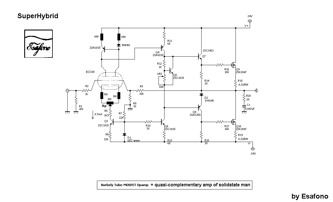

Stee Member Joined 2005 esafono.it 2010-04-25 10:49 pm #1 2010-04-25 10:49 pm #1 if you know how it's accurate the sound's scene from tube with two identical mosfet🙂 let's see this design Attachments SUPERHYBRID.PNG 18.5 KB · Views: 154
