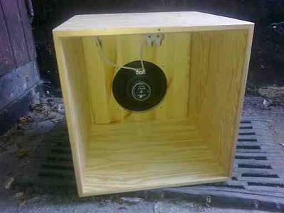

I found a bookshelf, 75x30x40 cm (HxWxD) and mounted a baffle, with the center of the cutout 55 cm from floor.
How did it sound? Awful. Not very much bass and far too much treble. Not recommended.
Next thing - I reversed the bookshelf, the center of the driver now just 20 cm from the floor.
This is good. Now there's bass, and it made several things in the room resonate, while I played Dave Holland's "Spheres". Dave Holland is an acoustic bass-player. The bass has a nice amount, detail and speed. And the "too much" treble was gone,as I now listen about 30-35 degrees off-axis (the driver situated 20 cm from the floor, me sitting 2½ meter away with ears at about 95-100 cm from floor). It simple create a balanced sound with sufficient detail and bass. I guess the bass has full level to about 55 Hz, due to addition from the floor - but from there the bass is very fast decreasing.
Another good thing: the bass seems to join the room with more muscle than a traditional 2-way stand-mount with roll-off at 55 Hz. The bass seems more present from the OB

Next thing was building easy and proper enclosures. I found some other bookshelves, 35x35x35 cm. Pics below
Note that you can rotate the box for varying driver-distance to the floor and in that way adjust the bass-level slightly. More adjustment can be done by changing the distance to side- and backwall.
Conclusion: These are keepers, enjoyable and very natural. I'm really wondering how those cheap drivers can produce that sort of sound 😀
