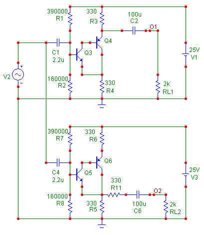

Hi everybody!
I designed a non original, very simple buffer/polarity switch, originally meant to be used as a first stage in a headphone amplifier. I’m not a EE, nor I have a formal (nor informal) background in electronics and this is my first transistor circuit, so I’m very embarassed to post something in the temple of solid state. So, please, be indulgent towards my mistakes. 🙂
The ideas (changed a bit over time) were:
Please note that the duplicated components in the picture are just for simulation purposes. If there’s something good in the circuit, I must say thanks to PRR; for the idea of using a Sziklai, thanks to Chu Moy and Millwood, all at headwize.com.
The simulated distortion is not bad, with 2nd, 3rd and 4th harmonics quickly decreasing. I’m aware that simulated figures are not very reliable (especially when they contain many zeroes) but, at least, this encourages me to build the circuit.
At 0.4 Vpeak output:
Inverting: 0.007 2nd 0.00016 3rd 0.00001 4th
Non-inverting: 0.009 2nd 0.0002 3rd 0.00001 4th
At 2V Vpeak output:
Inverting: 0.037 2nd 0.005 3rd 0.0006 4th
Non-inverting: 0.050 2nd 0.007 3rd 0.001 4th
In the simulation, the inverting output show signs of bad mannered distorsion after 5 Vpeak (3.5 Vrms), the non inverting after 4.3 Vpeak (3 Vrms).
- high input impedance, around 100k;
- low output impedance, around 200 Ohm (330 in the final version); load 2k Ohm or more;
- same gain, input and output impedance for both inverting and non inverting output
- at least 2Vrms of voltage swing.
At 2V Vpeak output:
Now, some (I’m afraid eventually stupid) questions.
- The Sziklai has huge current gain. For biasing its base I used much smaller resistor values than those would be needed. The idea was that too a high impedance would make the circuit prone to RF. Is this a good (or bad) idea? Is this enough not to catch RF? (Provided that the supply rail be properly decoupled)
- Is there a risk of oscillation and need of using a “gate stopper” like if the Sziklai were a mosfet?
- Is there something else wrong with the circuit?
- Could it be improved with a current source? (I guess it would destroy its simmetry.)
- Is the voltage swing big enough to use the circuit as a preamp for modern sources?
[/list=1]
Thanks a lot for reading as well as for your answers.
Massimo
P.S. I had so much fun with this circuit, much more than with opamps. Who knows why… 😀
Hi Massimo
It might be a good thing to add a resistor from the collector of Q3/Q5 to the positive voltage source. Otherwise the collector current of Q3/Q5 is only the (small) base current of Q4/Q6. Better if it is at least a mA or two.🙂
Hi CBS240,
thanks for your kind answer!
To be sincere, having looked at the TIP120 datasheet and having read... Wikipedia... 🙄 I had the impression from the beginning that the resistor you mentioned was needed. But my very poor math skills and the encouraging yet probably inaccurate simulation results made me overlook the problem.
Anyway, would you please allow me some time to see if I can compute by myself the new bias resistors? Then I'd be very grateful if you could check my math... May I ask your help once again?
Thanks anyway 🙂
Massimo

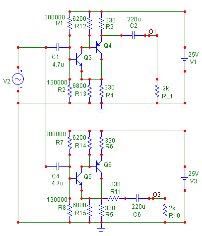

No math, only sim
Hi CBS240,
since failing is an art, I decided to take the shortest path to failure, i.e. to simulate without knowing exactly what's behind (yes, I need to do more homework...).
Anyway, the result is the attached circuit, 1.2 mA through Q3/Q5. The simulated distortion shows a marked improvement for the inverting out, less for the non-inverting. The improvement should be more marked near the clipping level. Here are the figures, hopefully not entirely meaningless...
Inverting: 0.005 2nd 0.00008 3rd 0.00001 4th
Non-inverting: 0.008 2nd 0.00017 3rd 0.00001 4th
At 2V Vpeak output:
Inverting: 0.025 2nd 0.003 3rd 0.0003 4th
Non-inverting: 0.041 2nd 0.005 3rd 0.0008 4th
I also attempted to increase current to around 2mA through Q3/Q5, without any (simulated) improvement.
Good enough to build?
Ciao,
Massimo

Hi
I guess the idea is to switch the load from one side to the other? To me, this circuit is known as a feedback pair. For just 2Vp, why use 25V? If your intent is to bridge two amplifiers, there may be issues.
What is the source and the load intended to be? TIP120 is not that great, IMO, unless you’re using them for a switch.
I think op-amps would be a better way to go with this signal level. If you want to make a phase splitter circuit, op-amps can be good there too. If you need a very good phase splitter, there are great IC's that do that task and are simple to implement. I think THAT corp. makes one, I'm sure there are others. I made a discrete phase splitter circuit w/gain that will way out do anything you can make with op-amps, but it's a bit complex.
Sort of a ‘discrete op-amp’ project. 😛

Hi CBS240,
first of all, humblest apologies for misleading you with my unclear schematics and even worse explanations. 🙄
Yes, the circuit is a simple phase splitter where the load (the 2k resistor) is connected to the circuit through a switch that takes the signal either from the emitter or from the 330R resistor connected to the collector of the BD140; the 330R resistor is there just to raise the impedance at the same level of the inverting output, so the gain of the two outputs shall be the same for any load.
Why two copies of the circuit in the attached schematics? Just to be able to simulate gain, impedance, etc. together for both the inverting and the non inverting "mode" with the same simulator file.
Other apologies for mentioning TIP 120 and...Wikipedia. The TIP 120 Darlington datasheet shows two resistors connecting base and emitters of the two transistors. Wikipedia recommends to use a similar resistor on the feedback pair too, that (I think) would solve in a slightly different way (introducing some feedback) the "minimum current" problem you mentioned. Anyway, thanks very much for the advice! Do you think I correctly implemented what you proposed? Please note I added also a 6800 ohm resistor in parallel to R4, just to equalize the gain for both outputs.
Source and load. The circuit should be connected as follows:
Source (CD, FM Tuner, tape deck or phono preamp) -> Potentiometer (e.g. 25k) -> THIS CIRCUIT -> phase switch -> output selector switch -> crossfeed followed by headphone driver OR power amplifier and speakers.
I think most modern sources should not output more than 2Vrms (maybe this could not be true for phono preamps), so I "tuned" the circuit to clip just over this level. Am I right?
The crossfeed is a acoustical simulator for headphone listening that mimics the "mixing effect" that happens when we listen at speakers, with the left ear hearing most of the sound of the right speaker and vice-versa. The "mixing effect" is simulated though a R-C network and serves the purpose of avoiding the "super-stereo" effect of headphone listening. This is the circuit:
http://www.meier-audio.homepage.t-online.de/
For optimal frequency response and optimal crossfeed level, the component values must be computed (see formulas in the page linked above) starting from source impedance (the 330 ohm of this circuit) and load impedance (the headphone driver). This is the reason for "equalizing" the impedance of the noninverting output with additional 330ohm resistor. This way, the behaviour of the crossfeed would be independent on the phase of the signal.
The reasons for doing the polarity switch this simplistic way were (1) the curiosity of seeing how far I could go with a single transistor (yes there are two...) using a lot of quiescent current (20mA) and no feedback, (2 - most important) my ignorance about solid state design. When my math shall improve, I'll try something different but, all in all, this is a start... 🙂
Ciao and many many thanks!
