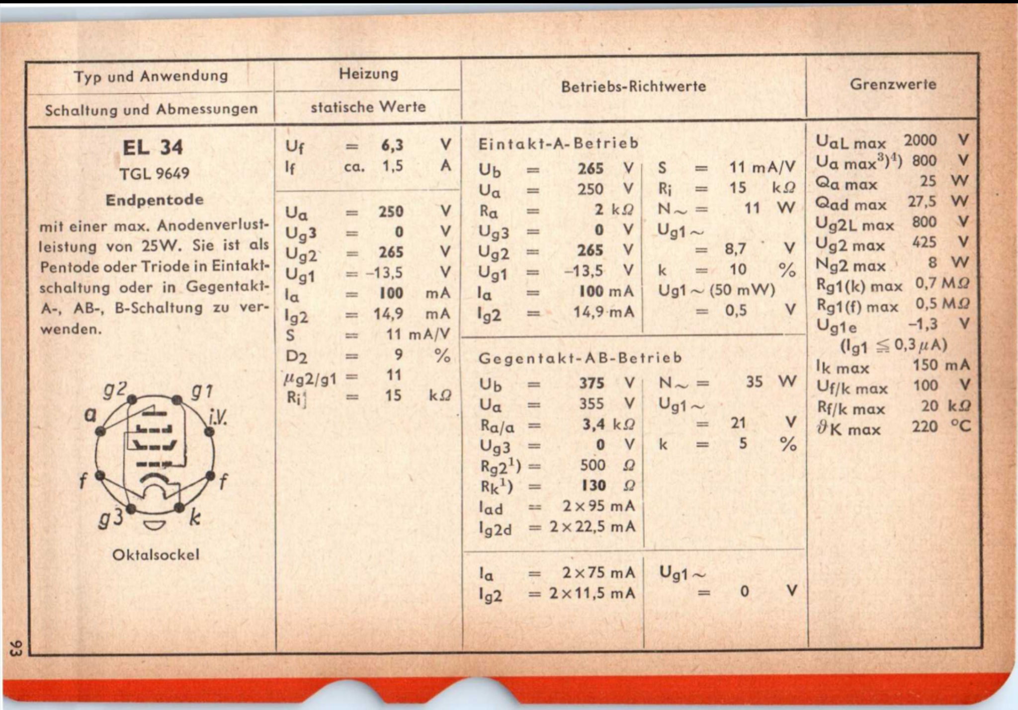

Here's the EL34 from their 1965 catalogue:
Merriam Webster defines a "catalog" as "a complete enumeration of items arranged systematically with descriptive details" and lists "a catalog of the company's products" as an example.
Maybe you want to discuss the semantics of the word "Röhrentaschenbuch" next?
Reactions: jean-paul
