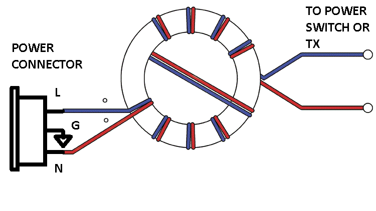

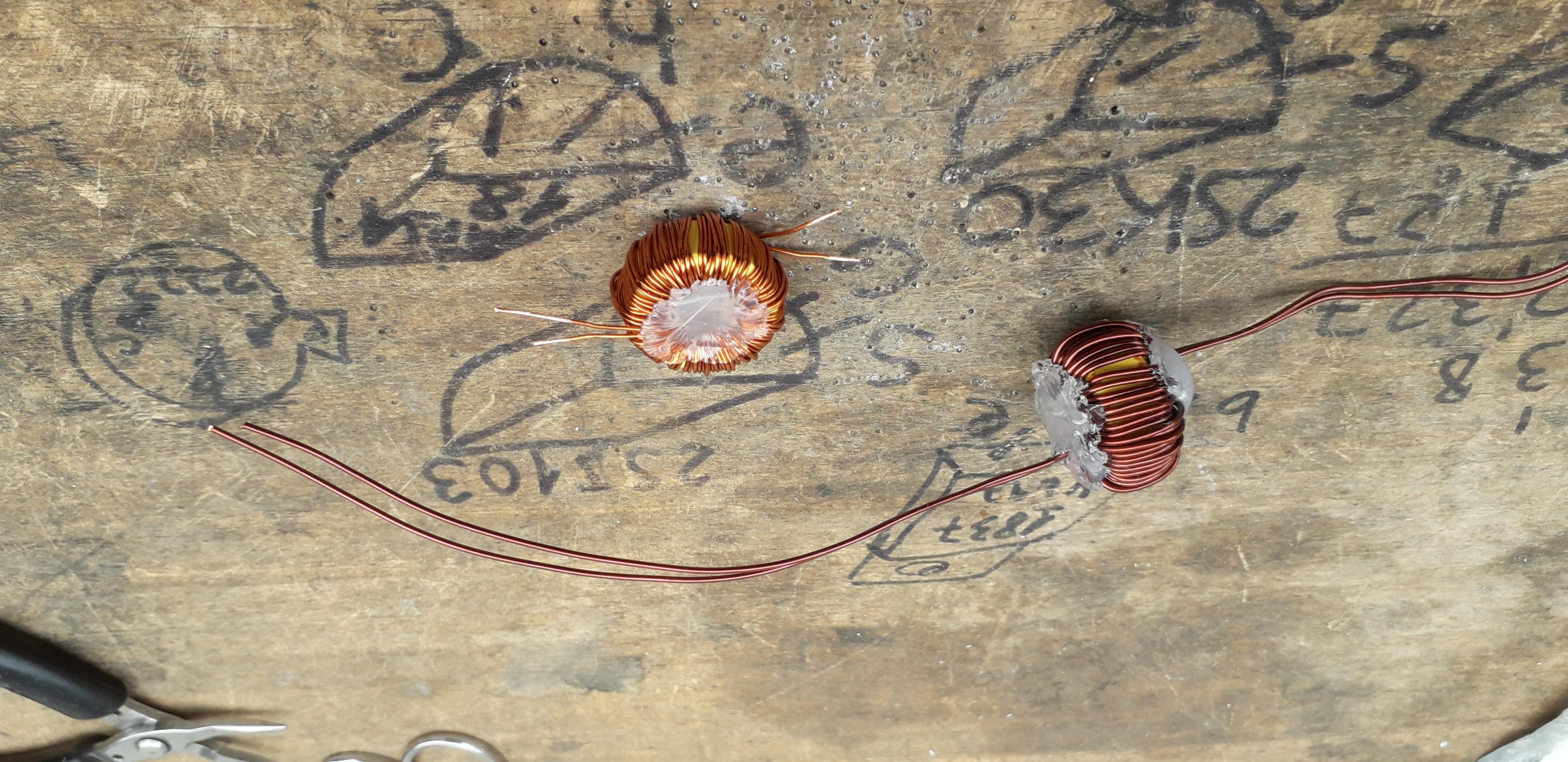

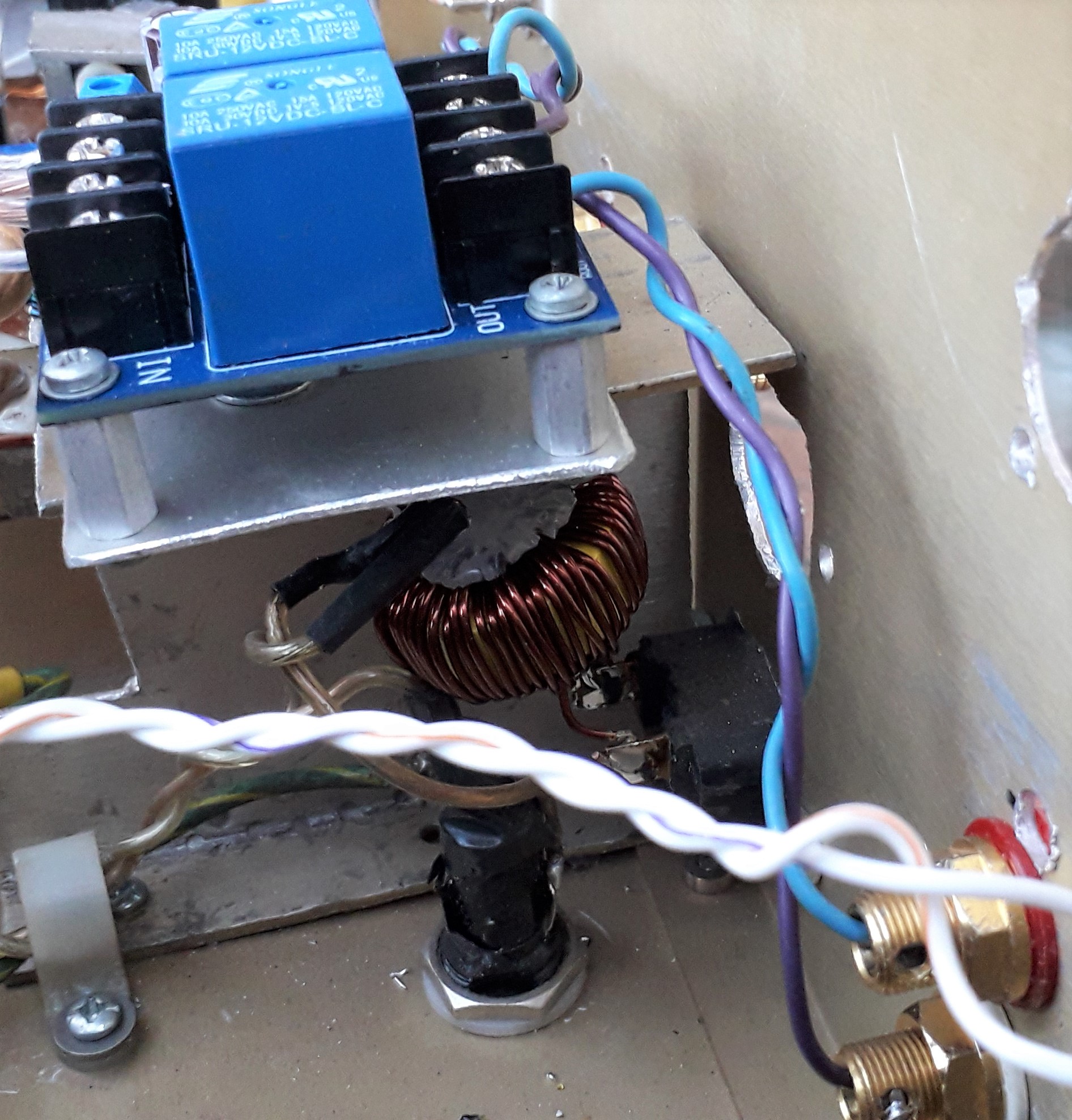

The "Reisert Bifilar Balun" for Power Supplies.
I propose a trick that I learnt in my early days as DIYer, extracted from a pro site dedicated to digital transport upgrades, and which I used to use only in "dirty" SMPS for digital sources but which, with time, proved useful also for linear supplies and for analog sources (mi Otari R2R) and also with my Amnesis amplifier. It is the Joe Reisert type of Balun, with bifilar winding. The optimal is built using high Q ring core, with a material that can reach tens of KHz, using OCC enameled copper wire, BUT, it also works with ferrites rescued from SMPS' and common type enameled copper.
I am sure the experts will opine on the merits or the demerits of the idea and maybe some will try it and even measure it. 😉
I've been asked how many turns for the "Reisert Bifilar Balun"?
Based on recent listening, I believe the more the better. I will probably re-wind some and see/listen.
I appears that R and C vary with N (n° of turns) but L vary with N squared, which apparently brings the resonant point lower...I hope this is a good thing 😱
Anyway, there you have probably the best and cheapest upgrade of them ALL.
Best wishes,
M.

We call this a common mode choke. A bifilar winding with single insulated enamelled wire connected to mains supply is a call for a burning house. You should better keep your hands off mains circuits.

Yes, if you want to make a CM choke for mains use then you need thicker insulation.
A bifilar-wound mains choke has full mains voltage across two thicknesses of enamel, unless something gets damaged when winding (or in use) in which case it is one layer of enamel. Further damage means no insulation.
A traditional toroidal choke may have a number of layers and hence the voltage appears across several thicknesses of insulation. In addition, it will normally not be mains voltage but merely the voltage drop across the winding. Don't compare apples with oranges and lead people to do unsafe things.
Notice the windings are kept separated so L & N are not wound on top of each other without proper voltage isolation. Very unsafe example in first post.
:att'n:Mains wiring safety must be considered a top priority to prevent events such as shock or :house::flame:.

Referring to your first posting- I think you missed the point that the DIY-chokes were wound in a bifilar way, but the ones you presented were of the sectional winding type - which is in fact the common and safe technique for mains common mode chokes. That makes the difference we are talking about
The point is that it really does not matter the winding/insulation method if an appropriate series fuse is incorporated in the primary circuit.
Voltage rating of standard enameled wire is around 600V, one has to be really careless in winding operation to cause two adjacent insulation faults that could cause primary SC fault.

No, it does matter. Btw, standard enameled wire withstands 500Vdc. But mains filters have to withstand 230Vac plus much bigger transients as well. Whether you like this or not. And for that reason you will find no commercially cm-chokes with bifilar wound standard magnetic wire.

At the risk of adding a "toxic" opinion to this thread, I have to clarify this statement: ferrites used for suppression purpose in CM filters normally have a high permeability, and a high DC/AC conductivity: for example the T38 material in the Epcos classification or 3E3 for the Philips/Ferroxcube system.
These are MnZn ferrites, and for a voltage like 230VAC (or even 115VAC), they look like a short, because of their VDR properties they owe to their metal-oxide nature.
The toroid used in CM filters is normally covered with several thick insulating layers of lacquer to prevent any breakdown, but even so, I have seen a few examples where the insulation failed, causing a meltdown of the ferrite core (and a blown fuse, fortunately).
Some US and Japanese-made ferrites do not exactly fall into the MnZn category, and have properties in-between NiZn and MnZn materials, but at high enough voltages, they still behave as VDR's, even if their DC resistance looks infinite.
This means that all ferrite cores should be treated as conductive, except for extremely low voltages.
The enamel of the wire can just provide functional insulation, not safety insulation.
Several additional barriers are required for safety insulation

No such animal. All magnet wire has insulation, and there are many different kinds of insulation and voltage ratings for such insulation. Finer wires typically have to have thinner insulation and thus a lower rating, but only the datasheet for the actual product will tell you chapter and verse. There are classes for temperature limits for insulation too.
You certainly can't expect some random ECW to be rated for mains transients, bifilar or otherwise.
"Around 600V" isn't a rating! Its certainly not enough for mains equipment where multi-kV transients due to equipment or lightning are expected.
