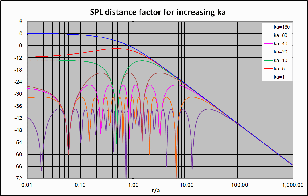

It looks to me like John K's analysis shows the answer well in graphical form.
Techtalk Speaker Building, Audio, Video, and Electronics Customer Discussion Forum From Parts-Express.com - View Single Post - The Real Farfield Measurement Distance
If you are above r/a = 1 (or certainly by r/a = 4) then you are in the farfield and level is dropping by 6 dB per doubling of distance. R is distance from source and a is radius of source. 4 radiuses or 2 diameters distance is sufficient.
Now, a cabinet radiates from its edges, so that should be considered as part of its size if you want very high accuracy, although it is probably a minor factor. With multiway systems you also need to consider the distance required for the far field geometry to hold. That is, the distance where the path length differences between drivers is near enough to the far relationship.
Certainly, if you achieve twice the long dimension of the cabinet you have covered every factor.

Dave, I think that the point of my doing the math (which is pretty much in agreement with John's graph) is to look at the actual error that exists. Of note, I ran this by John prior to posting it though I can't vouch that he looked at it in detail).
I think that there is some confusion regarding farfield. In fact, when I have looked at modeling papers, the Rayleigh integral is felt to be inferior in it's model of farfield to BEM modeling, particularly at higher frequencies.
The most current AES measurements standards state that "this implies that the measurement distance from the acoustic center of the device
must be large with respect to: (1) the largest dimension of the radiator, and (2) the square of the largest
dimension of the radiator divided by the wavelength of the highest measurement frequency."
If one was to use an enclosure that was .6 meters tall and .2 meters wide, the longest dimension (the diagonal) would be .63 meters. Using the 2nd criteria, if you measure to 20,000 Hz, this would be .63^2*20000/344 or 23 meters. This made no sense to me. Even using half of this dimension, assuming the driver is centered on the baffle, it would be 5.76 meters to FF. Using just the driver, itself, let's say a 1 inch tweeter, the calculation would be .0254^2*20000/344 or 37.5 cm.
Looking at the table that I set up, at 38 cm, you could measure to 20Khz with .2% error. If you use the 63 cm size (of the enclosure diameter), at 20kHz, there is an 8.8% error at 23 meters.
John's graphic seems to be more in line with the use of just the driver. It also suggests that what we are using for our definition is also more along the lines of the driver. The enclosure provides a reinforcement of the sound signal starting with a frequency equal to the longest distance of the driver to the edge of the enclosure and ending with a freq equal to the driver distance to the shortest part of the enclosure. The distribution is based upon enclosure shape, reflectivity, etc.
Your suggestion of using twice the largest baffle dimension is likely to always put you in farfield by my calculations, but it is another rule of thumb that I was trying to get away from. I was trying to understand the why. As I mentioned before, the Rayleigh integral is not exact, but it at least provides an understanding of the cost/benefit ratio of a measurement distance along with one's window length calculation.

Is that 3% in pressure? That would be about 1/4 dB. I would suggest you expand your spreadsheet to include dB conversion of results and even go to a more standardized presentation of graphed dB vs. drawaway distance. That is the best way to view it
As I looked at John's graphs a bit more it is clear that, below a certain frequency, all the nearfield curves merge. The nearfield effect is strong but independent of frequency. It is only higher frequencies where frequency becomes a factor at all. This is where the generalized frequency independent notion come from. At low frequencies,nothing matters but size. At high frequencies the circular unit must be considered as anular rings of potentially different phase (like my multiple point sources) and until you are far enough away for all rings to be in phase you will see a lower nearfield condition.
Still, if we cross from a large source to a small one at HF we are taking a large step in keeping the nearfield effects of HF nullified. The end result is that a typical system is still well represented at a distance of 2 or 3 diagonals away (line arrays excepted).

I see. It is % error of the dB vs expected dB for that step. It is a per step rather than cumulative error.
You would still be better served by showing total dB deviation relative to a point source with the same far field pressure. (as per John's graphs, the various curves can be directly compared to the 6dB per distance-doubling asymptote. It shows what you want to know: "what is my level vs. distance and where does it deviate from the ideal as I get closer to the source".
I can also look at John's graphs and see where the error hits 1dB or 3dB, which is what I really want to know.
David S.
David S.

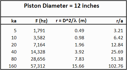

I'm not totally sure how this reconciles with John's graphs that show the transition point to be essentially independent of frequency (the curve shapes below that are certainly different, but the transition frequency is not).
If you plot up additional curves for increasing ka, you will see that in fact the transition point is dependent on frequency and in line with the second formula given in the AES measurements standards: “(2) the square of the largest dimension of the radiator divided by the wavelength of the highest measurement frequency."
As an example I attached a table with calculations for a 12” diameter piston. You can see the calculated transition distances for each ka value correspond well with where the curves merge in with the -6dB slope. A derivation of this far field break-point formula can be found in the AES paper "The Acoustic Radiation of Line Sources of Finite Length" by Lipshitz & Vanderkooy.
AES E-Library The Acoustic Radiation of Line Sources of Finite Length
I’m not sure how relevant this calculated far field transition point is for a 12” woofer which probably won’t be crossed over above 1kHz and most likely wouldn’t be radiating uniformly out to the cone edges. But for line sources made up of small drivers, or large area radiators like ESLs it is a good guideline. When designing ESLs, you often have to take into account that typical listening distances will place the listener in the far field relative to the width, but near field relative to the height.

When recalculating the sound field at 10 meters for say a 12” pulp cone woofer, is the cone assumed to be perfectly rigid?
Or can you include the behavior of the woofer cone as far as shrinking of source size.
Dave, it is a cumulative error. You do not see that it is being compared to a half distance as this portion of the calculation is not visible.
Earl, thanks for jumping in. Is there any way to calculate this out using your method in such a way that anyone would be able to identify a relative error at different points with different drivers? If not, is my approach within a reasonable error range? If not, any suggestions as to how I might make it so?
bolserst, as you pointed out, the curves do asymptote but not quite as early as it appears on John's graph. Where the curve joins the asymptote appears to be frequency based.
Jay
Jay
Since we are talking about measurements of real speakers then it doesn't matter what that speaker does, it will be accounted for as long as the number of terms in the expansion is sufficient to cover it. From what I have done, I see no differences in the data beyond about 16 terms up to about 10 kHz.
