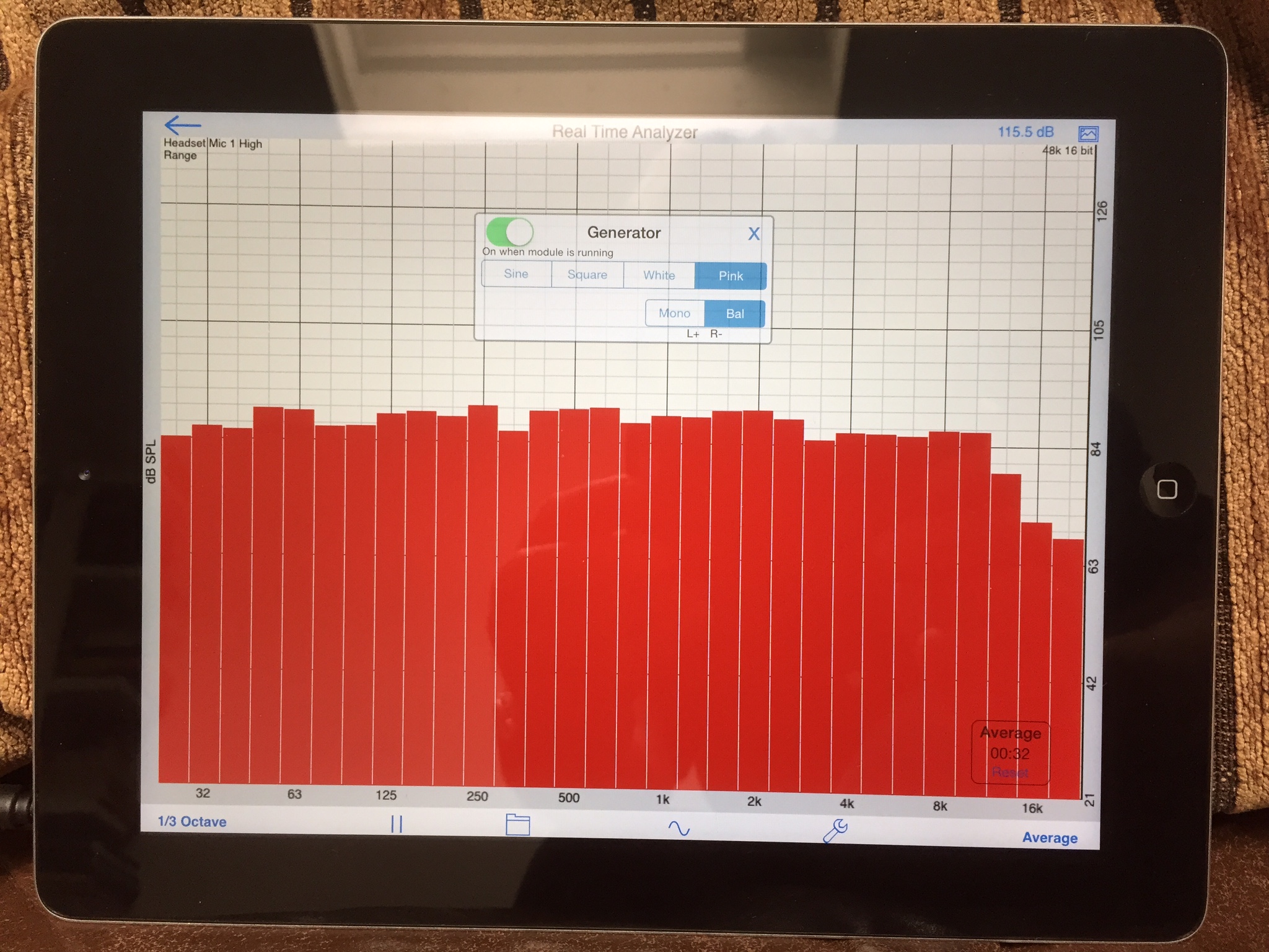

I'm running the Lowther DX3 in a PAP setup.
Measurements with iPad and Dayton mic Callibrated. These are in room !
I do not mis much in the bass.
No active XO !!

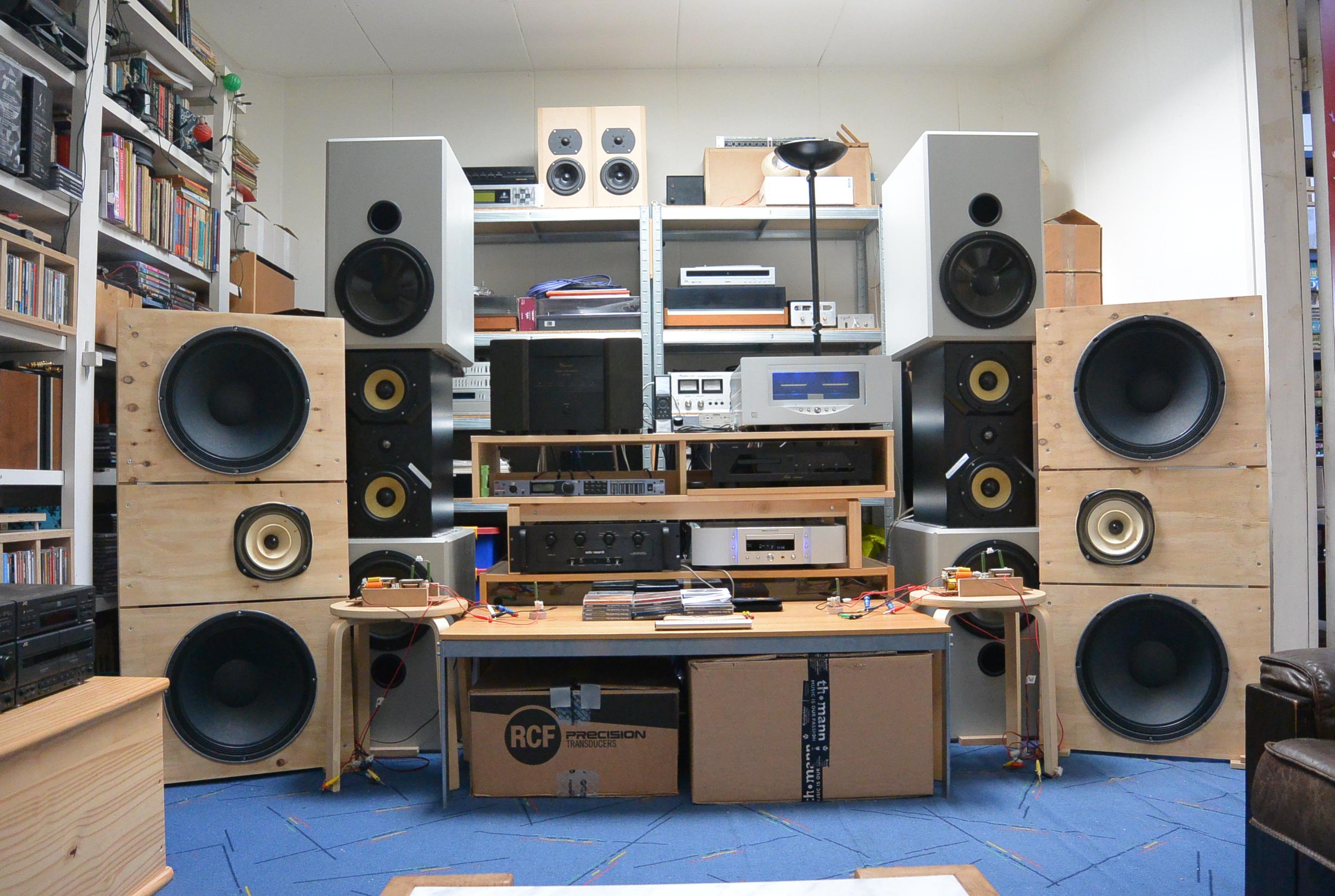

Not exactly dipole either, what with all the 'clutter' taking up space behind them as well as creating an incredibly dense reflection field, which BTW is IME the best overall way to make a dipole 'sub' system.
GM
Had them free standing in other room ; not much difference so. Measures about the same. Took this photo just to prove (to some guy) that I was able to A-B two large systems. The other system is with 2x 11 inch Eton bass down to 25 Hz (these are with dbx driverack PA & 6x 250 watts).
Feeling silly after doing OB setup ; there is NO way back to conventional system !!
It's just more musical and audiophile.
