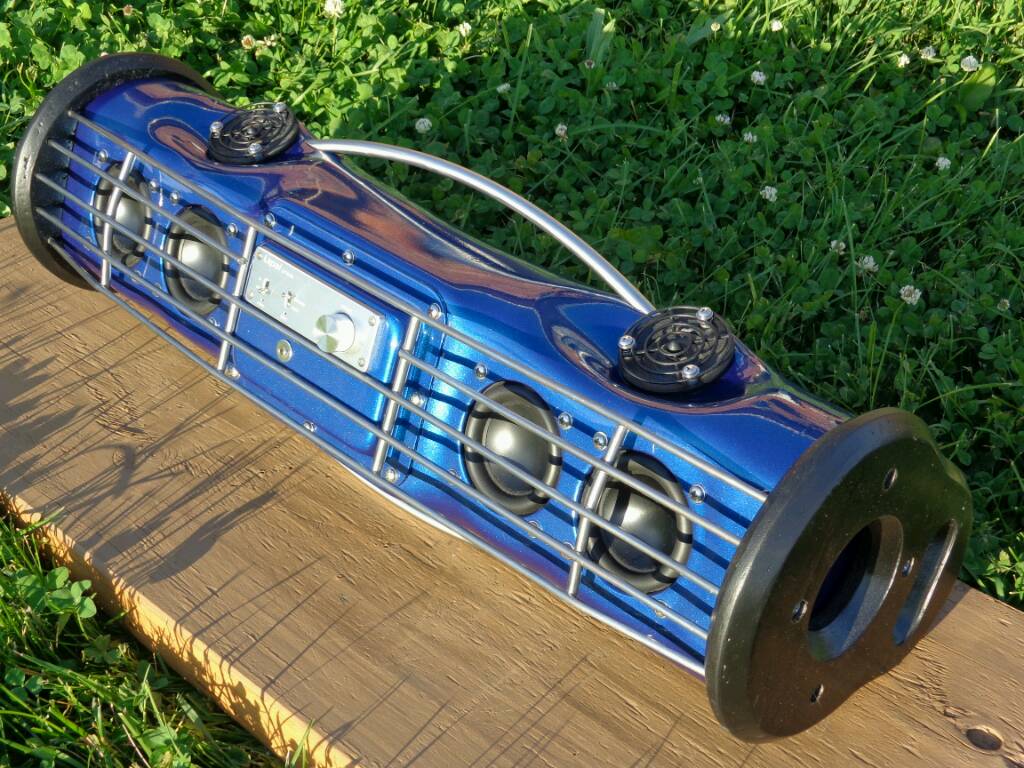

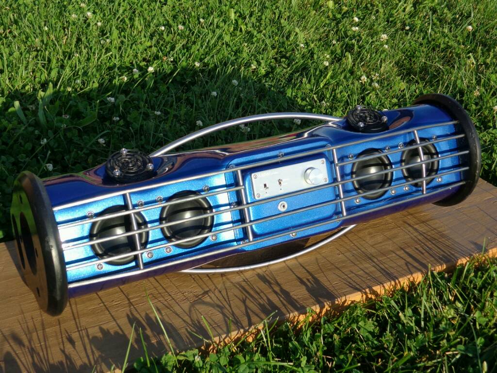

Here's a close up of the tweeter.... I cut up a computer fan grill and used spacers and washers to make the grill.
Well, it ended up too pretty to be a " jobsite stereo " but I'm still pretty happy with it 🙂. What do you think?

How it sounds?
Like your twetters grill😉
Super nice design
Good question.… 🙂
Pretty good....
It does still need a little EQing ( I'll add that to the crossover ), but after that... I am very impressed! Those little Dayton 3 inch drivers will really move some air! And the Vifa tweeters, well they are Vifa tweeters, nice and natural, and do match up with the woofers pretty well.

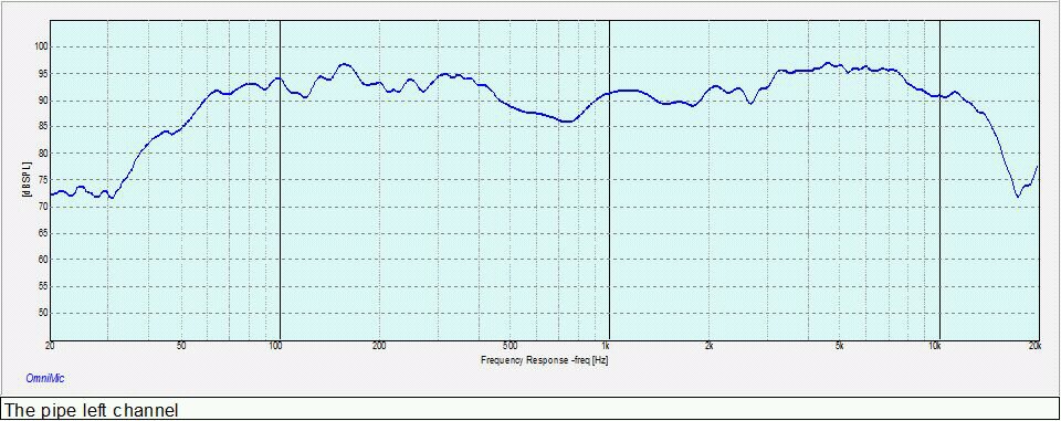

The tweeters are 7dB louder than the woofers and I have no traditional ( l-pad, series resistance, etc... )attenuation on them. Since the tweeters are pointed straight up, the listening position is 45 or so degrees off axis, so that makes them a few dB's less. The rest of the efficiency mismatch is handled with an odd second order crossover alignment which starts the roll off real high ( which also helps with the very top end rolling off from being so far off axis ). Actual crossover point is about 2K and the tube is 6 inches in diameter, so the end result is actually omni directional... Which is pretty cool.
Oh yeah, " how does it sound?"
Surprising! This little pipe can sound quite big. Low end response is good to 45Hz or so ( just by ear so far, I haven't measured it yet.... I'm lazy 😉 ). Without EQ it's still a little bright on the top end and it could use a little bass boost but something I'll be able to take care of with the crossover. Output is incredible, gets way louder than I will ever need, which is a good thing 🙂. At reasonable levels it does have a nice laid back natural sound, with a surprisingly wide soundstage.

Well, I finally got around to measuring the frequency response.
Not too bad, the big dip at the top end is because of the tweeters being so far off axis. I'm still going to make another crossover which will include a 4 to 6dB drop starting at 60Hz up to 13K, which will extend the bottom end and help even out that dip at the top by sacrificing efficiency. I have plenty of power and I think ( hope ) the woofers can take it. That is, if I can get it to fit in the little space available, components could get big,lol.

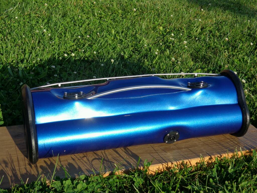

Oh yeah, after over a month to let the paint cure I polished it a gave it a coat of wax. Looking good...

Excellent build!
I feel so inspired after reading this thread, and the one leading up to it! Really impressed how you have sculpted the pvc pipe. I had no idea this was possible!
I plan to make a speaker like the Sonos play 1, and your design and way to create an enclosure is my start point!
One question: it looks like you have a pipe laying parallel behind the one holding the speakers. Is that a separate pipe or a sculpted part off the main pipe?
Another question: do you have ports in the enclosure, it is it just details..?

Thanks PeterRP and Charles Darwin.
To model the enlosure tuning I used Bass Box (really and modeling software will be fine, just a simple ported box... Figuring out the enclosure volume and port surface area is the only tricky part). To verify everything I used a DATS system.
I used Gorilla Glue to glue the PVC together. All the seams are reinforced with Bondo.
The biggest tip I can give is don't force the PVC to much. It will want to crack.
