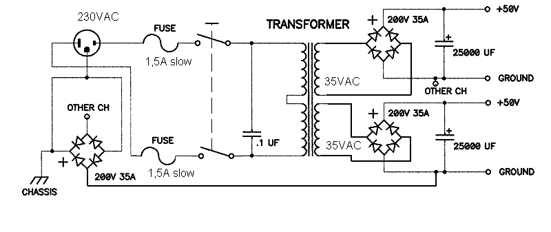

PSU for my ZEN4?
I am going to use a 500VA 2x35VAC transformer for two channels.
Could someone draw me a wiring diagram about what is the best way to wire my amp to prevent ground loops and other unwanted effects?
Make it simple because I have pratically any EE studies.
