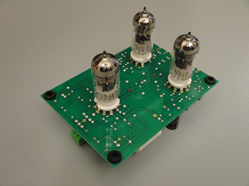

As you might expect, the internal structure of the Orpheus preamplifier is composed of several sections. The first is a proprietary board that I created a few years ago.
Below is an illustration of the MM phono preamplifier board...
Those interested will find information, numerous details, and illustrations in an article dedicated to this circuit here: Marantz Replica MM Phono Preamplifier

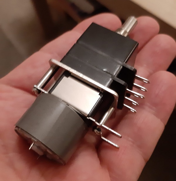

The volume control uses a motorized potentiometer from TKD (Japan).

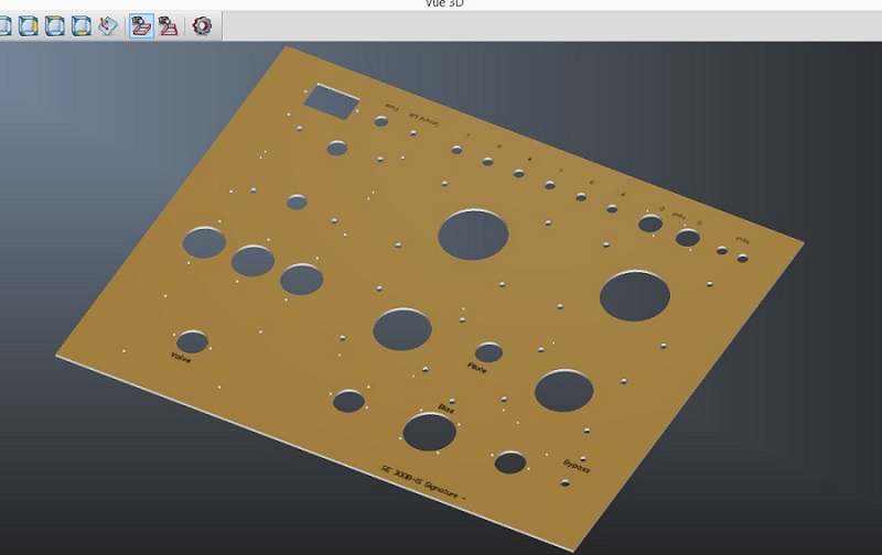

Once installed, and after considering the components to be used, the dimensions, and the general layout, I was able to begin and then finalize the construction of the upper plates.
The Orpheus preamplifier plate...
The Orpheus amplifier plate...
