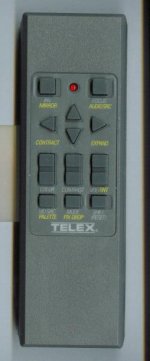

The M2X Manual in my hands describes as follows;
QUOTE]The video in jack is installed on all models of the M2X; however, it is only active when the video option is installed.[/QUOTE]
To check if it is installed,plug in the VCR or other video souce to the composite plug and press VID SRC on the M2X keypad to select either the computervideo or the composite video from the VCR.If the option isn't installed I guess the VCR ignal won't be picked up.
Now to my problem.I have the MAC VGA cables instead of the IBM and need the pinout for the IBM VGA cables.
Also, anyone needing info from the manual, just ask.
(VF) addition, usually when the video option is installed you will see a TV sticker on the bottom of the panel.

How to make a power supply?
Buy a old laptop PS or anything thats 15V and at least 2.7 a.( it can be higher in AMPs ONLY, mine is 3.0 a) Now your going to have to check the polarity of the plug and its size( previous pics) once you see if its center Negative or Positive, If its POS then Just take the wire Clip it about 6 in from the barrell plug and strip the wires about 1-2 inches on either side, pay attention to how the wires were connected first and then reverse them, Use electrical tape to cover the exposed wire and wrap it all tight, to test use a voltmeter to make sure you got the polarity right. Or use a old Computer fan and remember Black is Neg and Red is pos The Center of your Final Power supply should be neg so stick the black wire inside and touch the red wire outside if it powers you have everything correct if it dosent Switch the wires. and thats about it for that.
Have a probelm Like it's not displaying anything????
Or there are rolling black bars, you have your Computers resolution set to high right click on the desktop and go to properties and then settings and you will see the display bar, pull it to the left and make the resolution 640/480 that should solve your problem.
The screen is shifted to one side?
Use the 4 way arrows to move the image around to center it.

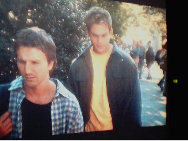

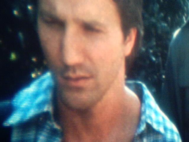

Those are some pretty good pics, I also own a magnabyte m2x. I would post some pics but my ohp is complete crap. Im gonna make a diy projector with my beast of a projection panel and a metal halide etc... now that i finally got a job i can afford it. I will post mass pics when i get to workin on it. keep posting!
Hey yea Its a nice panel, Not as Nice at My XGA projector But Better then a projection tv. Anyways I just looked at the last pic I uploaded and It uploaded really crappy, In real life its much crisper and richer( LOL the pic looks like its from a newspaper) guess thats what you get for a 40.00 dig cam without flash etc. anyways yea post pics here and if you have anything to add to the faq ad away, so hopefully this will help people a lot sometime in the future. L8er
