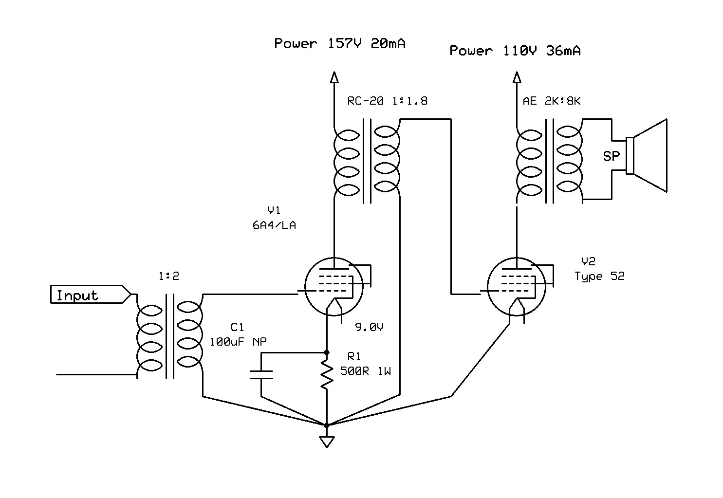

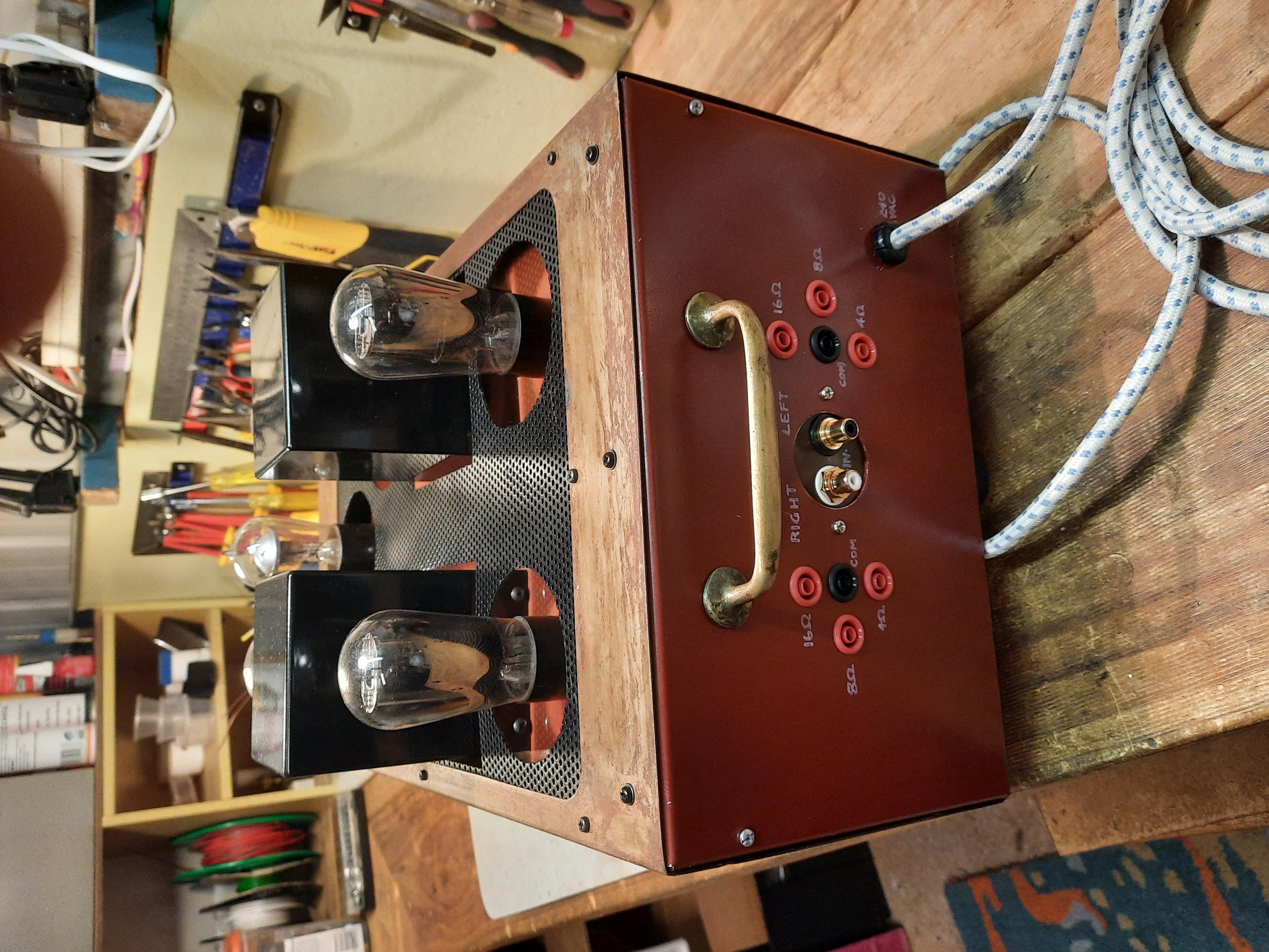

Every valve is well over 80 years old. The rectifier is a cold cathode Raytheon BH circa 1929, the input valves are Raytheon LA pentodes configured as triodes, circa 1931. The output valves are 1933 Raytheon type 52 dual grid power triodes operating into 2kOhm and biased at .... 0V. Shades of Motorola car audio circa 1933 ....

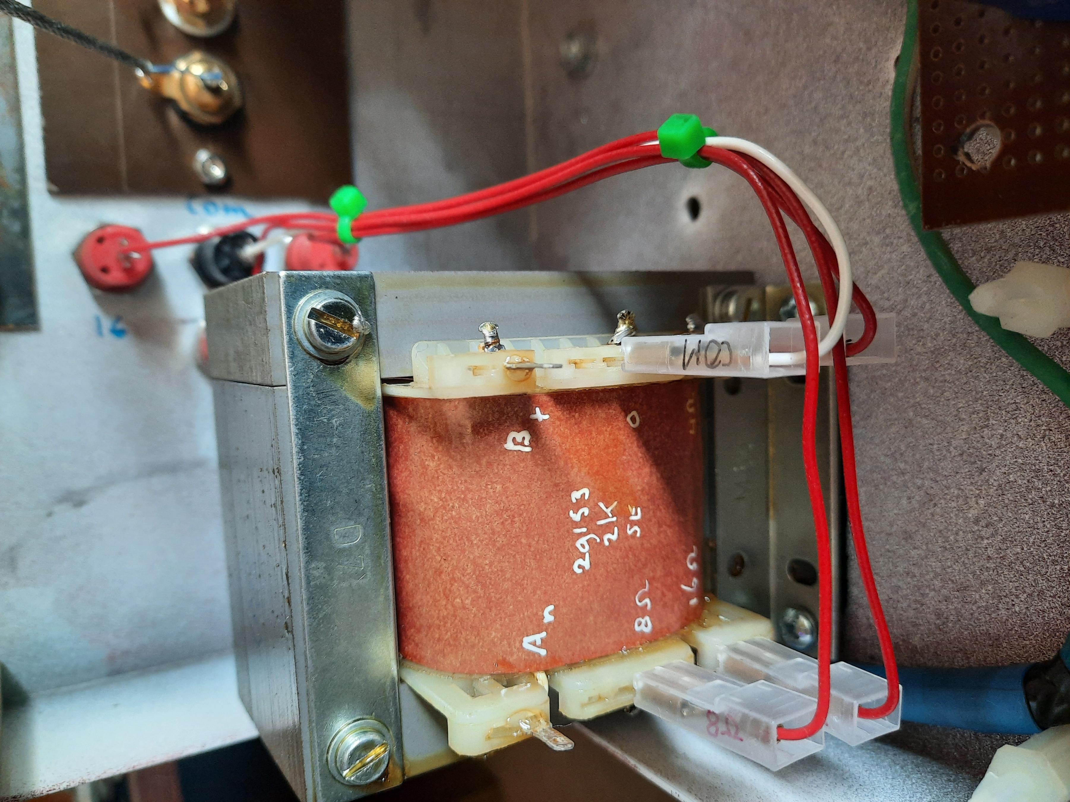

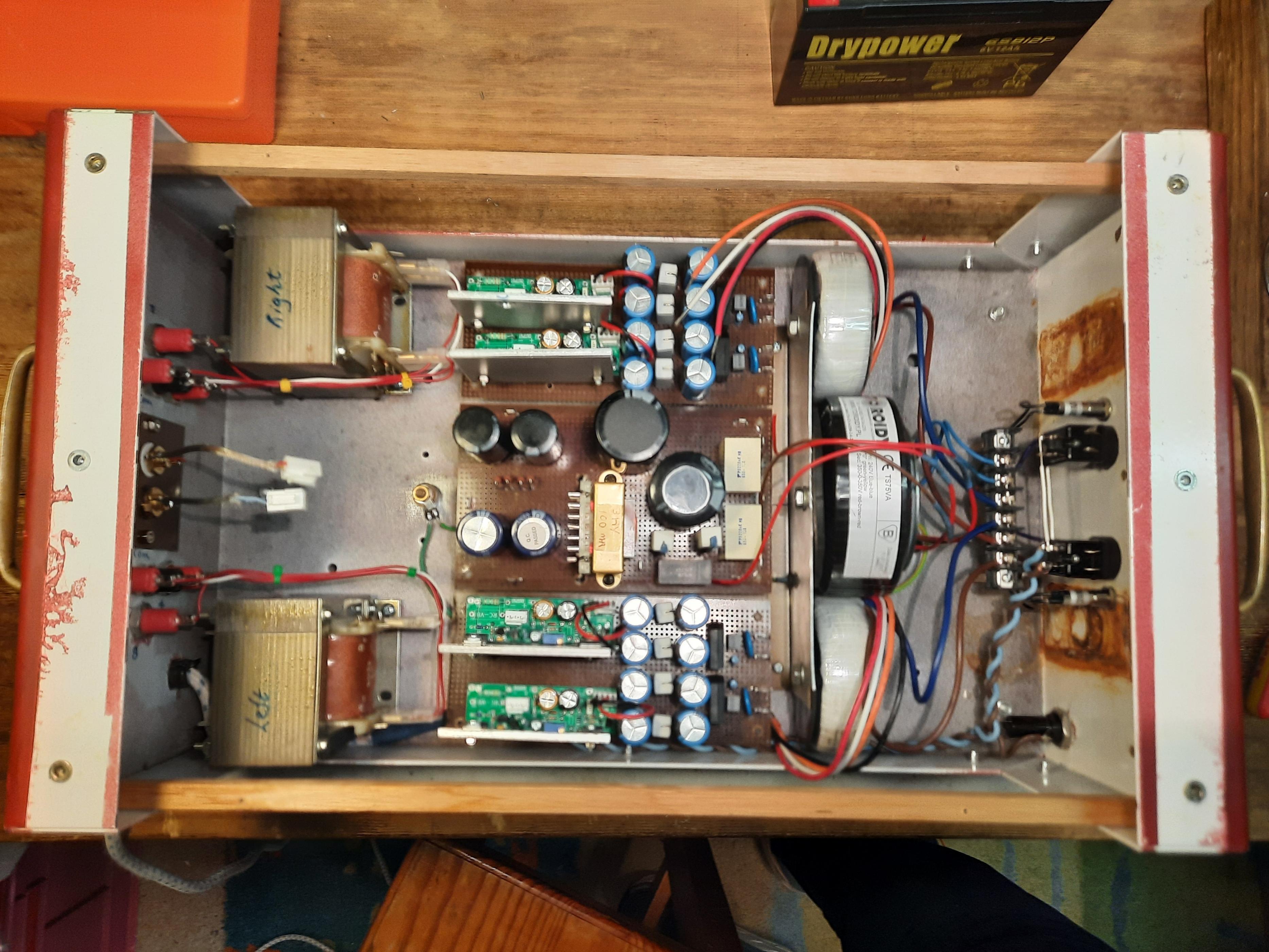

Transformer input (might yet change to RC 'cos I think the wee thing's having trouble with low frequencies) to the trioded LAs biased at -9V 20mA and 175V, transformer coupled with Softone RC-20s to the type 52s each drawing 35mA at 100V Vak. OPTs by AE Europe, regs from Rod Coleman, HT is CRCRCLCRC in which the L is a common mode choke courtesy of Dave Slagle.
Playing now into 10" drivers. A fun Covid19 lock-down project 🙂

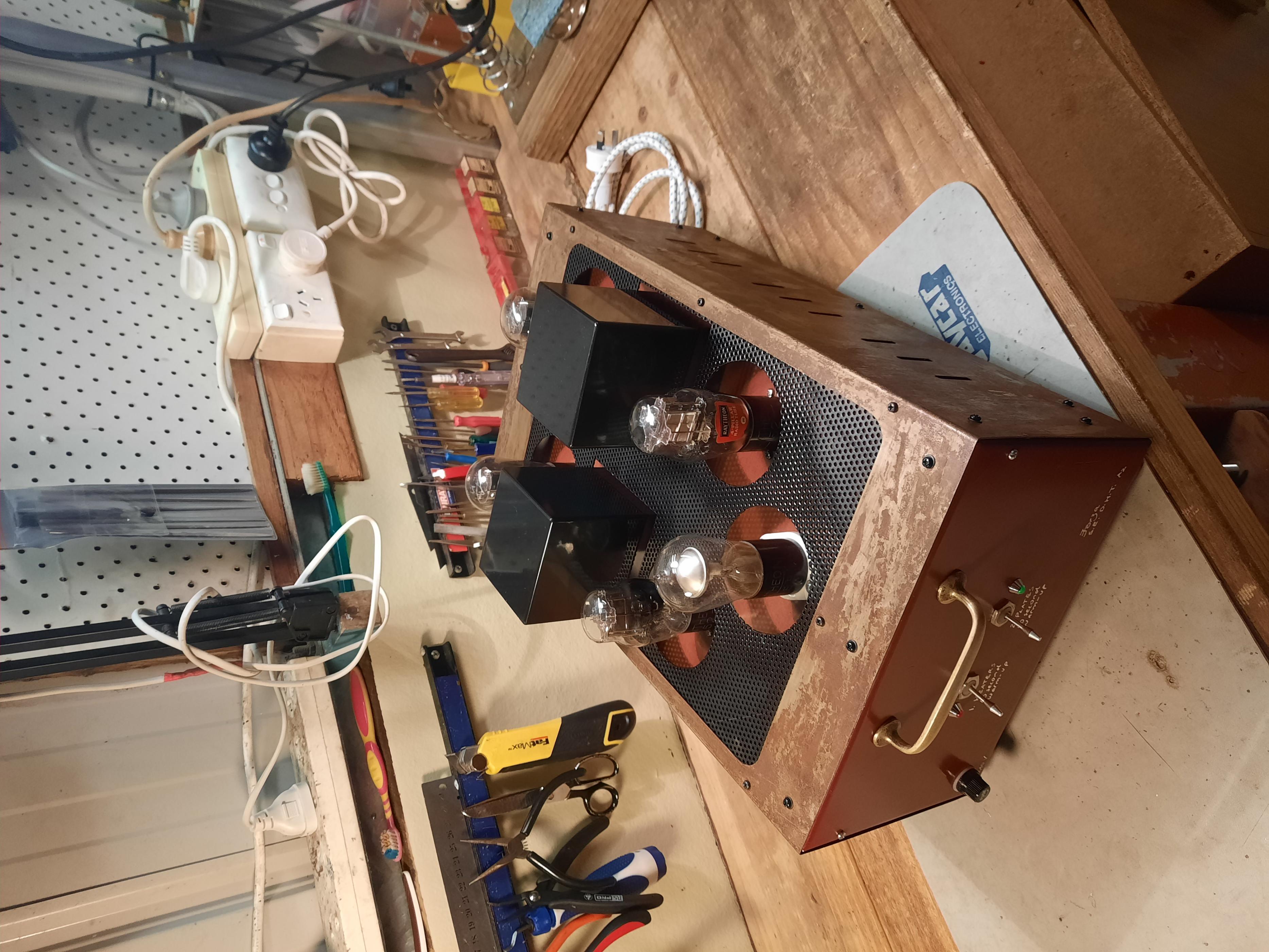

How does it sound? Well, very very little hum at the speakers - sensible layout and Rod Coleman's regs make sure of that. Some very very low level valve "flicker" or "fluff" - a hint of microphony to come perhaps?
Nice mid-range and highs - doesn't sound softened or rolled off. Playing John Adams' "I was looking at the ceiling and then I saw the sky" delivers excellent instruments and voices. All the low level stuff is there - even gentle bass. Bass. Aha - microphony starts fuzzying things up and yep, it's the globe LAs. And maybe the input transformer too.
I'll listen for a few more days (or maybe weeks - it's quite nice in my small workroom) and then will probably put it on the bench to measure it. I'm expecting 1Watt for 2% THD. I'm expecting highs out to 25kHz and bass to start wobbling from 80Hz down. I will be pleased if all that pans out. 🙂

I'd be interested in the schematic? I was wondering what the considerations are when selecting an interstage transformer. I have a few tubes that have curves for positive grid voltages, and I have heard of people getting good results with old Philips transformers from radios with 800ohm speakers.
Nice, I like that you located the power transformer to the front of the chassis, most people put it in the rear which puts it close to the input jacks and OPT's. Makes sense if you have room in the front for it.
