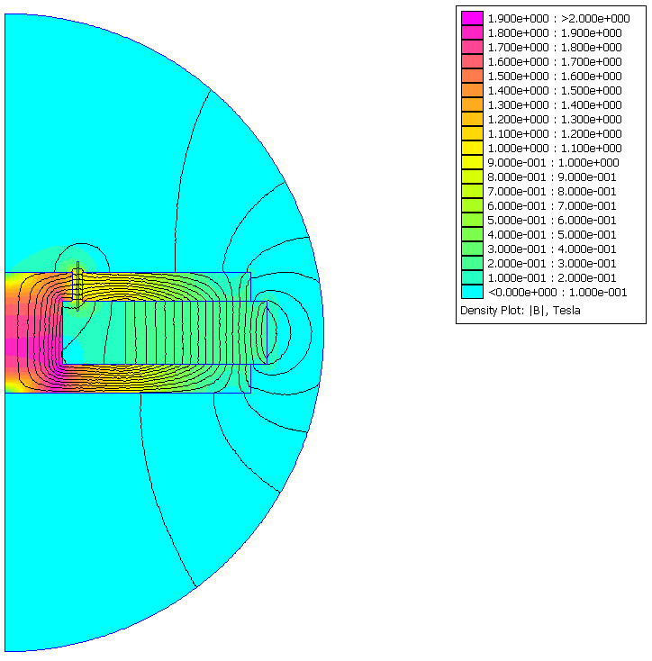

While shopping for a massive sized Neo Axial polarity ring magnets for a project, trying to get some outstanding Qes values, I'm finding some 200mm diameter, 12mm thick, with a 52mm inner diameter dimensions...but upon pricing such a large magnet, $200+ for each one!!! I thought I could stack a half dozen, $1200 USD worth of magnetic force! Then I remembered those few particular drivers that "showed off" their trick magnet assemblies...it was the utterly cheap tiny pill sized magnets...those ones that sell for some four dollars a pop...they cutely arranged them in a radial pattern.

Qes may be soft-limited by pole piece saturation. Even cheap speakers work the iron near the knee to reduce variation among magnets.
OK, with unlimited magnet money you can run a longer voice coil, more conductor in the gap. But that also raises mass, which raises Q.

Now, regarding speaker motors, FEMM will reduce your guesswork to a large margin and will show you quite exactly what´s going on in your motor, where advantages and disadvantages are and when your metal parts are saturated. You will most possibly find the reason for using the small pills - price - and you may find out that axial rings do not need to be that large, if you´re not building an enormous woofer. Depending on airgap, core and poleplate geometry and material, there´s a point after which larger magnets are not resulting in more flux anymore, and with some work, you´ll find the optimum "balance" for your design.

I am just curious what is the sense of a field coil, when the pole piece is saturated at a certain magnetic field strength, so the flux density in the gap is limited by the iron properties. If you increase the field strength, the flux density does not increase beyond a certain value.
I'll be downloading that FEMM program on the other machine shortly...I have a collection of drawings, trying to get an intuitive grasp on the lines of force...one thing i had noticed was the propensity to model out with conventional shapes...It would seem, given a fixed variable, the size & dimensions of an available magnet, I believe shapes of backing plated & pole pieces would be a great place for some insights & discoveries.

It may also be fun to model the current sheet of the vc to see how the drive affects the model, through all vc positions.
Adding velocity, well that I think is wishful thinking, but something to ponder. The gap edges are quite important.
