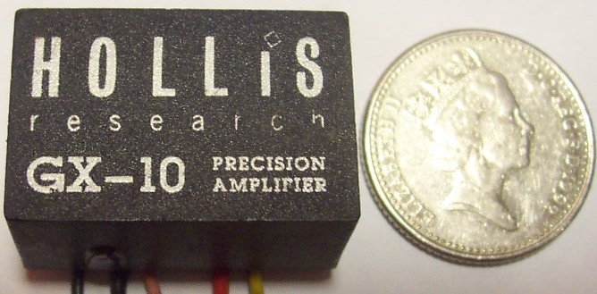

I have an un-usual guitar pre-amp,given to me by someone years ago.I have no documentation for it and am afraid to connect it up in case I smoke it.I think it was once inside a strat copy.
There are NO references to it on the net that I can find,and from what I remember it was given to me long before internet became popular.
Does anybody recognise it?

I e-mailed Trevor at the above site and he kindly sent me a scan of the original documentation.For anyone who has one of these Hollis GX-10 pre-amps;
Red-Batt plus
Thick black-batt minus
Thin black-earth
Pink-input(from wire that normally goes to jack socket)
Yellow-output(goes to jack socket)
