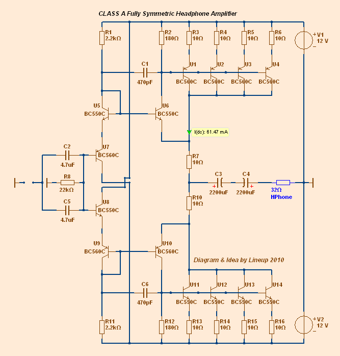

Symmetry is beautiful!
This is perhaps the most symmetrical amplifier I have ever made.
It is so symmetrical I have sometimes hard to see what side it is.
It should be regarded hifi, as THD is low.
It is Class A, max output more than 100 mA
It is Buffer. No gain.
No feedback. Pure follower.
Can be used for any line level hifi buffering.
This version shown is for 32 Ohm Headphone.
This version uses Output Caps.
There is a version 2 where you remove output caps and add a trimpot.
Nice feature is you need only common component:
7 x BC550C
7 x BC560C
+12V 3-pin regulator
-12V 3-pin regulator
a few resistors + a few caps + small trafo 2x12VAC
Those caps C1, C6, 470p makes the amplifier roll off nicely at 20 MHz.
Into 32 Ohm it put out well above 100 mW RMS
Enjoy 🙂
