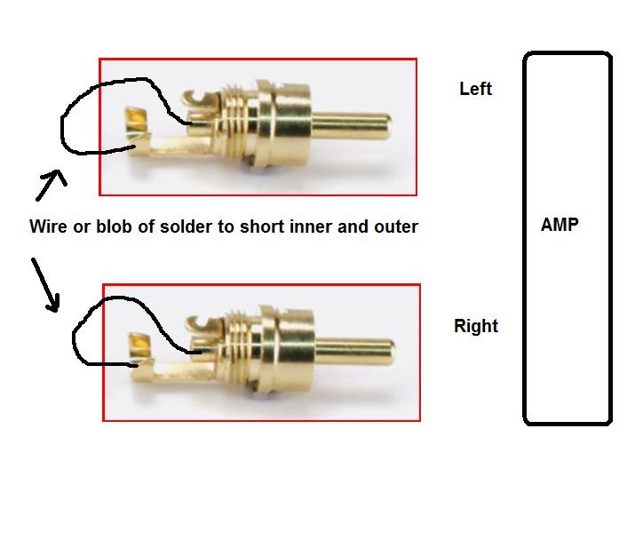

Short both the RCA inputs with a dummy zero ohm load.
A pair of phono plugs with the pole (hot) soldered to the Ground (earth/barrel) will do just fine.

With the inputs shorted (signal to ground) at the input terminals is there any buzz ? You must use the correct ground, for example by using phono plugs with center and outer shorted.
Apart from speakers nothing else must be connected.
Is the mains lead grounded (3 core lead) ? If so it should be connected as intended.
The amp should be silent.
If it is silent keep everything as it is and add a shorting link between the left and right grounds of the input sockets (just hold a short piece of wire to link them) ... does the buzz return ?

Hi Andy I can make up a phono plug with just the outer barrels soldered is that what you and Mooly mean ? Then you want me to connect both RCA Neg - imputs together and test it.. that correct ? I'll rewire the mains plug just in case and let you know the results
Yes, you are just shorting the inner and outer of the phono plug so it applies a dead short across the input sockets.
I then went on to suggest linking those shorted plugs together because that can show up an internal "ground layout" error if it then did by chance buzz when that was done.
Hope Im getting this right , I made the phono lead up, the wire touching the cup at one end and the wire inside the rod at the other :
And then attached them to the imput jacks as requested
The speakers still buzzed .. I rewired the plug as well still no change 🙁

Don't use expensive phono/RCA plugs for dummy loads.
Any cheap plastic RCA will do. Even the sealed version from cheap cables. Cut the cable short. Strip a bit of insulation off. Short the core to the screen.

I do have some rip -off cambridge Audio ones I can use, I make my own phono leads now after dismantling a so called high quilty one, and realised just what a rip off they are anyway I have plenty of spare plugs because I have been testing them. Good thing about having a business account with CPC , they send samples 🙂
Ok I made the jacks as per Mooly's picture, I tested them on the inputs , nothing changed, when I plugged them into the 200 mV’s but when I did the same on 640 mV plugs the buzzing reduced dramatically, it was still there but I had to get my ear up close to the speaker, I did the same test after to swapping over the speaker and exactly the same result. Hope this helps you guys to figure this out 🙂
