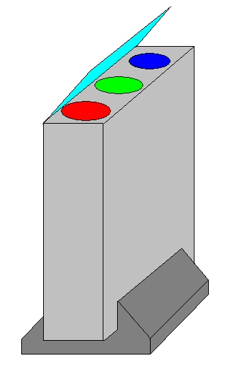

Hey,
I want to use mirrors on my CRT projector,I want to make the CRT stand upright and use a mirror to reflect image to screen.I cant use the CRT in a flat position because its so big so thats why I want to use mirrors..I STRONGLY suggest doing LOTS of research before getting a CRT...lol most importantly you must have a LOT of room for one..I learned this the hard way ..
any ideas of how I can use a mirror or any way I have use this in a small room are appreciated 🙂 any ideas at all.

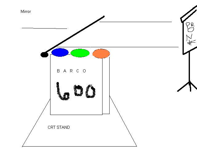

negative has the right idea but wrong position. If you were to do it his way you wouldnt have a clear projection on your screen. the colors/image(s) wouldnt line up right. you would basically have the same image trippled in different colors on your screen.
what you want to do is place the mirror length wise to the pj as the pic i made shows. you will still have to adjust the convergence but it will be less than the way negative is showing.
you can try both and see what works best but im sure the image i posted will give you the best results.
remember that you will have to use a first surface mirror. not a regualr mirror as it will give you the ghosting effect.
The last crt projection tv I took apart worked the same way as in ap0the0sis's picture. It had around a four foot square mirror inside. You should be able to get away with a smaller mirror, but it might take some work.
I have the right idea just a bad picture...lol your pic BLEW mine away...lol may I ask what program did you use?

your painting skills are obviously better than mine..Im just a noobie painter 🙁 lol

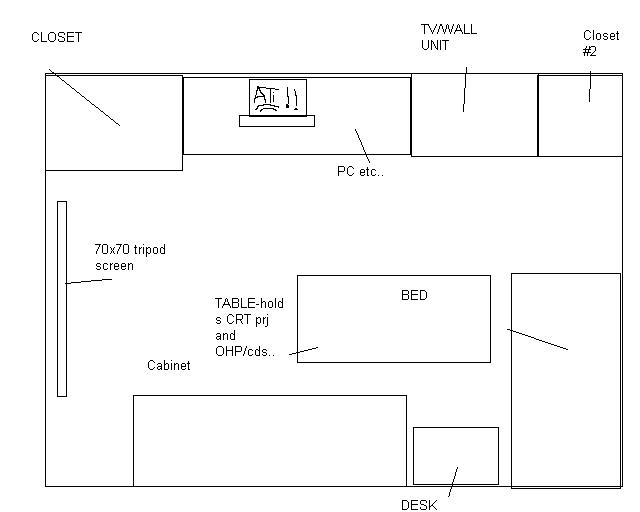

Thanks guys for all the help...but I discovered I had enough room to project it the normal way..thanks! 🙂
