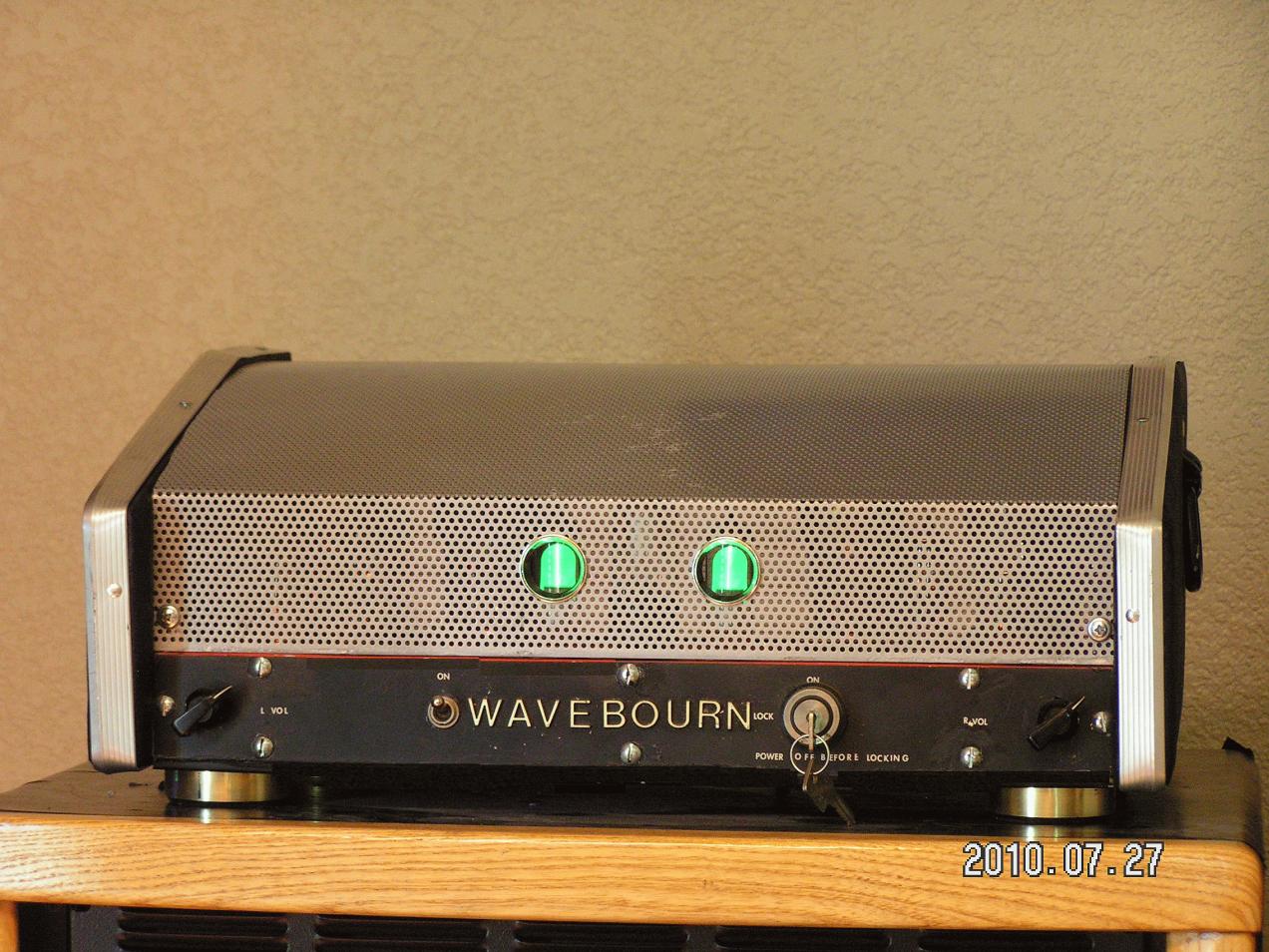

My favorite component is my Wavebourn Pyramid VII, Prototype 1, built to my specs and as far as I know, the only one in existence. I originally bought the Pyramid V, also a prototype that was damaged during shipping (as seen below). I always wanted to try a tube amp but I've got some terribly inefficient Magnepans and the tube power needed to drive them was just too cost prohibitive. After searching for months I rolled the dice on the Wavebourn and it's been the best stereo purchase I ever made. The designer, a Russian dude from Cali, was basically going to lose his home unless he raised some quick cash...so I got this amp for less than the cost of the power supplies. The V was originally designed to be used in a PA system and as a guitar amp. After seeing it on Audiogon I researched Anatoily, the designer, and what little I could find out about him he seemed very well respected among his peers. When the V showed up the power supplies were literally ripped from the chassis so, to make a long story short, it took six months but he tweaked the circuitry and I ended up with the Pyramid VII. I've had Acurus, Rotel and some other lesser SS amps in this system and the Wavebourn is by far the best sounding. Very, as they say, musical...and not fatiguing at all. The truth is that I bought this amp because I liked the way it looked. I love it for how it sounds and I'll never part with it because of the history I have with it and the uniqueness/cool factor. At 80W X 2 it drives the Maggies but not quite as loudly as I like when cranking NIN, Rob Zombie, etc. For classical, jazz and blues though...
The damaged Pyramid V as I received it...
That looks sadly familiar.... At least it still works.. 😀
Yep. In a fresh reincarnation, slightly modified schematically & a new top cover.
It recently worked on a "Hidden in Plain Sight" scientific conference, in the concrete hall with no sound absorption, dome shaped ceiling, a concert hall for symphony orchestra and 400 listeners that was never meant for microphones. People who understand said it was a magic...
