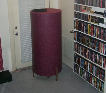

You're assuming a sealed design, or lack of multiple drivers. My large ported sonosub is strong and flat to 10hz, and it is amp limited at 600 watts, which equates to a max anechoic output ~115db, and is by no means a lot of power. It is most efficient in the low teens, and will deliver useful output in this region with very little power.3. To make some good SPL at lower than 15 Hz, you need transformer station with current od xxx Amper.

SteveCallas said:simon5 already corrected a few, I'll touch on one more.
10 Hz, 115 dB, 600 W. How you know this?
For 600 W is OK, but other two, how you come to this?
Give mi some data. Bass driver unit, and enclosure, and I can give some comment.
This?
http://www.quux.net/roo/diy/sonosub/
http://www.quux.net/roo/diy/sonosub/design2.html
http://www.quux.net/roo/diy/sonosub/design4.html
