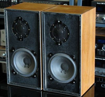

B&O used to do this sort of thing with (easier, IMO, if you can put up with the low impedance) 4 ohm drivers:
The crossover was something like this:
http://www.diyaudio.com/forums/multi-way/147632-classic-monitor-designs-12.html#post2883926
They used a (big) tweeter that could do about 2kHz too.
I liked the tiny Beovox 2702 back in the student day.

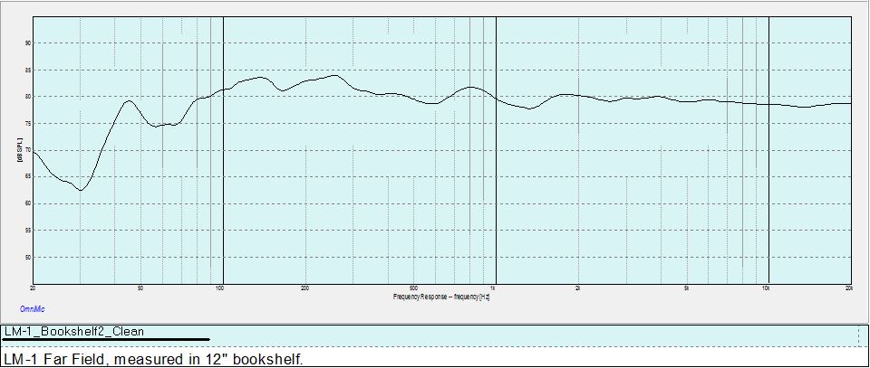

I'm adding the XSim files for the MTM version, the LM-1C. The data is rougher because the woofer measurements are far field, without the usual near field splicing that makes it beautiful. I kept meaning to update this, but it's never going to happen. 🙂
I can finally see where all of the arguments and heat about this design are coming from, I should have seen this sooner and replied. I apologize for not being more awake and seeing this discrepancy sooner.
I've made a mistake in not fully explaining the LM-1 Bookshelf speakers are actually meant for bookshelves and that has caused a lot of head scratching.
The XSim simulations have been completely accurate to this use, though it still remains to be proven if the actual sensitivity is correct. The measured sensitivity of the finished design is probably closer to 85 dB due to variations in simulated vs. actual but I lack an environment to retest for a while. Still, being in a bookshelf changed everything, so the usual arguments about BSC and it's losses no longer apply either. Win-win say I.
You may not like this approach, but like Alison, I modified my measurements and design practices according to where I intended to put the speakers. You may also think that I still should have sacrificed some efficiency for bass extension. Happy to see others take on that simulation with that in mind to show how this is done. Also happy to use this as a compare-and-contrast project to show different goals require different approaches and yield different benefits.

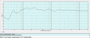

I'm enclosing an updated XSim file with the port contributions blended into the woofer FRD file.
I'm adding the actual measured response, but I guarantee the level was off. 🙂
I get sloppy when doing full system measurements, as opposed to driver measurements, sorry.
You will also notice significant ripple between the woofer and port. This did not show up in enclosure simulations, but it's real. I think the actual port ended up tuned a little too low for some reason. The latest XSim file I uploaded was made to match.
attachment.php

Last post for a while, here is the XSim (blue) vs. actual (green) measurements on a single chart. Levels offset for clarity and not absolutely correct.
XSim simulation uses gated far-field for the woofer down to about 600 Hz. Below that close miked woofer and port, blended based on far-field measurements. The dip you see around 500Hz in the simulated (blue) trace is not an artifact of bad splicing. 🙂 It's real. When you measure the woofer alone in close or far-field it re-appears, and makes a very convenient splice point.
The green trace is measured, far-field, I don't rmember the resolution, but the chart I posted above was smoothed to 1/6th octave. This is proably 1/12 or 1/24th octave.
