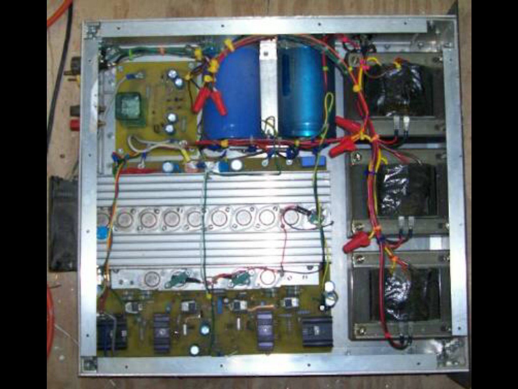

About 1200 at 4 ohm, +/-127 volt rails. Newer generation are all switched rail. This was the last of the class AB with more than 80 V rails. There were three. Two mono blocks and a 2 channel version that made 600 per at 8, and 900 per at 4.
When I first tested these I was only getting 960 watts at 4 ohm out of the monoblocks. Then I found the AC mains dipping to 106V. They will get the plugs hotter than the blazes of hell and damnation at war volume.

Is that for a pa system, or home stereo?… all I picture in my head is back to the future speaker blowing up!
